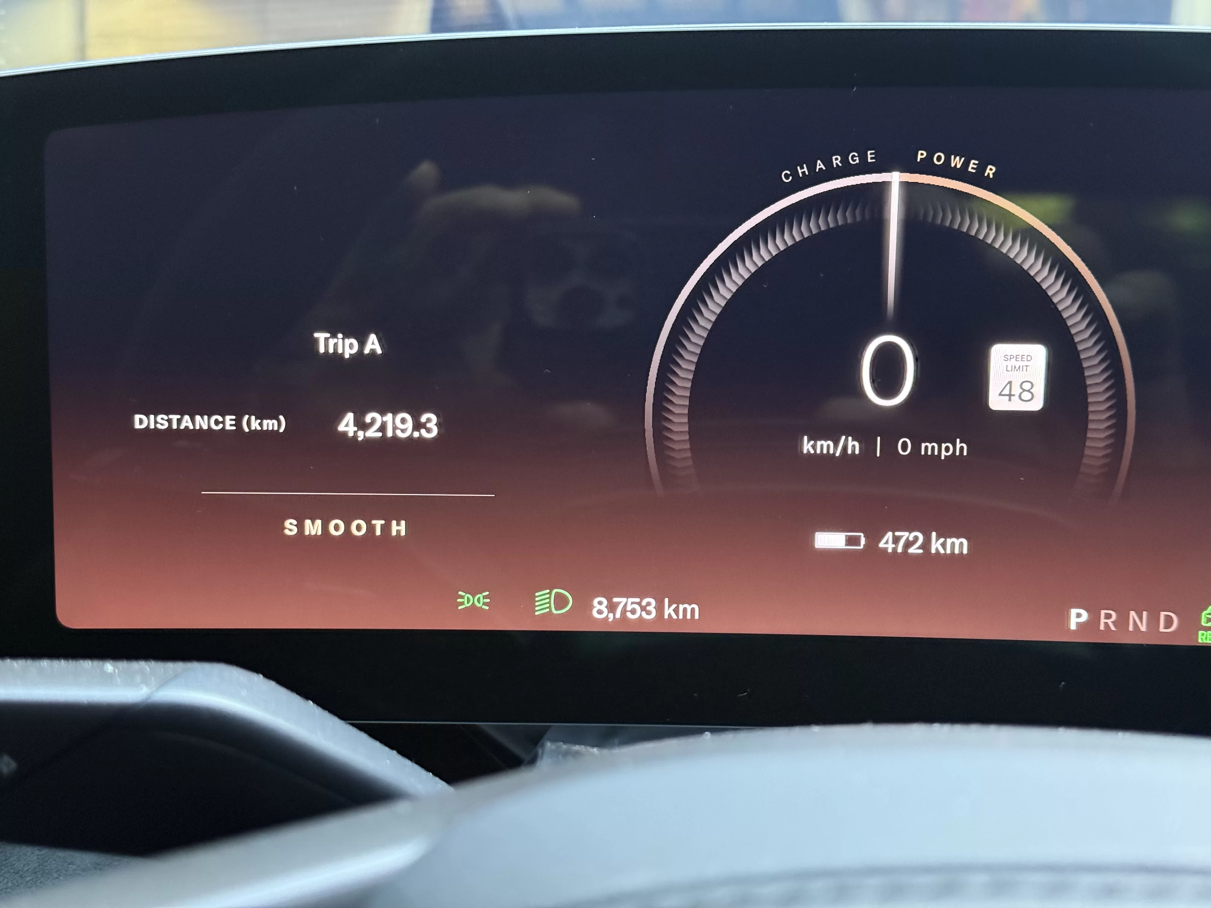

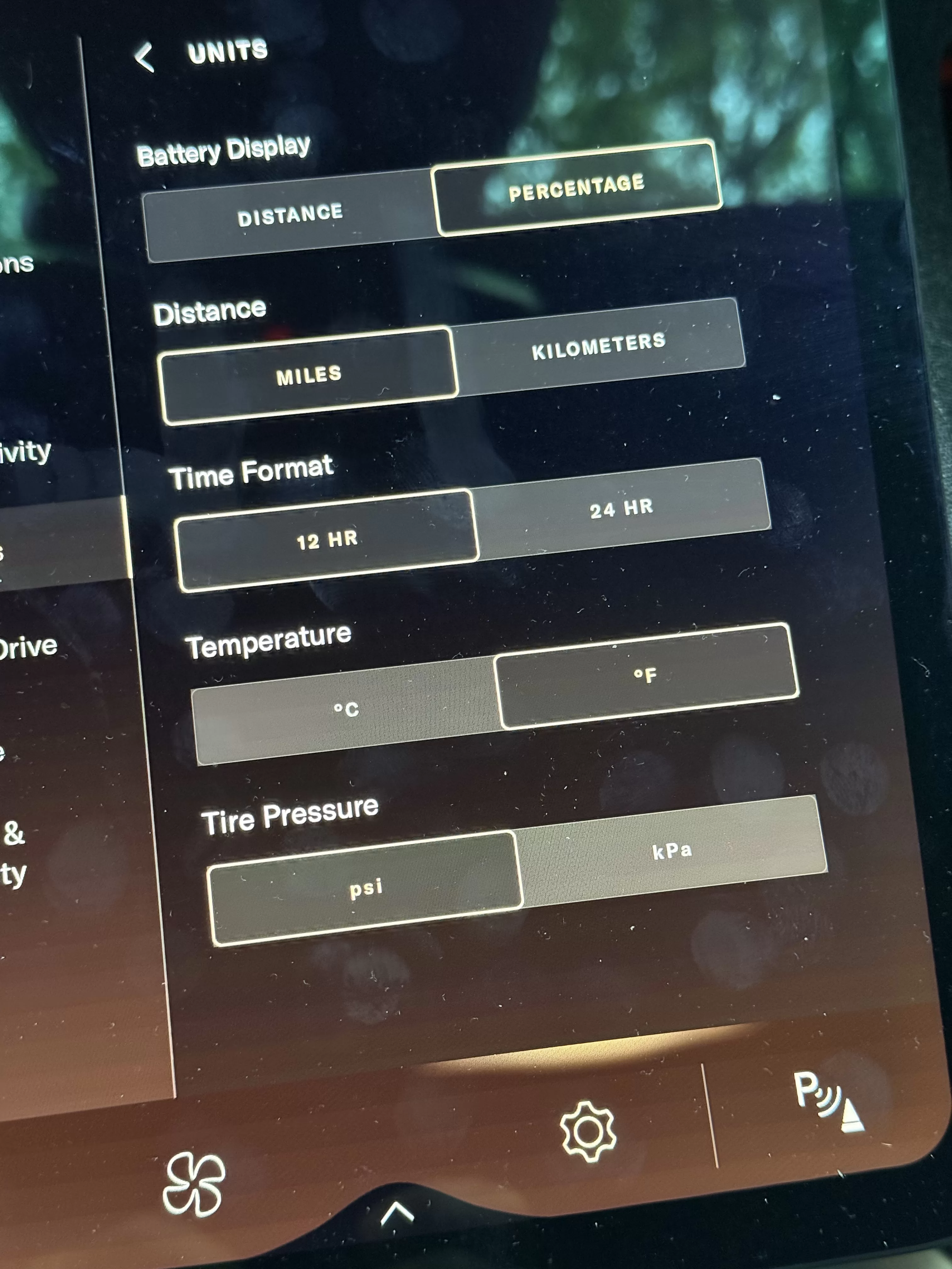

Every morning my car makes believe it’s an American in Europe. Speedometer is is in km/hr, distance in kn instead of miles. AND sometimes the settings on pilot panel are changed to what the dashboard reads and other times are decoupled.
Further when I see the wrong settings I go to pilot panel and go to gear wheel for settings and touch display, see the inconsistency between it’s read out and the dash actual display. Then in left column touch ‘about’ exiting settings ‘display’ to settings ‘ about’ and then return to settings ‘display’ and without ever touching any of its choices, find that it has changed. And the two panels are both consistent.
Why an American in Europe. Distance in km, speed in km/h, tire in kPa, but Temp in F. Ie when in Europe you want to match your dash to the signs you see but when you open your car door to know what temp to expect most Americans think in degrees F
Is this Lucid’s artificial intelligence?
I am not using the app while I sleep!
Today’s inconsistencies in two images.
