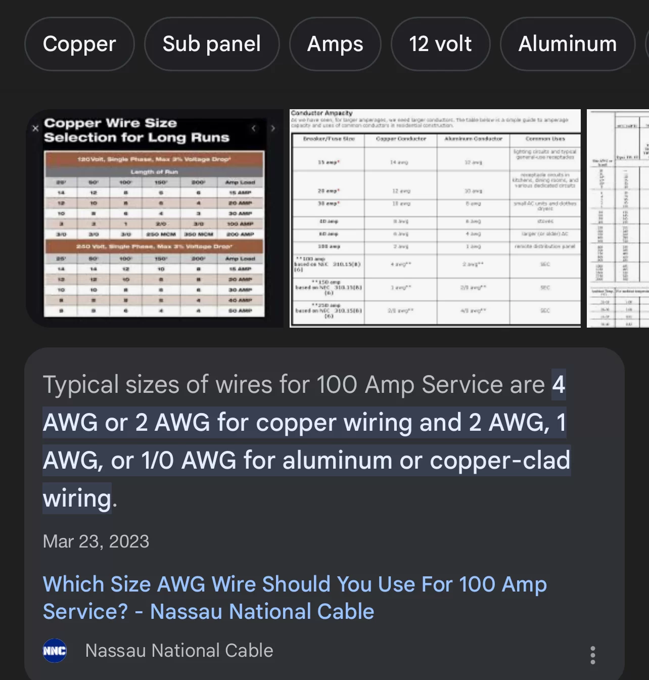

...Current AL wire is 4AWG rated at 75A. I reminded the company that LHCS requires 2AWG, they will install this instead of the 4AWG copper in the estimate. Looks like they plan to install a 70A subpanel, and at 80% continuous load, that should provide ~ 56A to the LHCS, and I've have them adjust the dip settings accordingly....

Overall, great company, and their approach is very sensible/pragmatic. the subpanel is installed right above the charger to minimize length of copper wire run from subpanel to LCHS. [1st company wanted to rip out and replace 100ft of wire for $7-$10K, depending on replacement conductor type, AL vs Cu]
the setup right now is with a 60A subpanel breaker, and the dip switch was adjusted to 60A. His plan is to install a 70A subpanel CB but he did not have one today, it'll arrive on Monday, the 60A CB is a placeholder. The main panel still has a 100A CB, and he'll replace that with a 70A CB as well on Monday.
The final setup will be: 70A CB at main panel --> Aluminum 4AWG rated at 75A running from main panel to subpanel in garage (home already had this pre-installed) --> 70A subpanel with 2AWG copper wire running from subpanel to LHCS, and then the dipswitch will be set to the 70A circuit breaker size setting.
