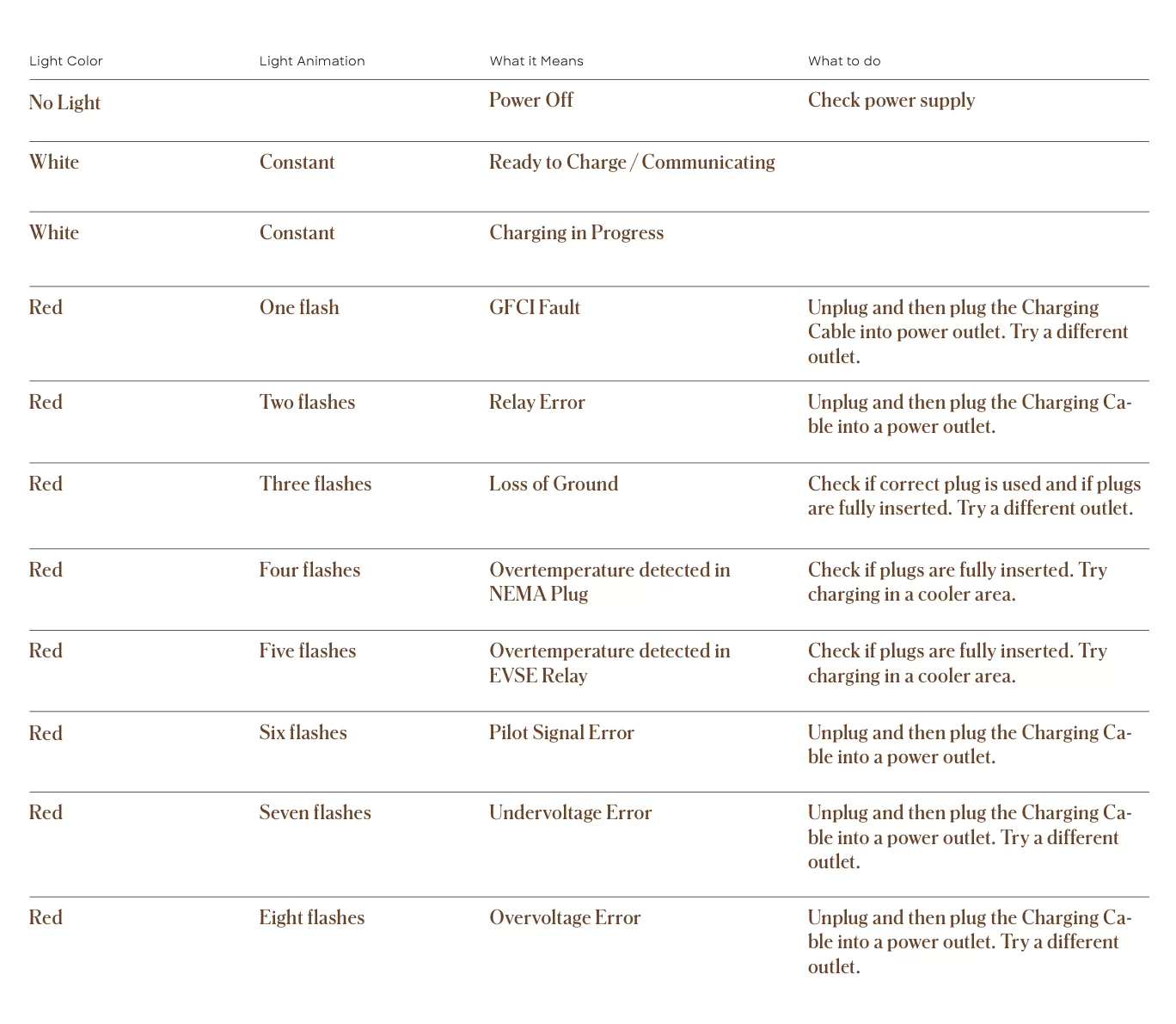

I have my Lucid GT for almost 2 weeks. I received it with 2.0 software already installed. There was another OTA (2.0.X) about a week later, which I downloaded and installed. However, I continue to experience "Charging Error". The error is NOT limited to just delayed charging. I have to physically unlug and replug the charging cable.
I have a JuniceBox and also a separate NEMA 14-50 receptacle in my garage. I tried charging through the JuiceBox and using the the Lucid cable directly to the NEMA 14-50. Sometimes it works but often it doesn't (i.e., I get the "Charging Error" and it won't clear even if I unplug and replug in the cable).
Is anyone else experiencing the same problem?
