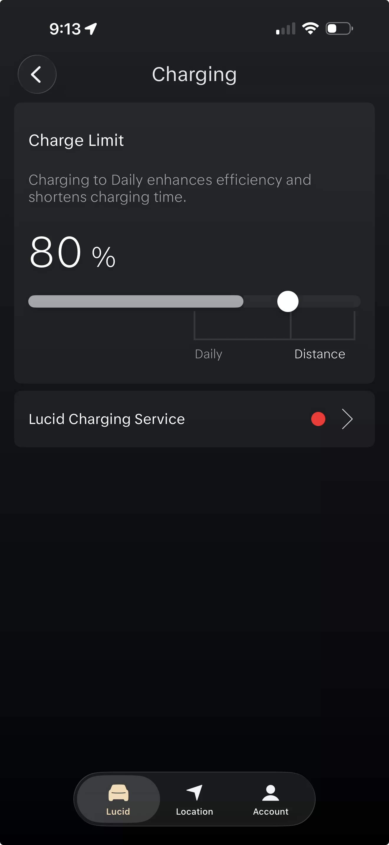

I dont see an option to schedule or limit charge speed in my app. Is this same for all or i am missing something?
Interesting. My screen for this has not changed as far as I can recall in the last 4 months that I have had my Gravity.
There are several items that are not in your app that are on mine; maybe they were never there? Maybe other Air members could confirm that.
Here is what I see between the "charge limit" and "Lucid charge service" on my Gravity iphone app:

I just noticed on the updated app from the app store I now include charging settings and scheduling services...Make sure you have the most updated app...
I am on latest version. This may be option for Gravity only for now. May be another Air owner can confirm they see same as me 🙂

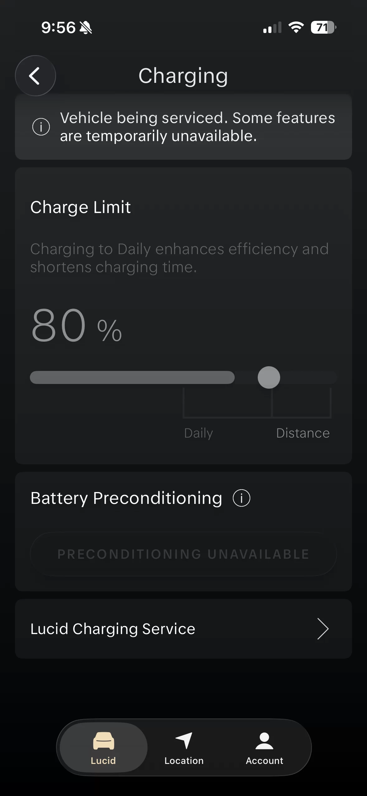

My Air charging screen (it’s in service, so disabled) but the rest is normal
