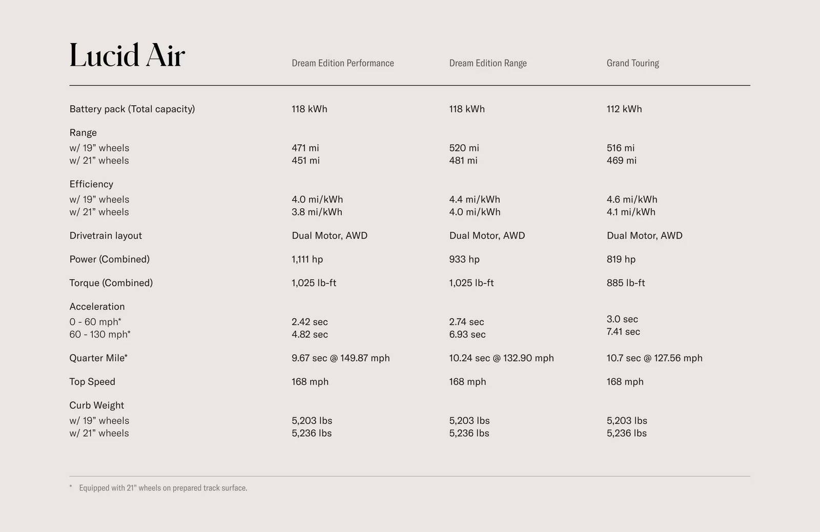

I found this very interesting -- the power outputs of the Dream P, Dream R, and GT motors:
I'm thinking back to what Zak Edson said late last year about the Dream Edition using a rear motor with special metallurgy that he said only bumped the horsepower up by 15 hp but yielded a greater increase in torque.
This chart shows only minor power differences in the rear motors across the three versions (with the rear motor of the Dream P actually putting out less power than the Dream R's rear motor) . . . but with a huge bump up in power for the Dream P's front motor.
I wonder what that's all about? Is there any "special metallurgy" still bumping about but now maybe playing a role in the front motor?
With the small differences in rear power it is hard to see why a special metallurgy to allow higher torque would be needed.

Engine power is expressed two ways, HP (kW) and torque (N-M or lbs-ft). You're questioning what's different about the torque between DE and GT. Here's the torque rating for the 3 trims:
Both DE: 1,390 N-M or 1,025 lb-ft
GT: 1,200 N-M or 885 lb-ft
So there is a significant difference in torque. According to the motortrend article, this is peak torque accessible only in sprint mode. Jonny listed the torque for each driving mode for the R and P.
There have been so many engineering changes in the power- and drivetrains over the past year that I wonder if anything I heard a year ago has any bearing today. Rawlinson did say in one interview that he liked to talk only about horsepower, as torque was not really a relevant metric for EVs -- a point I did not understand.
Another thing I don't understand is why the Dream P would have lower power output at the rear than the Dream R, since rearward weight transfer under acceleration would seem to call for more power from the rear to get faster acceleration numbers.
And are the front motors the same across the three models? Does it make sense that the same motor that produces 370 kW in one version would be set up to produce only 178 kW in another?
