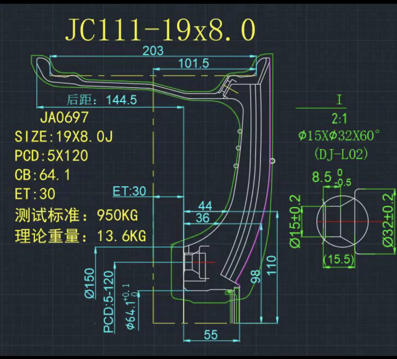

I’m looking for bronze wheels that fit the factory tires. 19x8 is the size I need to get. Is the Offset and Bore flexible or does it have to be the same size to fit the factory tires?
These work perfectly I had them built. I have them on my car now for six months or longer.

You won’t be disappointed these are the text specs drawn up by the engineer at the wheel manufacturing plant sold me three sets of wheels now for different vehicles. Every one of them has been perfect.
