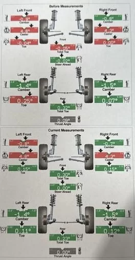

The thing to be careful about is that not all alignments are made the same. If they align it exactly straight it will not wear evenly. They can look up the settings and proper values for Lucid though.
My car before Lucid aligned it:
77793271565F535871676362634849317241734C387844376275766668364C6A686948476145772E6930492D61366...webp
And after:
4A69367859446D546A746B64736374773869535F35414C626649446A7555386F613948567A426B2E5342534E54384...webp

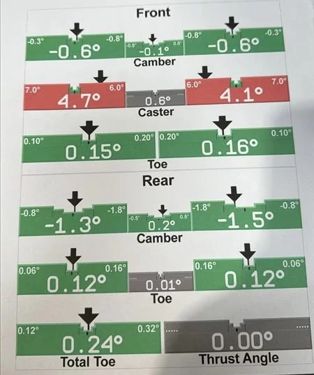

I had never seen a report like that before, til my new & (hopefully!) improved shop provided one today.
Is it that case that each make gets aligned a little differently? That is, will a Luckd service center have a better idea how to align a Lucid? Or is alignment kind of a generic process across all cars? Is there something unique about aligning a Lucid that a local shop might not understand or be good at doing?

You can pull up the alignment “map” in any of the alignment software tools for a specific vehicle. Lucid’s is in there, but of course Lucid is less likely to screw something up.
I don’t know the right terminology, so I hope that made sense.
Thanks yes it makes sense! And based on this report. the first shop DEF fouled up. They didn’t even give me a report, which I understand is now standard. So problem solved, and thanks again everyone for the input!
Just to be clear: they may not always hand you a report. But if you ask for it, they usually will. I’ve definitely had alignments done where I didn’t receive a report, so that’s not necessarily the sign of a bad shop.
