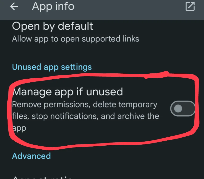

Another setting to check, just a bit below the battery usage is the one that lets Android periodically remove permissions. You'll likely want to turn this off.
