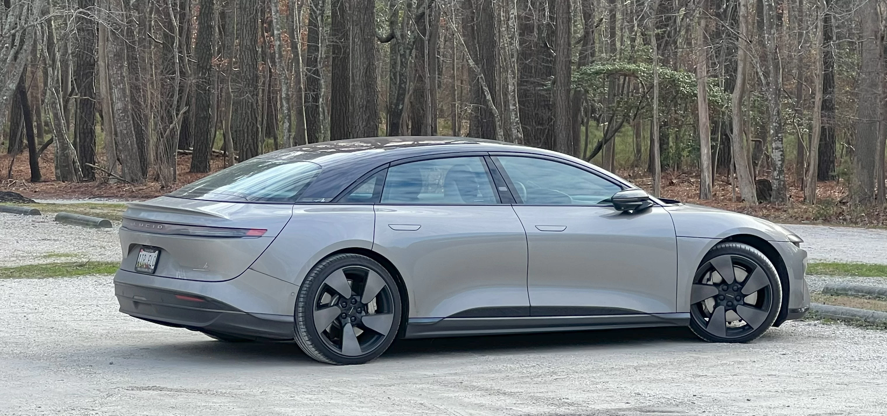

I had ordered my Touring Stealth with 20" rims and it was delivered with 21" setup in 06/2023 - I love the appearance, the handling, comfort and very little road noise. The many early reports about Pirelly 21" blow-outs certainly caused initial anxiety and I have been super-diligent about avoiding potholes etc.. Despite occassional travel on the crater-roads of D.C., Philly and Baltimore I have fortunately not had any tire damage in 10K miles. On longer drives up to 7 hrs I always found the ride comfortable.
Since June I have been (unsuccessfully) trying to get Lucid to swap my wheels to 20", since I live in the Northeast and would like to depend on the car as my daily. Without certified winter or all-year alternative tires, I've had to to drive my old car for the past two weeks in order to not damage the 21" tires in sub-45 degree temps.
IF all stars align, LUCID mobile service will swap the wheels this coming Monday, I will then have allround tires mounted for the remaining cold season and will report back w/ comparison.
I plan on keeping the 21" set because I like them. Dependent on the cost of a seasonal tire/wheel swap and how much of a PITA it is to recalibrate the TPMS every time, I will have to decide if it might just be easier to use the 20's w/ allround tires year around...View attachment 18254
Those Stealth 21's do look awesome! I bet the Stealth 20's without the aero inserts would look just as good. I'm hoping that the recent update will make the size swap easier for TPMS, but I'm worried that's still an extra headache as well.

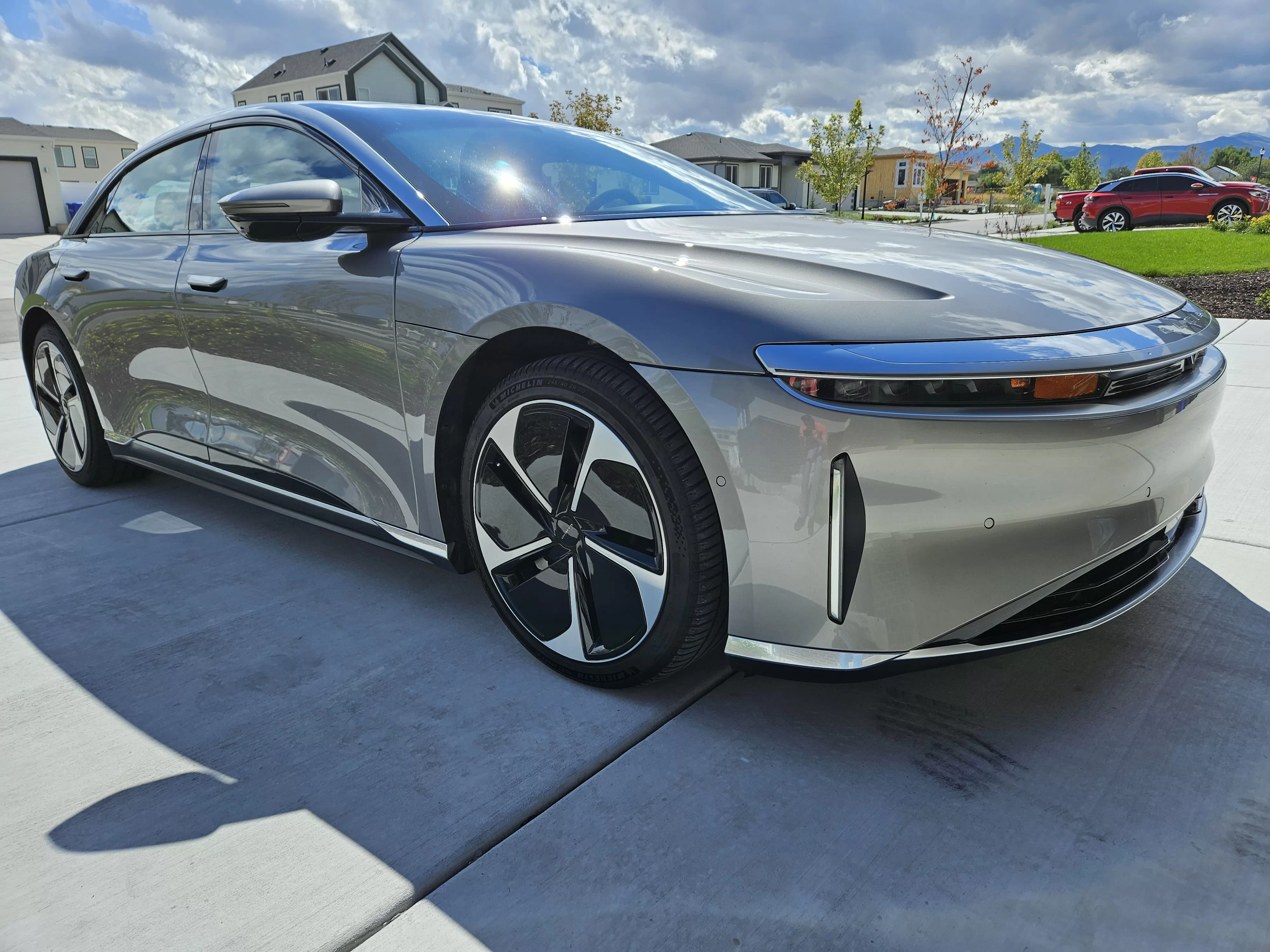

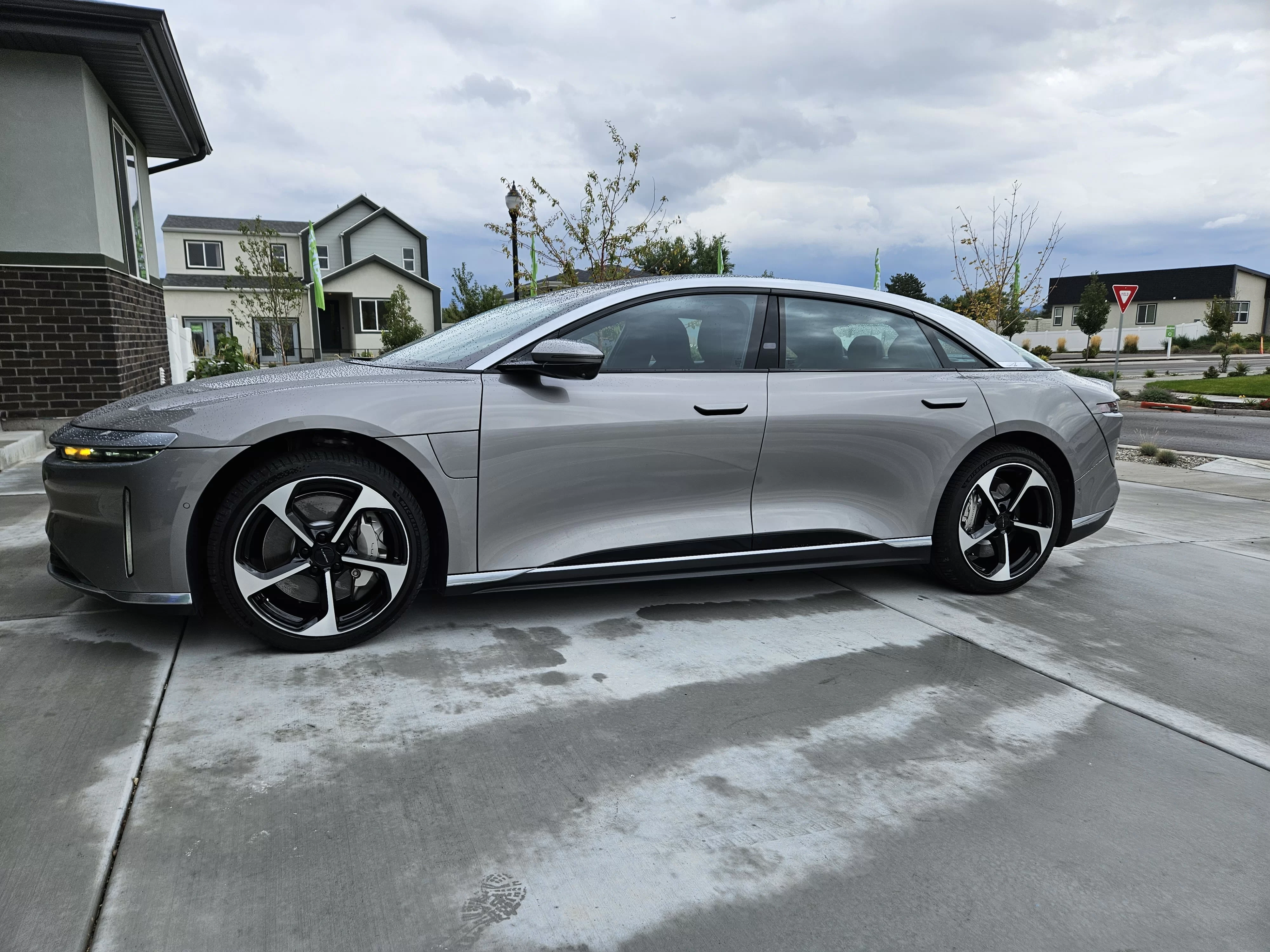

Does anyone have comparison pictures of 20" stealth rims with and without inserts, please?
Are there all-season tires available for the 20's now?
That was quick! Thank you - both options look great - beautiful car!!
You bet! I really like the look without the inserts, but obviously it's a bit tougher to keep looking nice and clean. If you do end up getting 20's just make sure you remove them immediately, or you'll end up with lots of unsightly scratches.
I had originally wanted to buy the 20s, remove the inserts and paint the calipers a mid-tone blue color. I don't think there's anyone close to me that paints calipers and when I researched it more and found out that it's a multi day process, I said 'screw it' and just leave the inserts in all the time.
