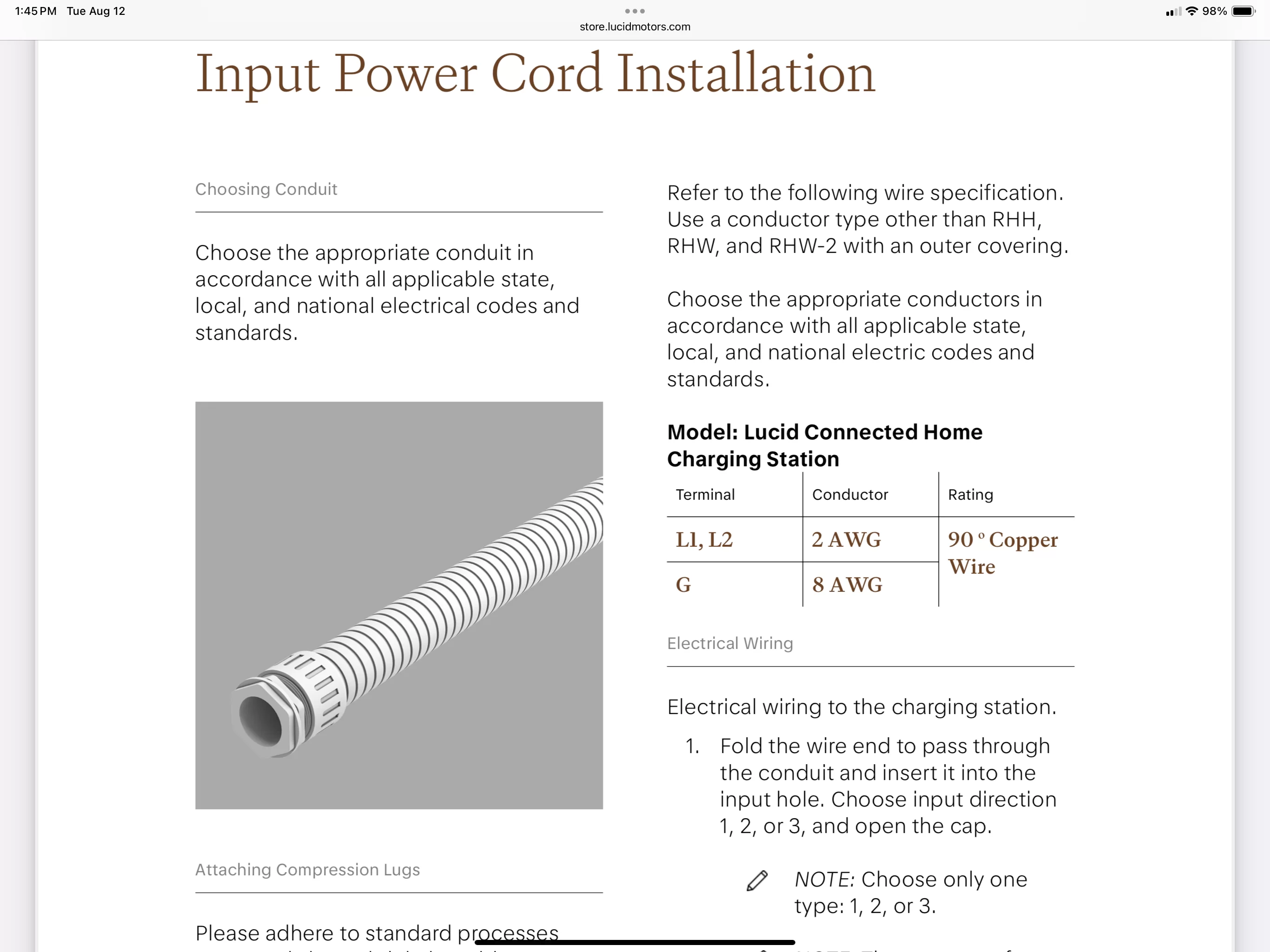

Here is what the Lucid Charger Installation guide says.

I believe "2" is the gauge of the wire (2 is heavier, with higher capacity than 3). The electrician who installed the charger at my new place went with smaller wire so I'm limited to 40a continuous. That was okay with my old car (94kWh battery), but my AGT takes a lot longer to charge, so I'm thinking about upgrading it. Kind of an unnecessary PITA but it is what it is.

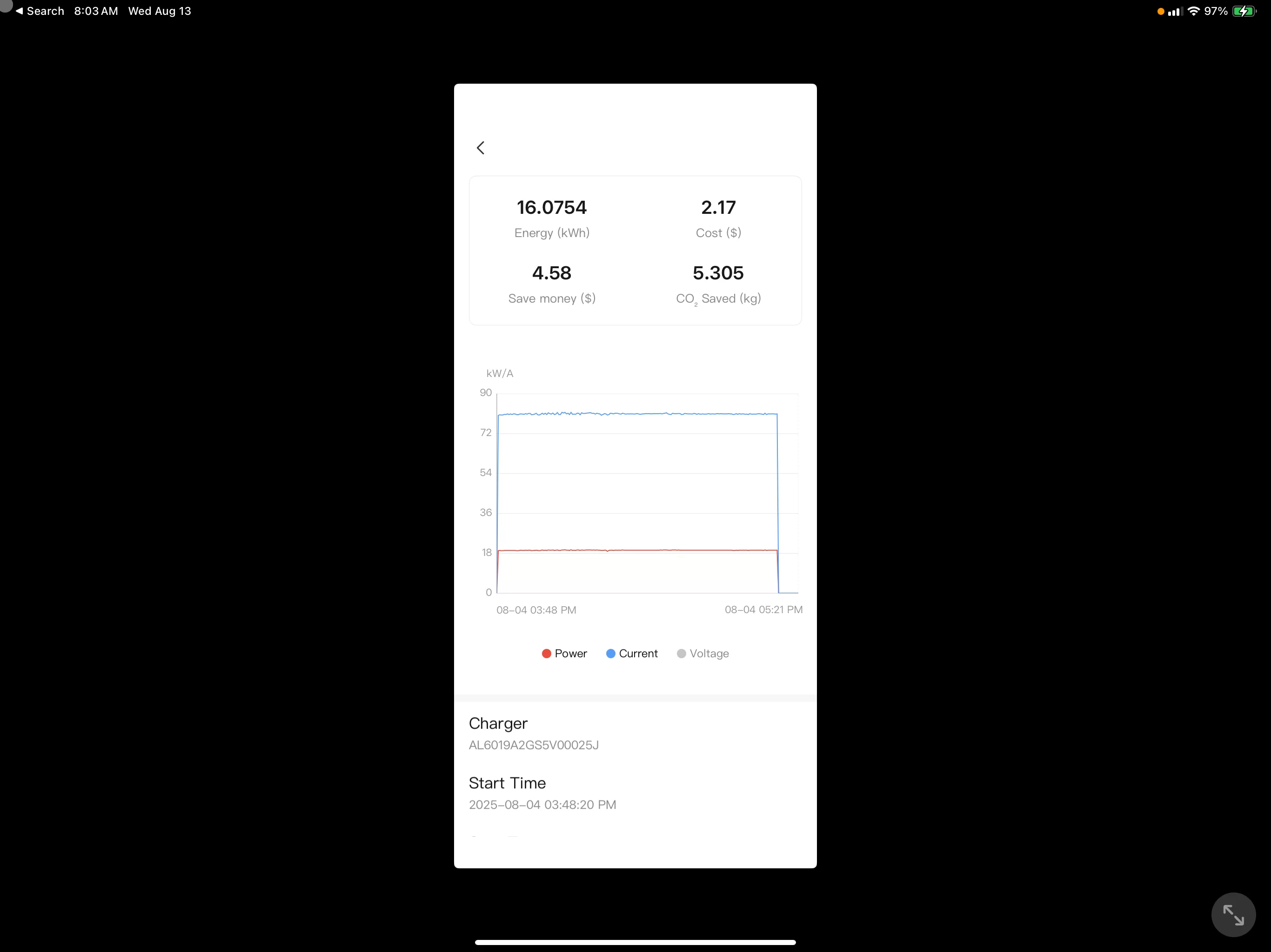

With 80 amp (100 amp breaker) I routinely get 75 to 80 mph of charge.

For those who say 80 amps is overkill - I would rather have the capability to charge multiple cars, charge when I want (off peak time) and get results faster. Lucid is one of a few cars that can accept 80 amps (19.2 kW), I think not being able to utilize that is a shame.
