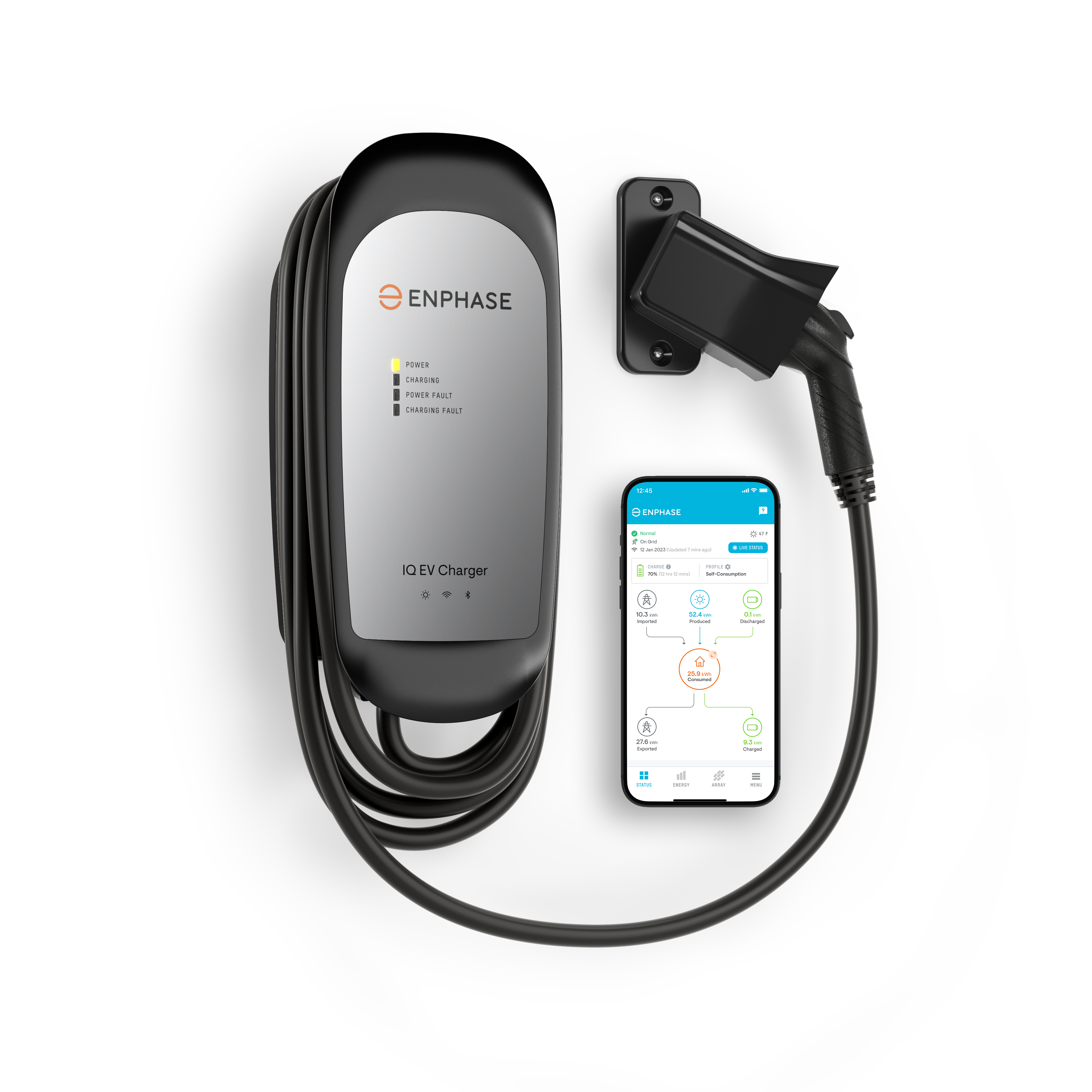

Enphase's IQ charger series will do this automatically. It's what I'll be installing next week for my wife's car. Enphase's cloud watches what your PV system is producing, how much power your home is using, and charges the car with the difference. One limitation is that the charger's output is modulated in increments of 25% of the charger's maximum output, oddly. So if you have a smaller PV system you'd want to use a smaller charger. Unfortunately for a 3kW PV setup, you'd want to use a 3kW maximum charging station, not practical.
I will keep the Lucid charger I have on a 60-amp circuit for faster charging as needed.
