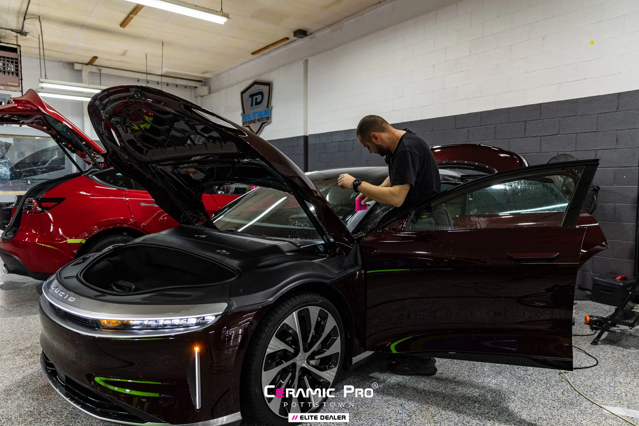

@Babyrocko1908 brought us her Zenith Red Lucid Air for Full Body Paint Protection Film, Ceramic Pro Ceramic Coatings & Ceramic Pro KAVACA Ultimate IR Window Film.
This work log post shows some of the work we are doing with her vehicle while its here at Ceramic Pro Pottstown Elite Dealer.

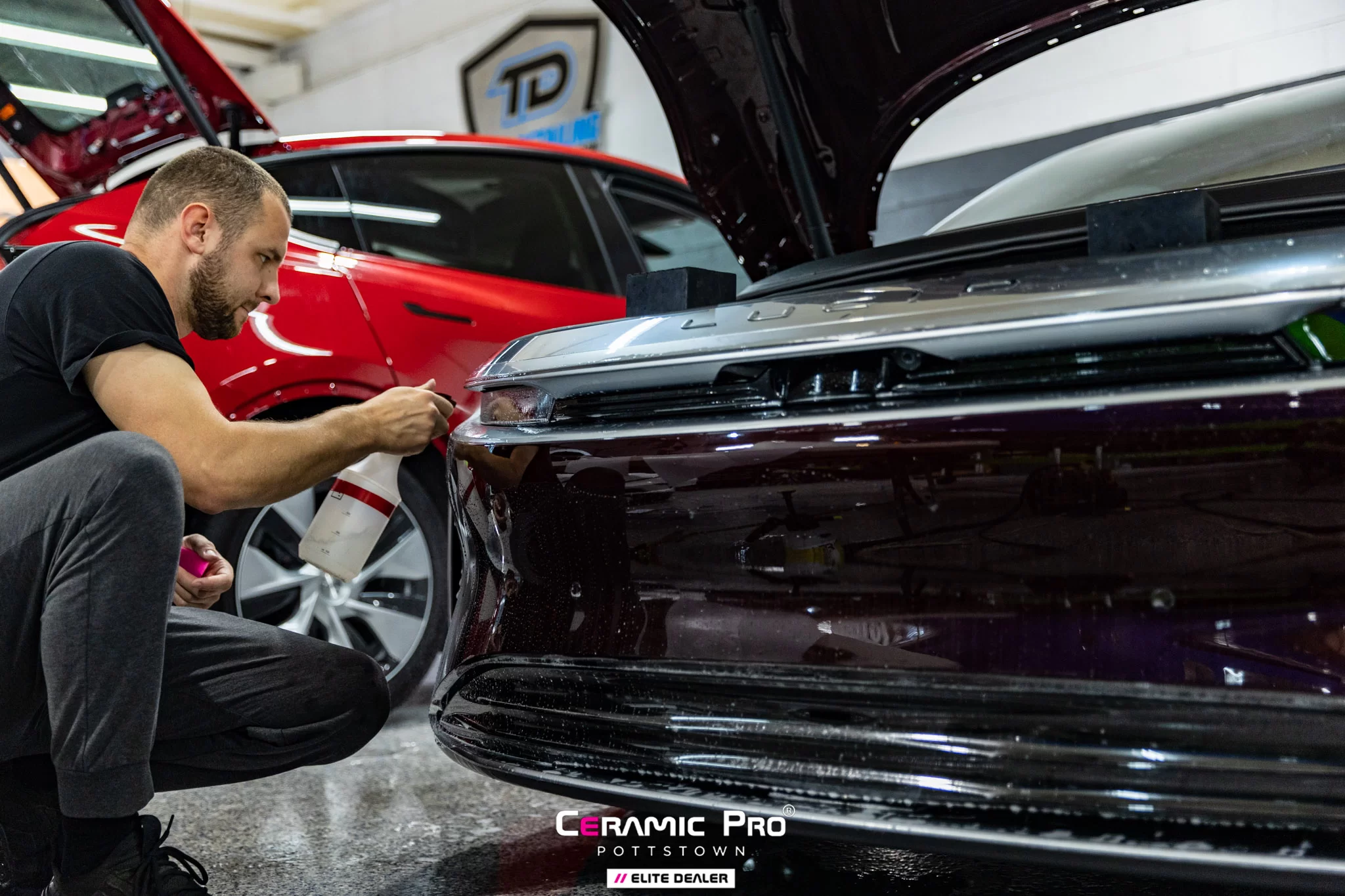

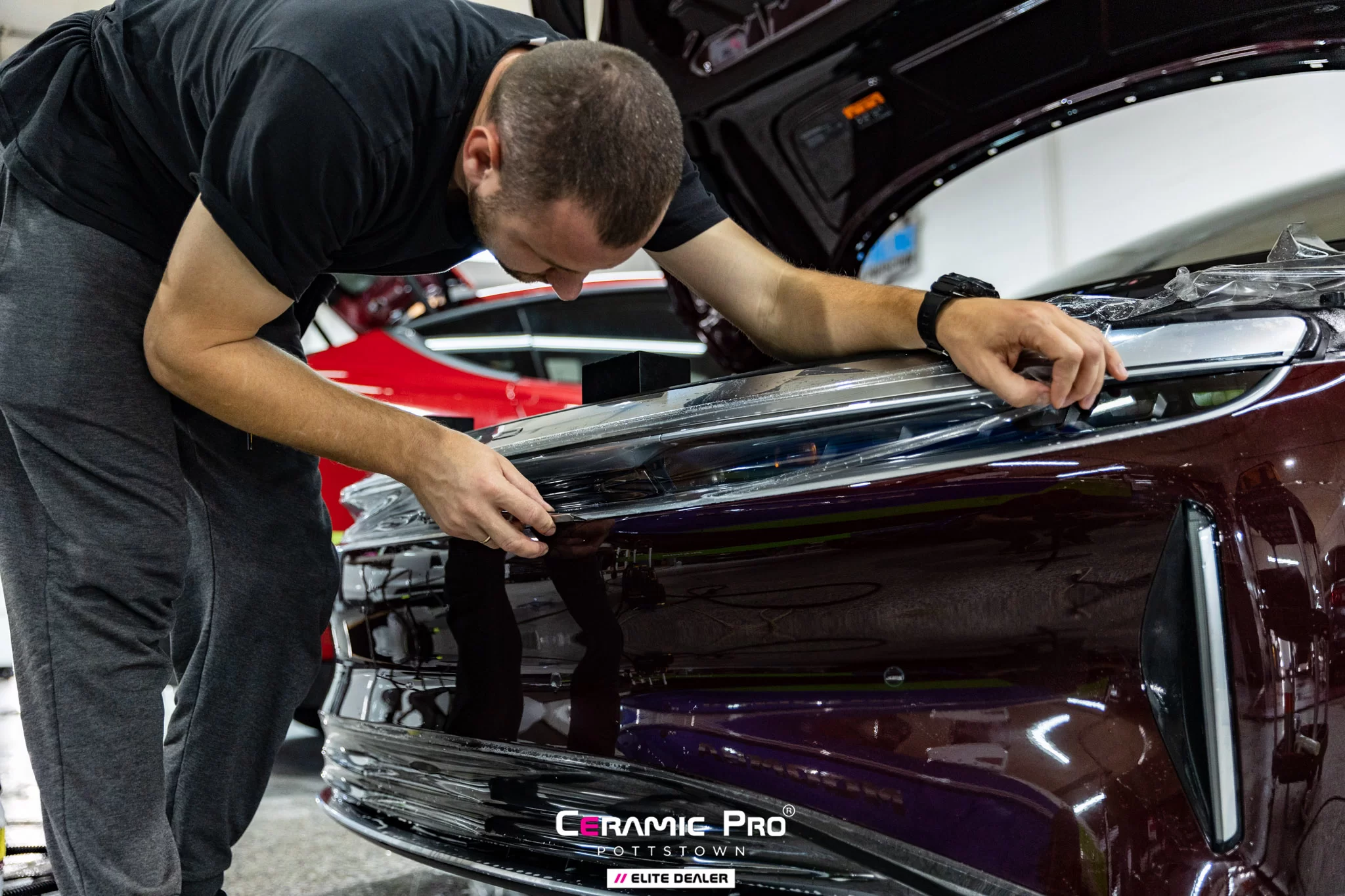

Here you can see Danik is trimming the upper seam of the front bumper. This edge is tucked under the light bar trim for the most part, in most cases. Don't worry - Danik is a well-seasoned PPF installer and has over 10 years of experience installing film, doing completely custom installs on cars worth millions of dollars. Many shops brag about "we don't cut on paint" - that's because they don't have an installer that's skilled enough to cut on the car without damaging it. It takes TIME to understand knife feel on PPF. I trust Danik to cut on any car, of any price point and any rarity.

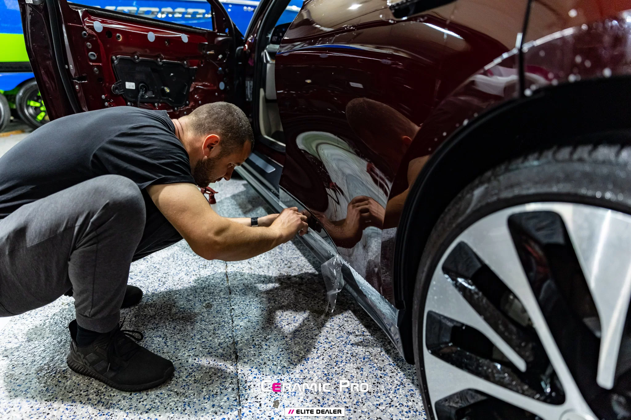

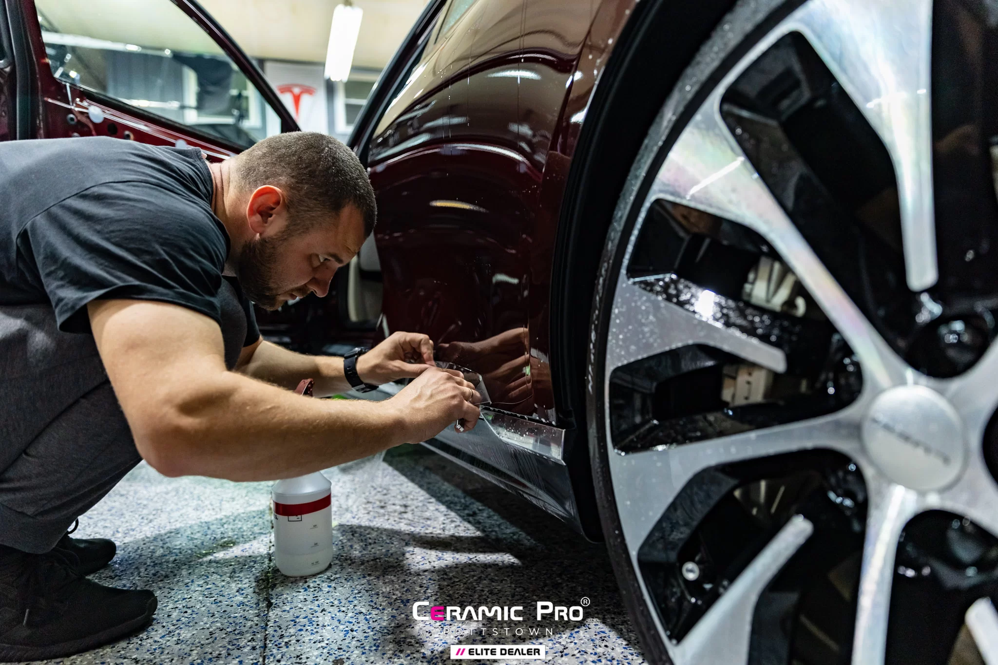

Danik is installing our Ceramic Pro KAVACA Paint Protection Film on the gloss trim of the doors here. Danik prefers to give every car a custom install.
Here Danik is hand-trimming the door handle. This is a part most shops skip because the kit for this piece doesn't fit very well. Danik, as you can see here, is gettin' SURGICAL with this trim.

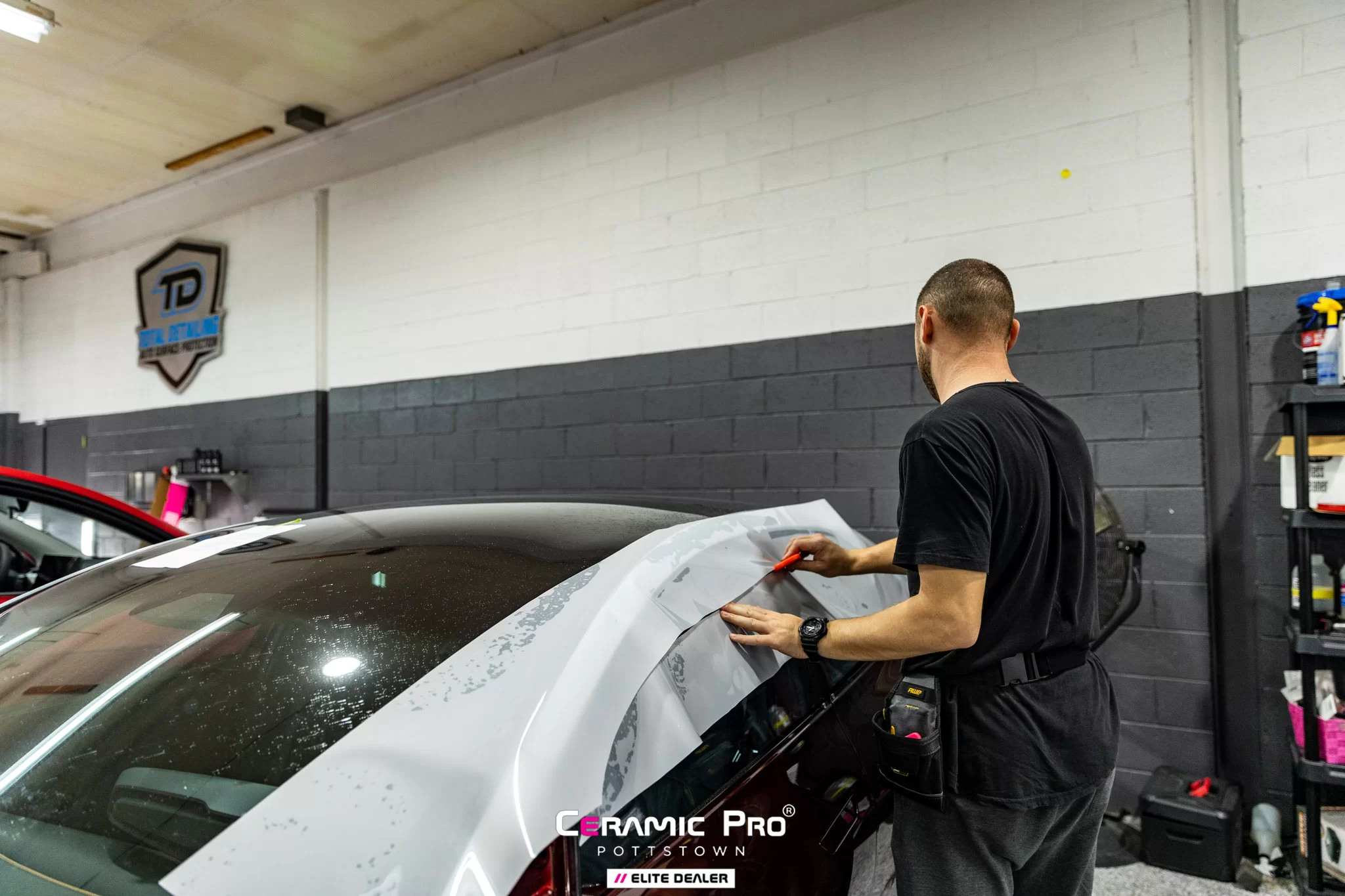

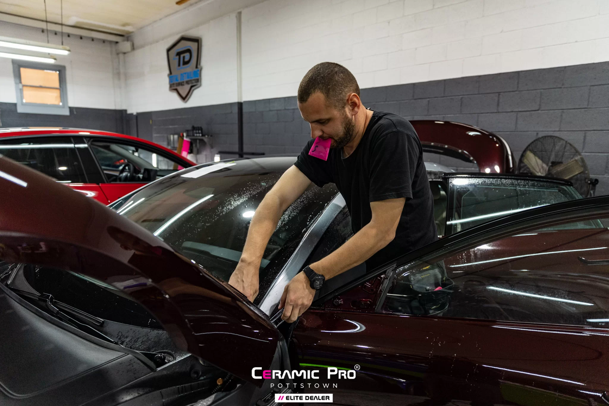

Here you can see Veteran PPF installer Danik laying out the piece of film for the a-pillar. Danik will take a large peice of film, lay it out over this and use a sliding cut-down tool (orange in hand) to trim the film to the rough shape of the panel. This allows Danik to stretch it with minimal distortion or mishandling. The film still has the release liner installed here, which is why it looks white.

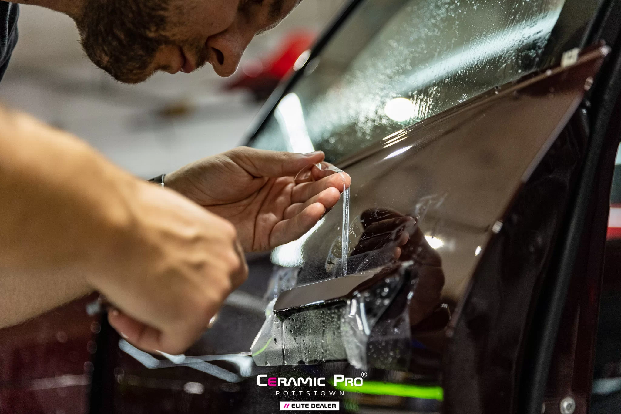

Danik is stretching the film, now with the release liner removed. He is going to stretch it to the bottom of the a-pillar and then flush the bottom edge with alcohol and tack it.
