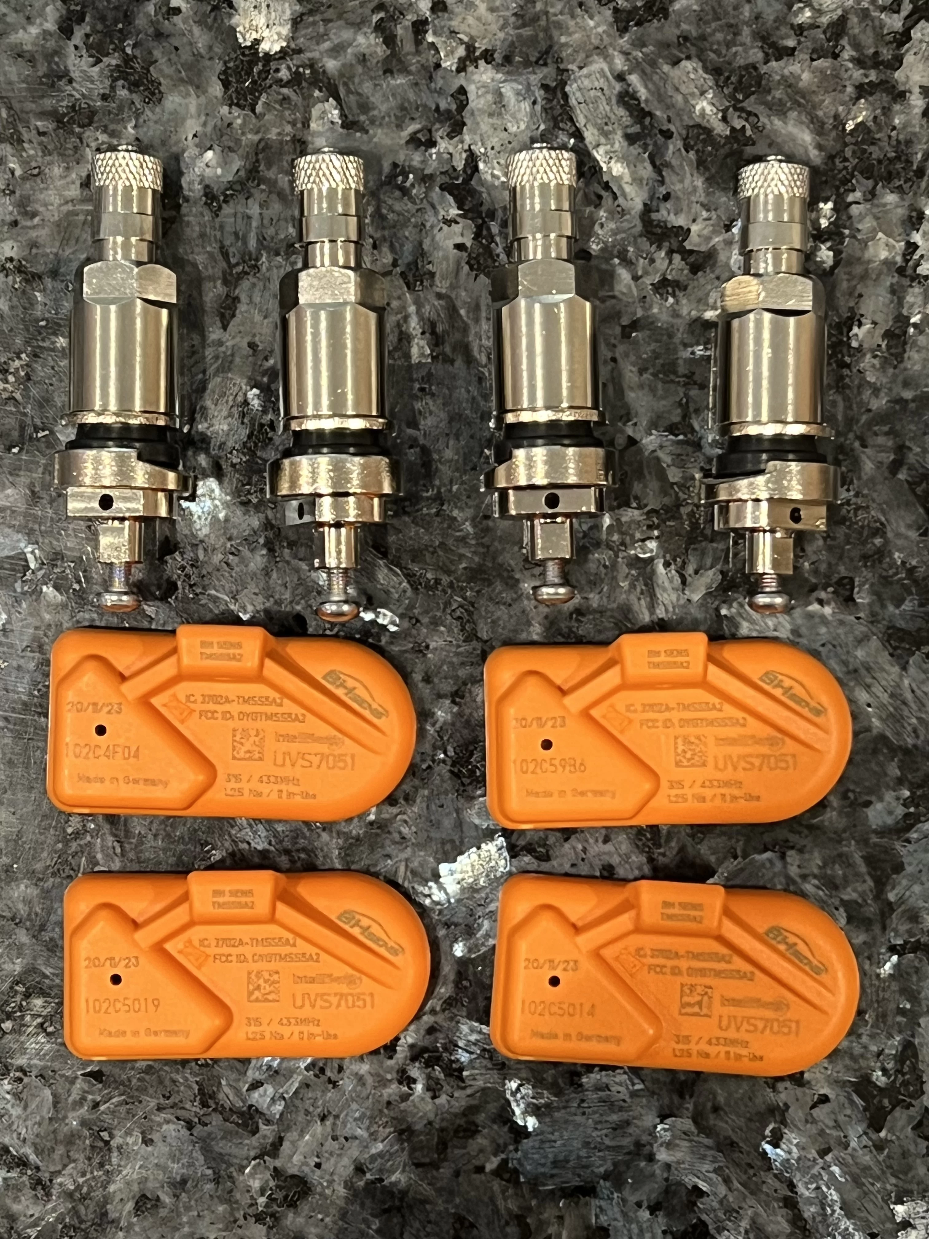

I used the Autel MX TPMS Sensor and used their tool to clone to the Lucid Factory sensors.

Just got the 20” summer wheels switched with the new 19” wheels with new TPMS sensors (Dual frequency). I switched the setting in the vehicle from 20 to 19. However, the vehicle is not seeing the readings ftom the new sensors. Drove about 15 miles with no success. I searched the forum but haven’t gotten a clear confirmation if service has to do something with the first swap or will the change of settings from 20 to 19 will do it? Can someone confirm?

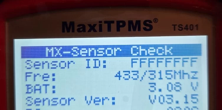

The TPMS sensors may not be programmed with an ID. The Autel MX (315/433 Mhz) sensors do not have an ID by default (id: FFFFFFFF... I believe)
You can auto create an ID or clone (with programmer) . I chose to clone.
Another member on the board said his sensors registered on their own.
The Toronto Service Manager said if you buy their TPMS sensors they will also learn on their own.
I got 19" wheels with 433 MHz TPMS sensors from Tirerack (whatever they default provide) and my 22' AGT picked up them without issue after a few miles - they've been working perfectly for a few months now
Zero service appointments needed, they registered on their own

The unprogrammed sensors I used look like this when new.
Programming them assigns the Sensor ID and frequency they will use.
