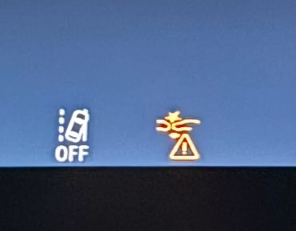

I looked in the manual but it doesn’t say what this orange warning indicator means. It has now displayed two different times on the car and it goes away after a few minutes. If you know please tell me.

I took a picture and asked ChatGPT. Take this with a grain of AI salt.
The orange warning light on the right in your Lucid Air display image — the yellow triangle with an exclamation mark and a stylized car/skid icon above it — typically indicates a problem or status related to the vehicle’s stability control system, traction control, or driver assistance system
What It Likely Means
This icon is generally associated with:
Stability Control / Traction Control Fault or Deactivation
  • The system may have detected a fault.
  • Or, it could be manually turned off (or partially disabled).
  • In some cars, this icon also pops up momentarily if traction control intervenes (e.g., in icy conditions).
⚠️ Given It’s Accompanied by the Lane Assist “OFF” icon:
  • This likely means multiple driver-assist systems are disabled:
    • Lane Departure Warning / Lane Keep Assist is off.
    • Stability/traction control may also be off or limited.
✅ What You Should Do:
  1. Check if systems were manually disabled.
    • Sometimes done via a steering wheel or dashboard control.
  2. Restart the car — if it’s a glitch, the warning might clear.
  3. If it stays on, or you’re unsure:
    • Check the Lucid Air owner’s manual for the exact symbol.
    • Contact Lucid support or schedule a service check

Thanks. Not sure why that would illuminate I was driving straight with no issues. I guess it’s just some type of glitch.
This is the forward collision indicator, so this means the forward collision indication system is off. Or inoperative.
This is correct.
Were you parked in the direct sunlight? If so, that can overheat/blind the camera temporarily, and it takes a few minutes to go away.
