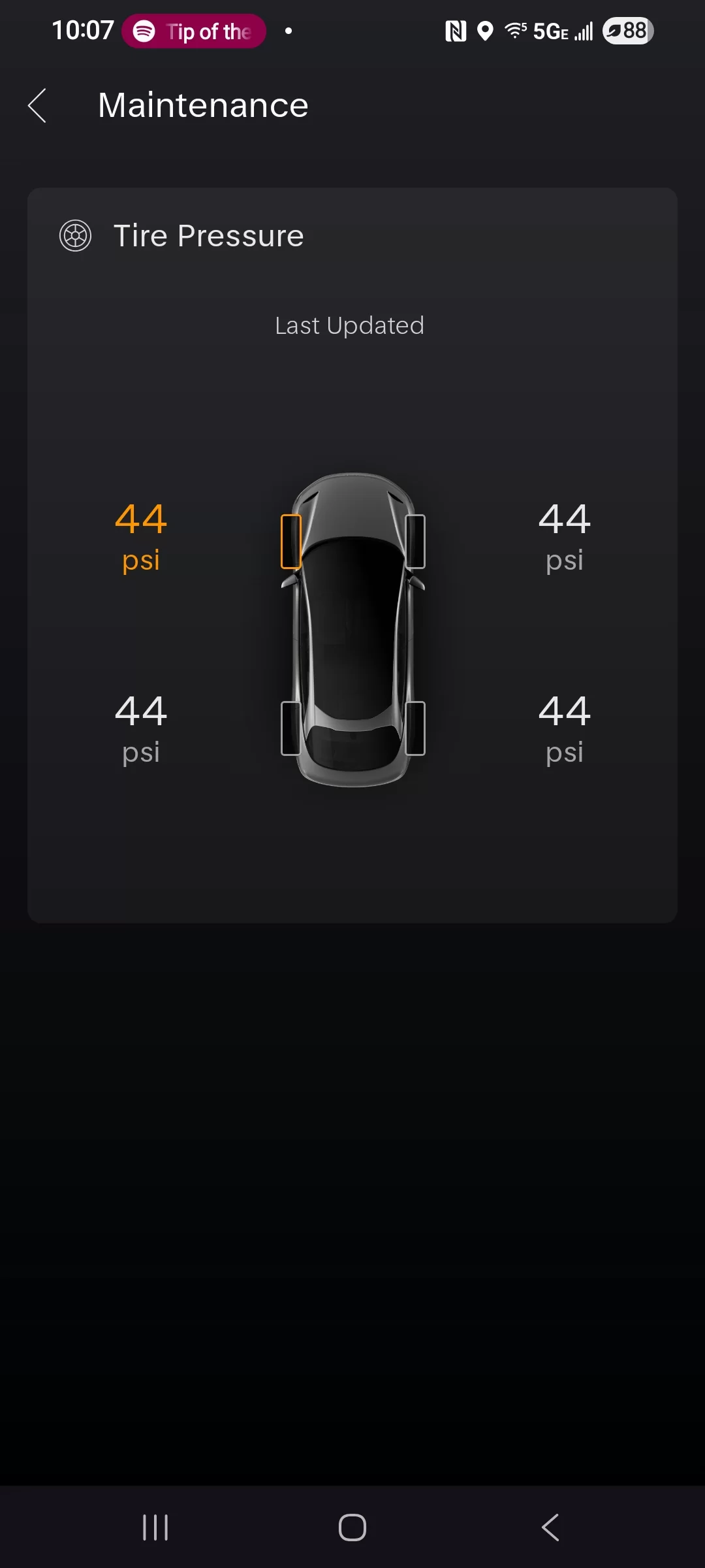

Hello. I have been receiving a persistent low pressure warning on my front Driver side tire but all the psi’s are the same. The weather is 80’s to 60’s each day. Any ideas? Thx
Received this the other day in my right rear tire. Pretty sure the display is rounding the pressure, so your front driver side is probably a bit lower, triggering the warning.
The change in temperatures at this time of year can cause some issues for those of us trying to keep tire pressure optimal. I found the Lucid TPMS pretty accurate, but you may want to check the pressure "manually" and top off as necessary. Keep in mind that the outside temperature is going to affect your pressure. Always check your pressure when cold (not after driving).
If all your tires are the same pressure, it sounds like all of your tires need some adjustment. 19" A/S should be at 49 PSI.
I am having the same issue but they are all reading the same.
19. Specs say 45 psi. Just added air Sunday. They all show 44 but front driver says it is low.
Where did you get 45? The cold inflation pressure for 19s is 49 PSI.
The 20s and 21s range from 42-45 PSI depending on speed (above 155mph it should be 45psi cold).
The 19s are 49 PSI, always.
tl;dr: your tire pressures are all too low. The reason only one shows an alert is because it’s a couple decimal points lower than the others, so it might be just on the cusp of too low. (43.8 vs 44.4, for example)
