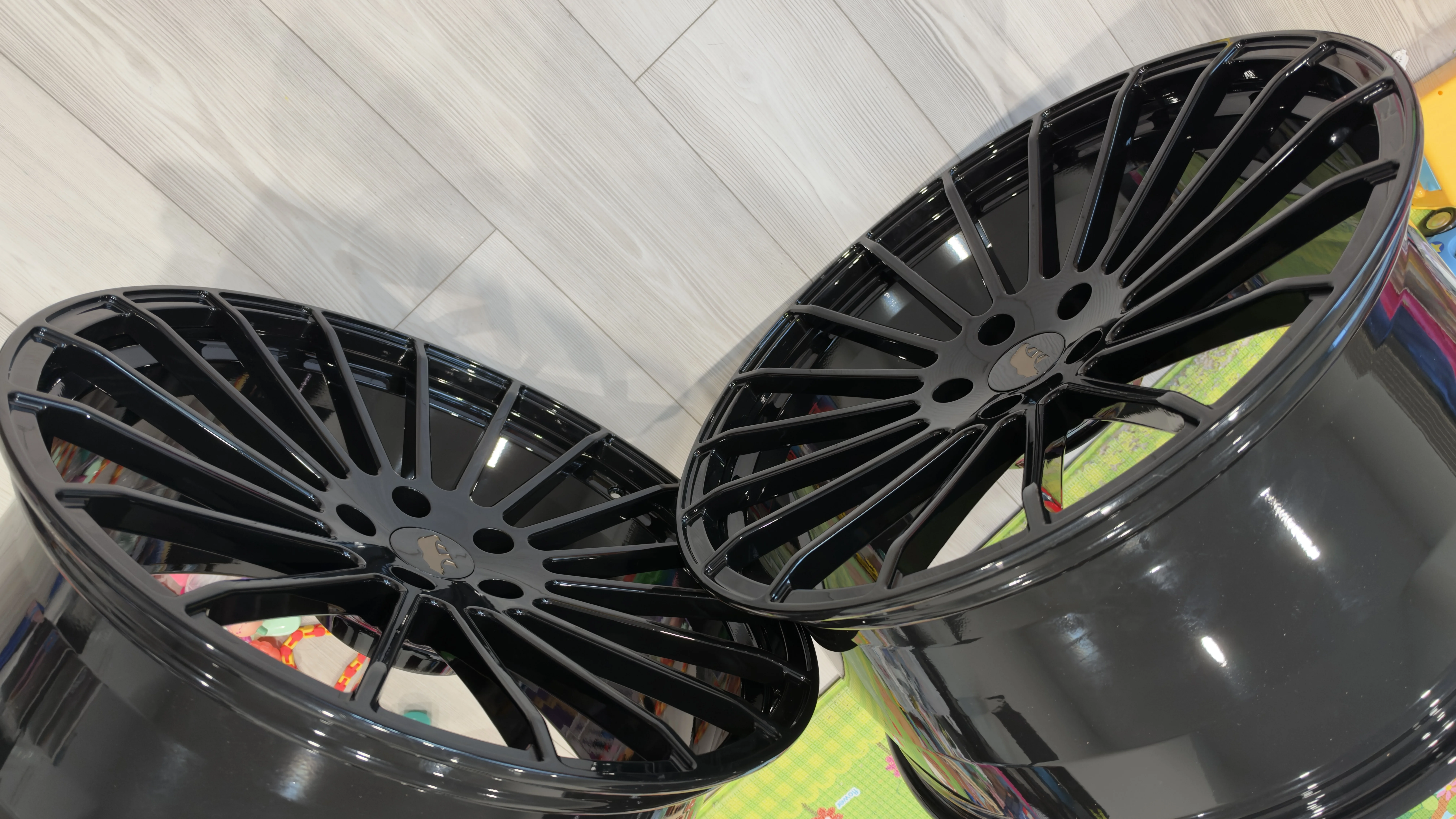

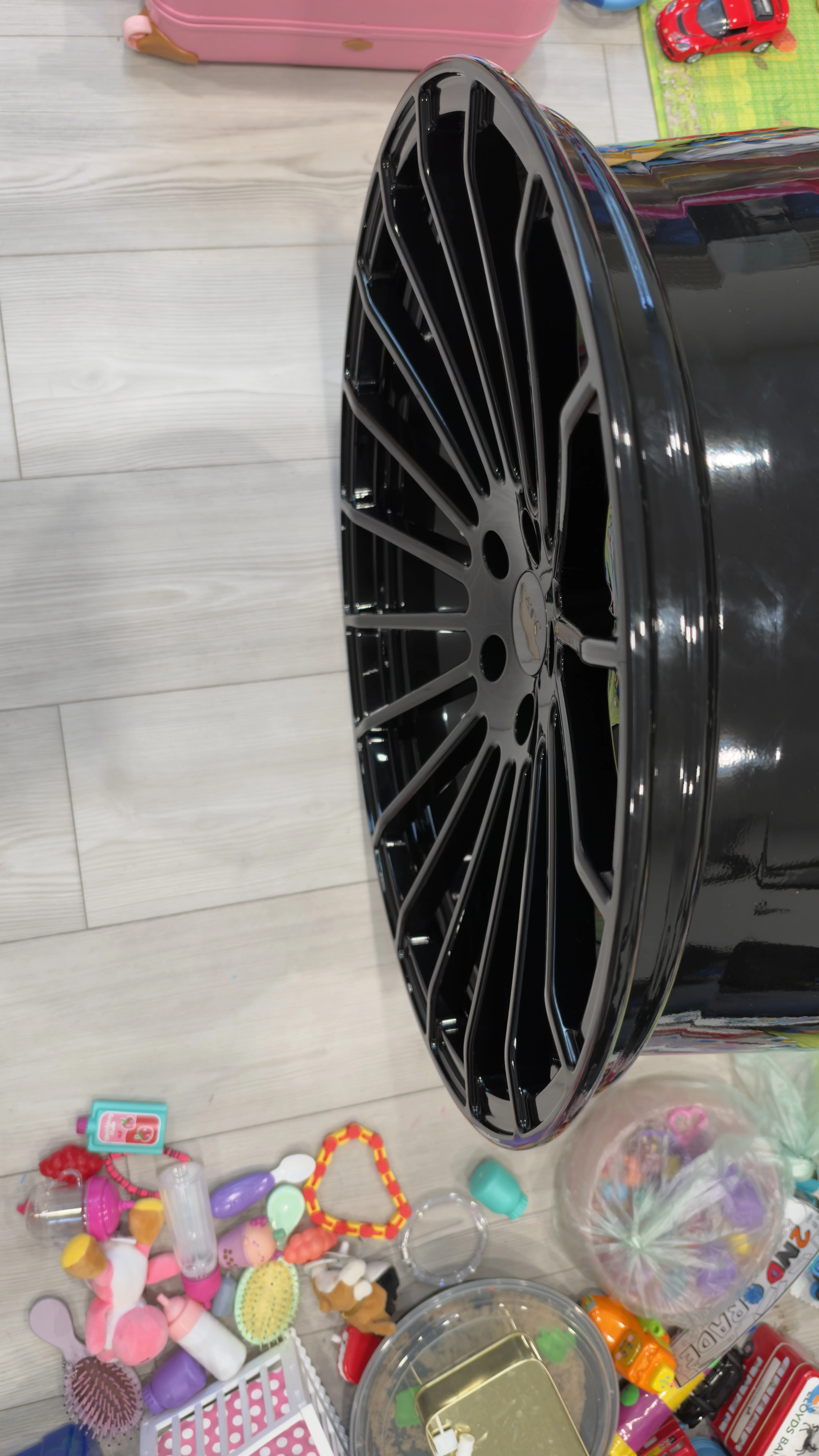

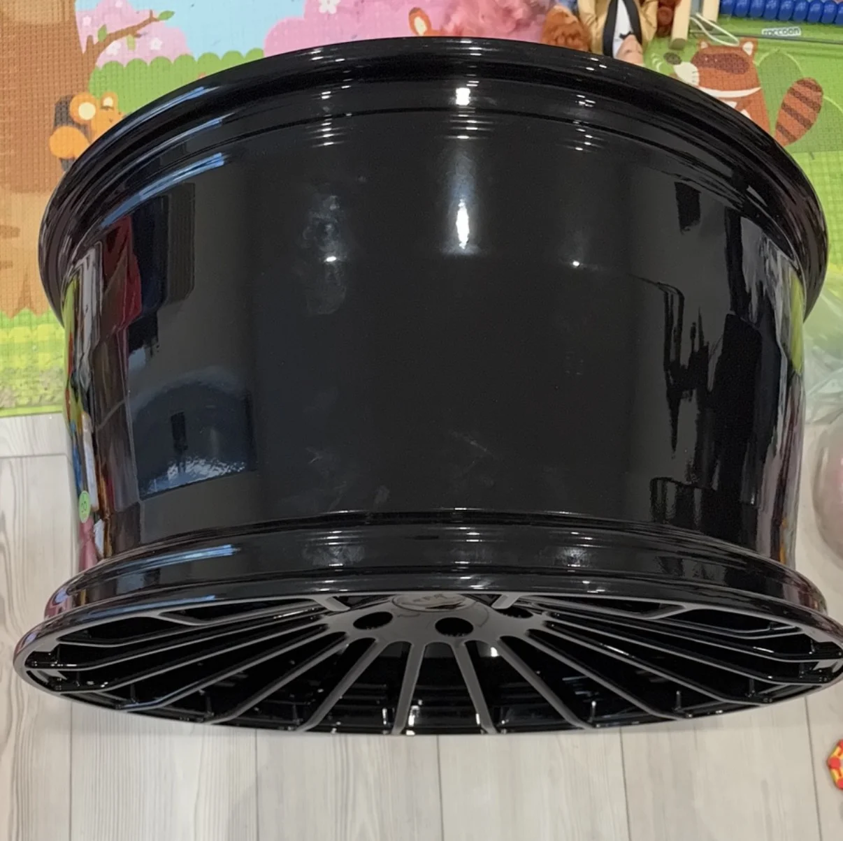

Gravity GT custom wheels
22x10.5” front
22x11” rear
295 tire front, 315 rear.
Detailed photos after install. This will be my winter clear road setup with some snow and ice capability, but mostly clear road.
Tire: Continental 860 S
Custom spec, forged, 32lb per wheel.
Capacity: 1300KG

Great setup.
Do you need any modifications/ addition such as spacers, etc?
Where did you get the wheels from?
And showing my ignorance here, can't you use the Lucid 22 wheels all around?
Great setup.
These are custom made to my spec, if they fit the way I mathed it, no modifications, direct fit.
As far as Lucid 22”…they aren’t made for a square setup, front and back are different and not interchangeable due to offset. Front will only fit rear if 22” and none of the rear will clear the front comfortably. So…don’t mix and match Lucid wheels and tires out of factory spec.

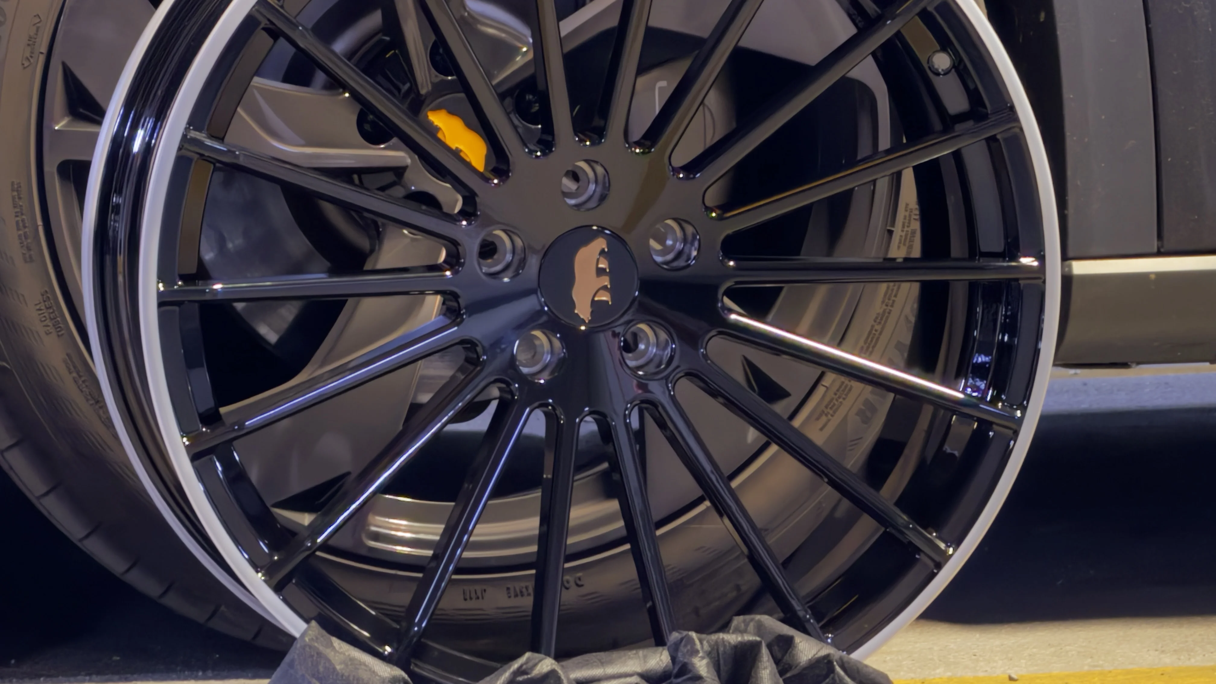

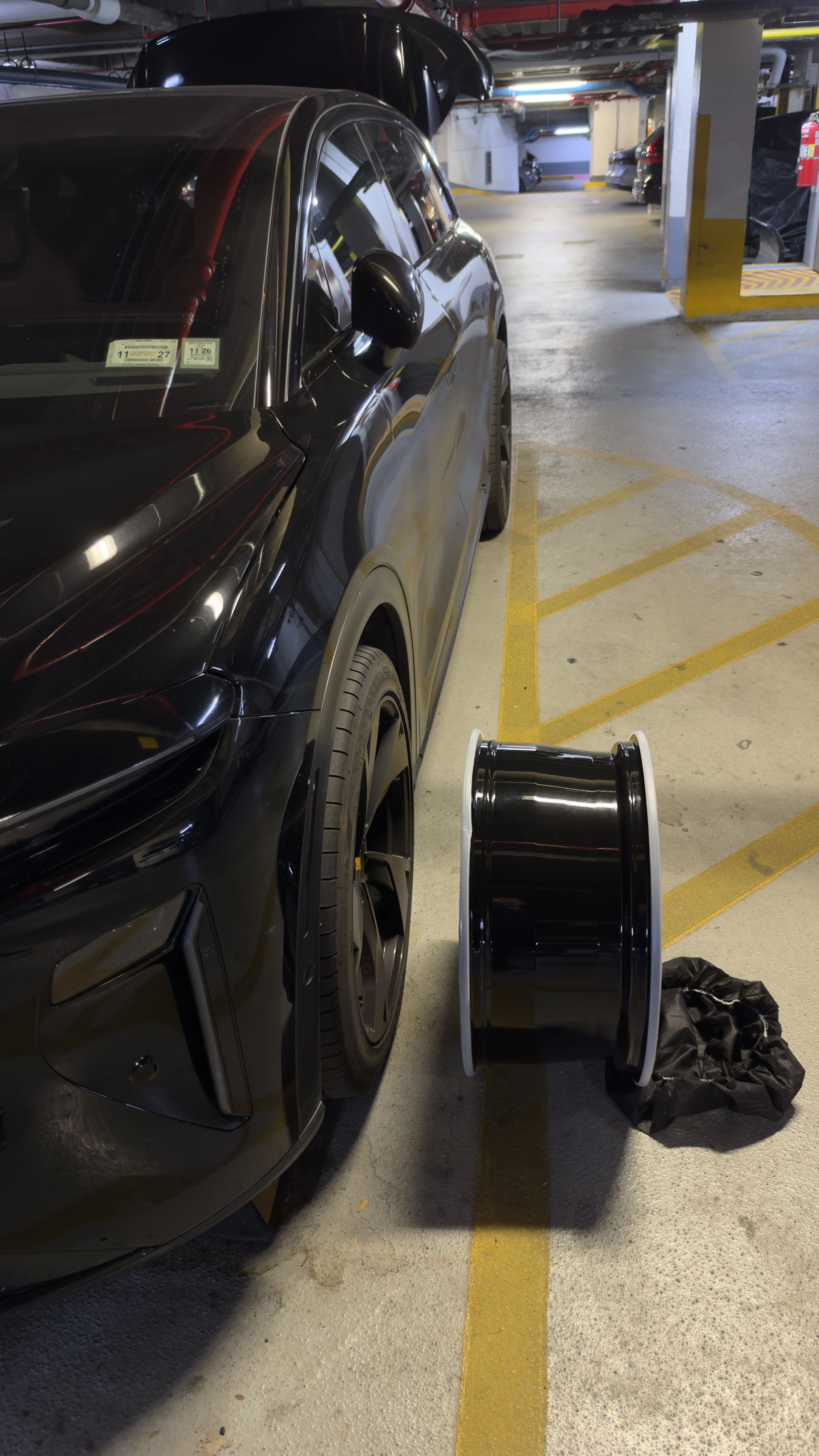

Apart from cost, magnesium doesn’t play well in the winter…so I haven’t gone that way.
As far as summer…I have a set of Lucid large wheel replicas and if someone decides to buy those from me…Magnesium might be a thing.
I think I tried 5 or 6 tire combinations so far and to go magnesium it would need to be a sure thing…can’t be guessing offsets and tire combos there. The next try I should have all the tried and true data I need.
But I would need to sell a set or two…currently at 3 sets and gotta confirm fitment on the winter set first.
