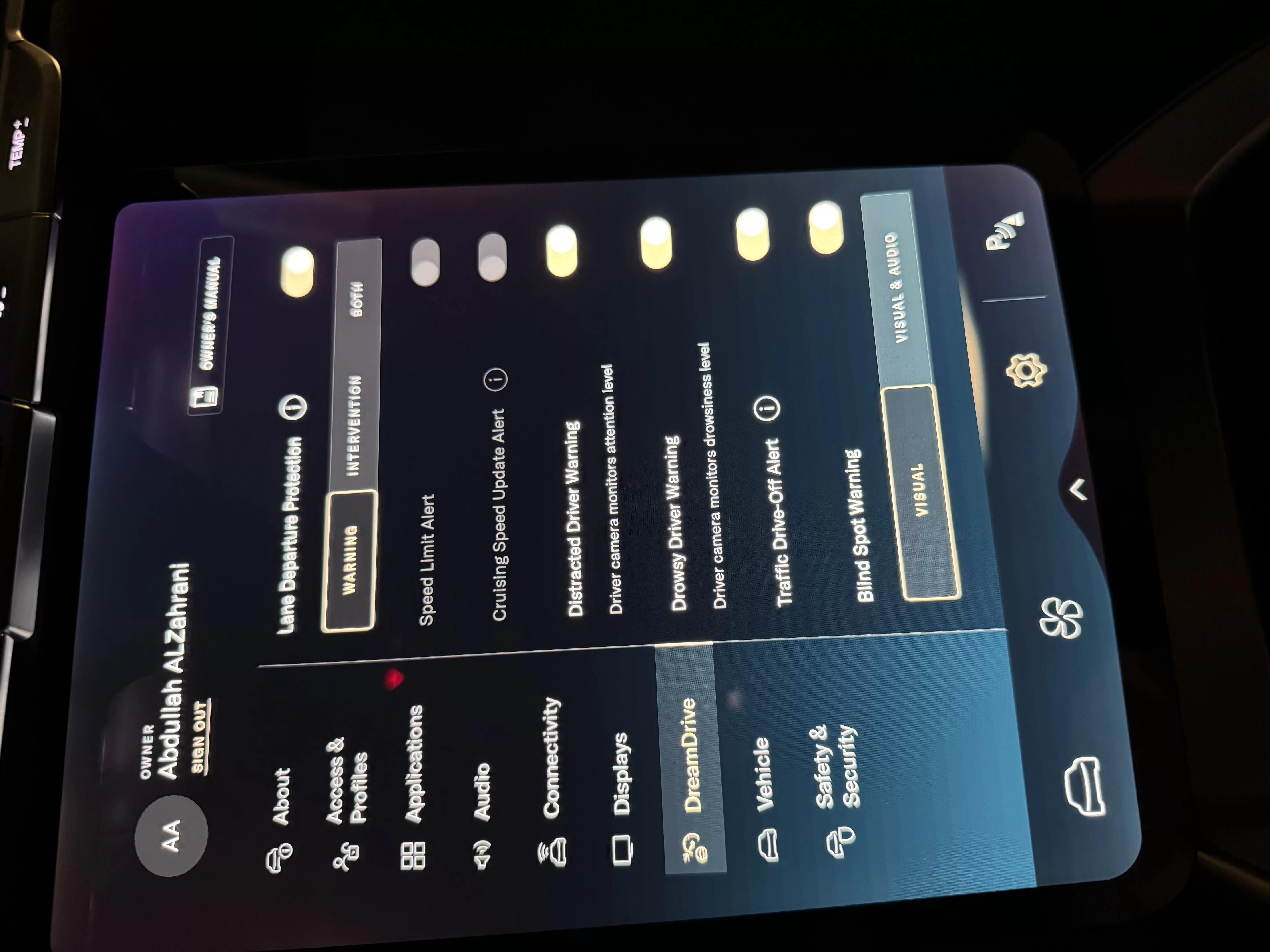

Hi there,
I have both speed limit alert and cruising speed update alert disabled (See Pic). Anyone know how to enable?
Same with me
I guess because it is new and you need to drive for couple of thousands
Hi there,
Hm, that should be working fine; it doesn’t require time like HA. Contact customer care and/or service.
Do all your cameras work?
Did you try an infotainment (aka Air Logo) reboot? If that doesn't resolve you should contact customer care are recommended by @borski
It's always been disabled for me (I'm at 4500km now and had it for 6 months). Was told by Lucid it's not ready here.
Has it ever been on for you?
For those wondering, this is in Saudi.
Hi, Lucid owner in Saudi Arabia
I have the same issue, both setting are disabled for me as well, I guess this is a regional thing
I believe this feature is supposed to read the street speed limit signage via the camera and set the limit accordingly.
Usually, when a feature is disabled in a country that is generally enabled elsewhere it is because of a law in that country. So my guess is that something in SA law is causing Lucid to turn it off.
My friend's Mazda has a HUD with speed limit displayed 💀. It's probably something else.
i’ve I driven my car for 500 miles and i’ve been using this feature when using the adaptive cruise control. I live in a rural area and the speed limits change quite frequently when going through small towns. It is using the cameras to actually read the signs and not using mapping software. I would say it correctly reads the signs 90% of the time.
It informs you on the main cockpit screen to the left and does a countdown in the upper middle. You have to press the speed cruise control roller/button for it to change to the new speed.
Some times it misses a sign and sometimes it picks up the lower speed sign for a curve, but if you don’t push in the speed roller/button with in the countdown it does nothing. It’s missing of new speed signs gets worse at night.
I have a late model ‘24 and I was able to enable the feature in settings under Dream Drive. I have Dream Drive Premium so not sure if you can enable it on the base Dream Drive.
Overall I like the feature, it’s much easier pushing in the button once to get to the new speed, rather than pushing up or down repeatedly to set the new speed.
