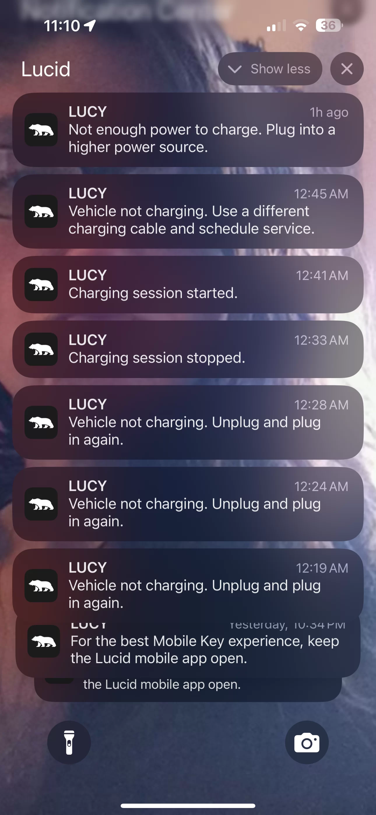

This fix was short lived, probably should not have posted it lol. Problem is with the Tesla wall charger (see various error messages in the screenshot) as the Lucid Mobile Charger works fine. Getting the wall charger looked at this afternoon.

The electrician came and looked everything over, and replaced the breaker. Switched out my TeslaTap breaker for my backup TeslaTap adapter and it seems to be working fine now.
