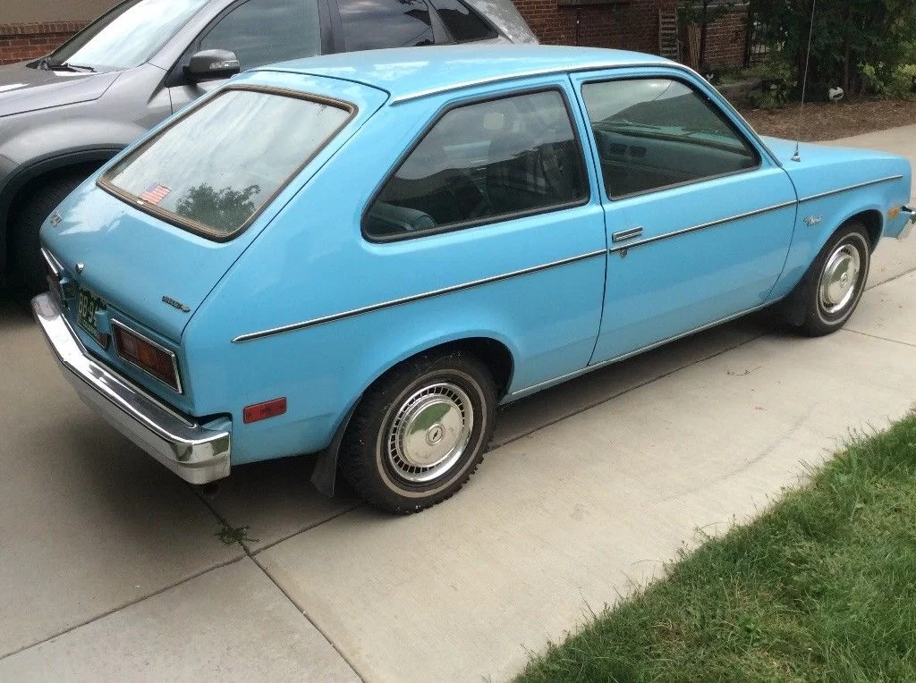

My favorite snow car was an 80's Chevette 4-spd.
Light enough to push out of a snow bank, RWD with 50/50 weight balance, a set of snow tires and a shovel and I'd go out blasting drifts in the teeth of a snowstorm. Loved that car. Yes back in the day (NH skier) "drifting" meant something different. A close VT friend had a Valiant slant six with classic rust + duck tape. We'd put chains on and go out at night blasting to see how far we could get through drifts, get stuck, firedrill out and shovel like madmen..then back out and try it again... chains on the snow tires...can't stop us. I'm pretty sure most of the occupants were not sober... it was only us and the snow plows ... no sane person would go out in a winter Nor-Easter.
