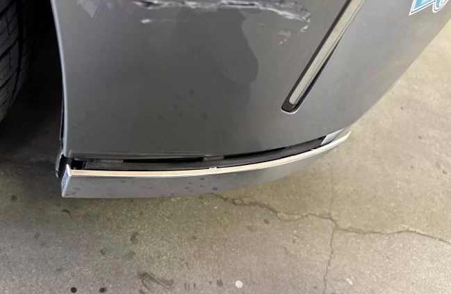

I see this type of damage probably more than anything else on the Lucids we repair in my facility. Common symptoms that can come up after bottoming out hard in a pothole or striking a curb/driveway is that the A/C stops working, and faults begin to display on the cluster regarding the turn signal and radar sensor functionality. You may also notice the wheel well liner missing clips/hardware, or rubbing against the tire.

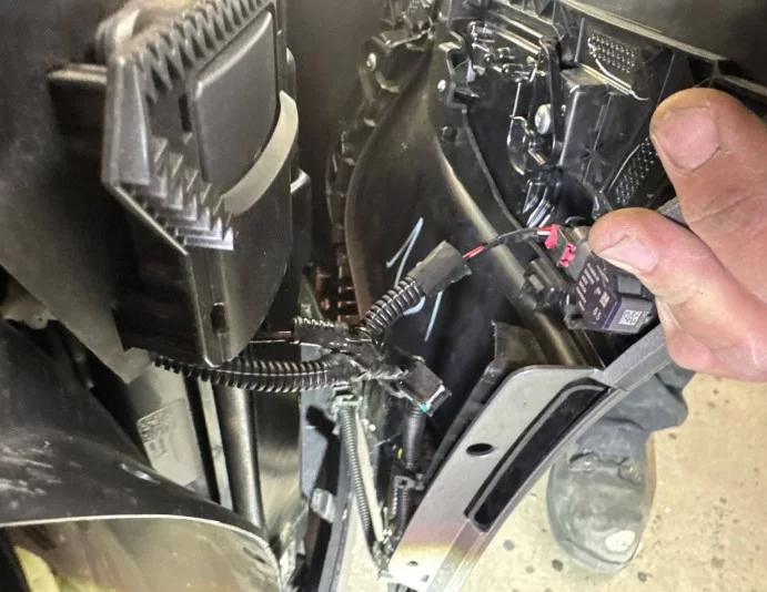

After loosening the bumper cover, you can see the radar sensor in the upper left, turn signal LED on the right lower, and the radiator/condenser/fan combination mounted to the FEM (Front End Module).
