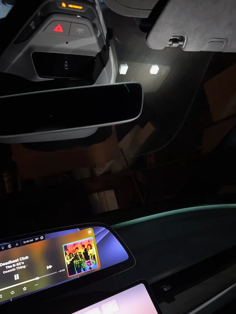

Can someone with a 2027 gravity post a pic of where they placed their ez-pass? I’m having a difficult time seeing the box after getting the windshield tinted. I think it goes where I drew in the attached pic but unsure.

Here's mine, hasn't failed since I got the car. Sorry it's dark, I can take again in the morning if you want.

Use a flashlight directly at the inside and you'll see the rectangle.
I tried using my iPhone camera. I’ll try again with a brighter flashlight. Odd they don’t have anything discussed in the manual, at least I couldn’t find something.

The tricks are:
1. It must be dark outside (or in garage).
2. Sit normally in the drivers seat while holding the flashlight on the passenger seat pointing in the general direction.
Note, it's much harder to photograph than to see in person. I've only used an LED flashlight, don't have any incandescent, maybe the limited frequency range of LED helps.

Awesome guidance. I see it now. Looks like mesh in the windshield. Thanks a lot.
