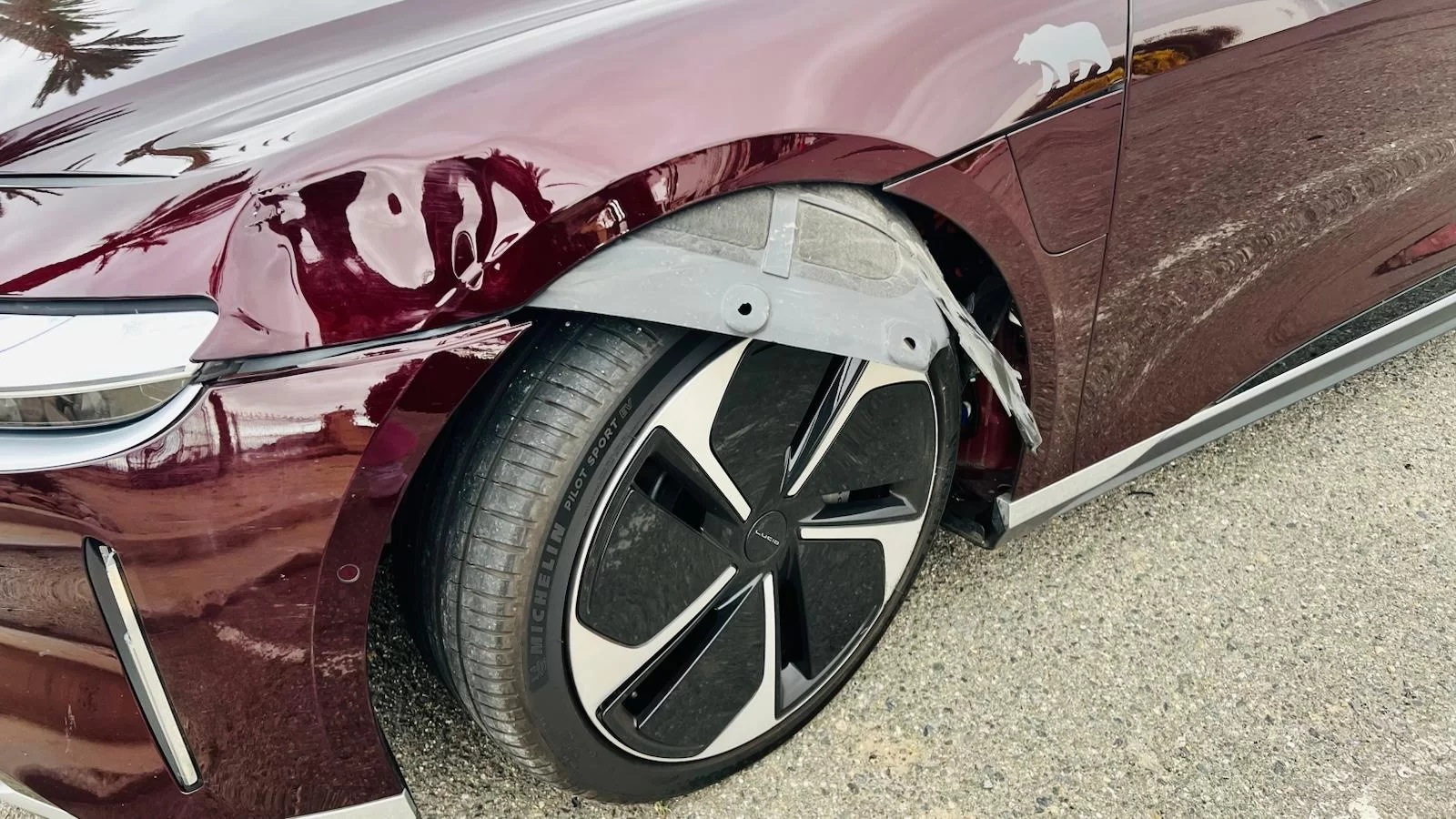

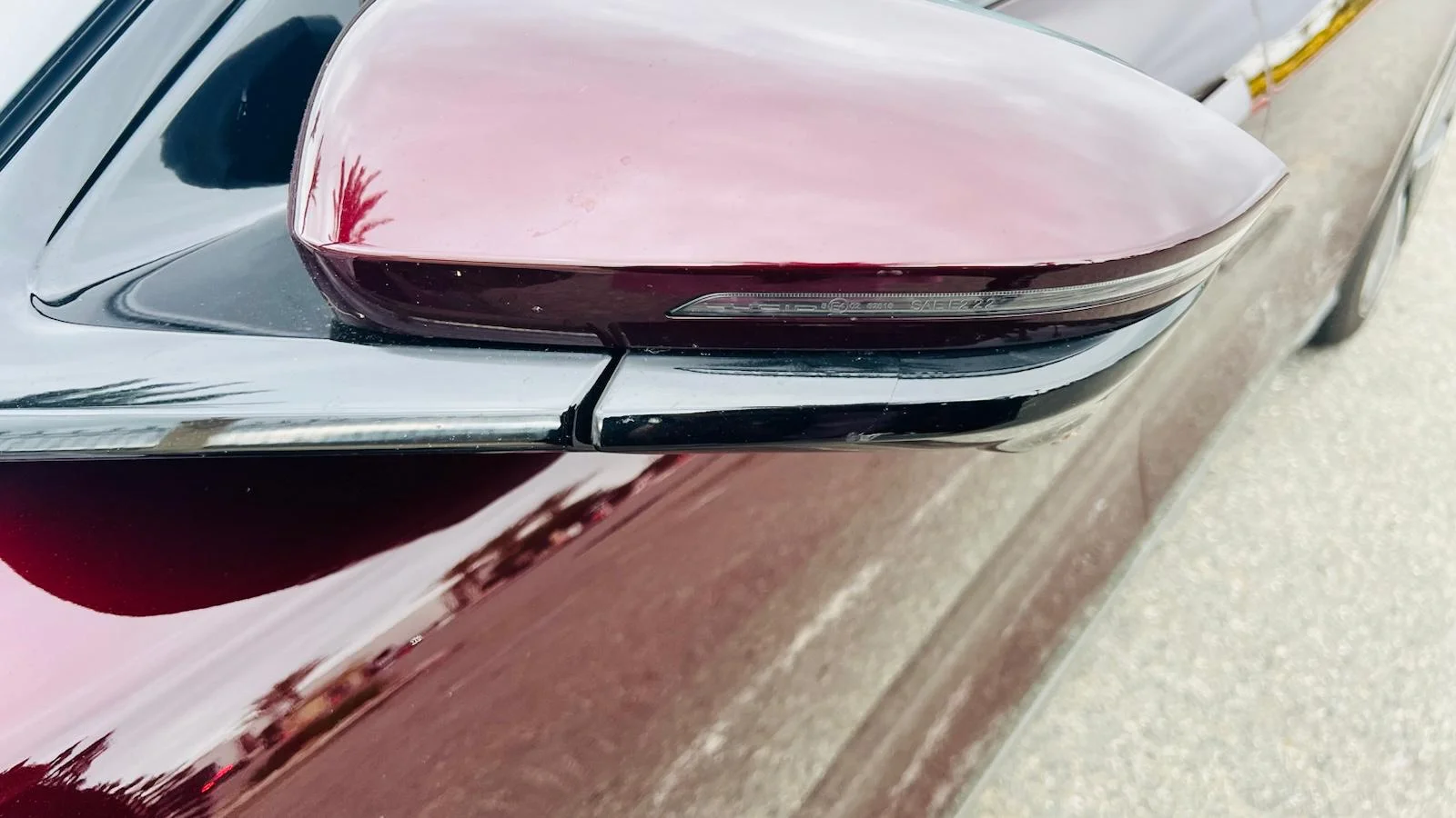

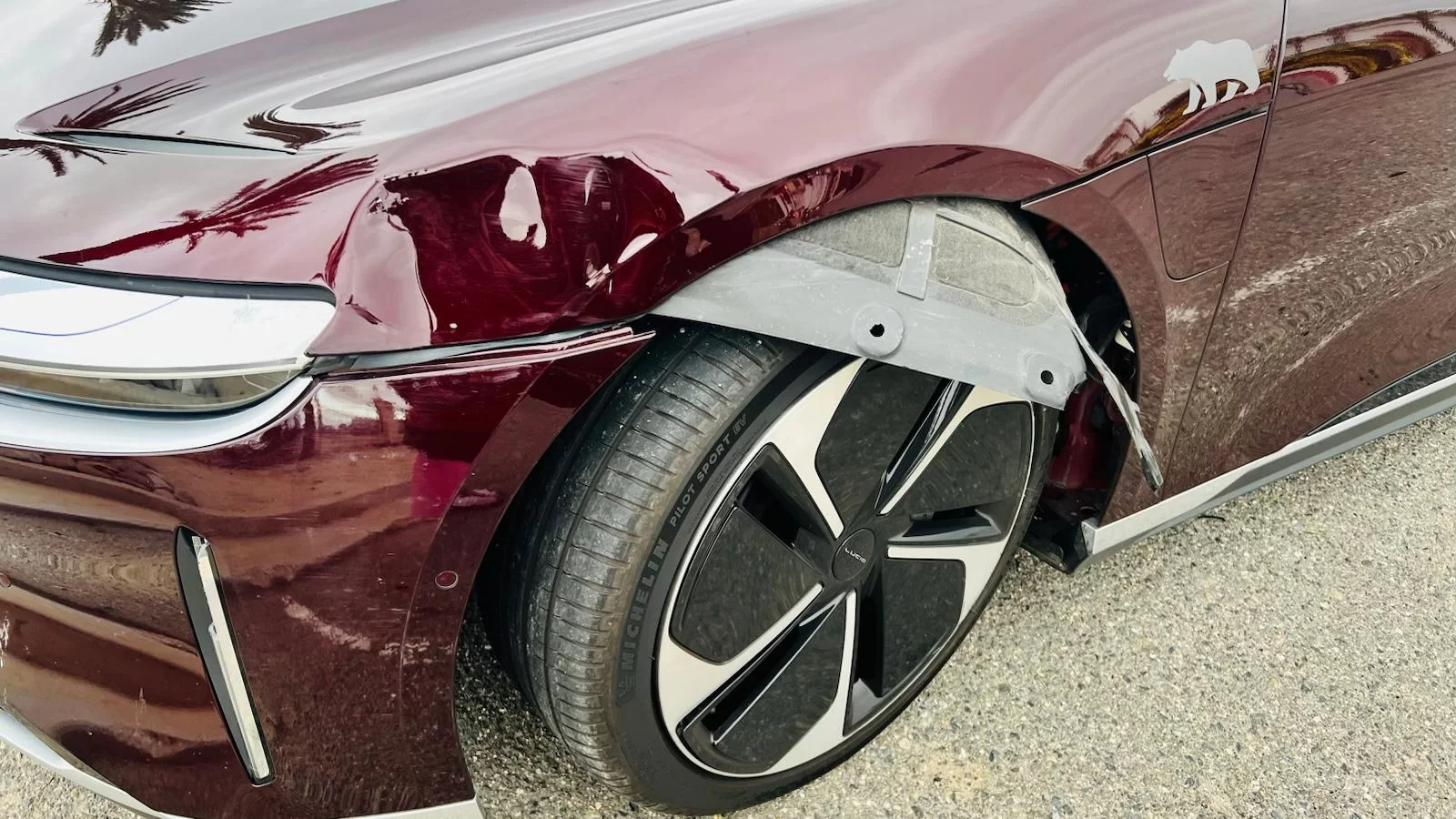

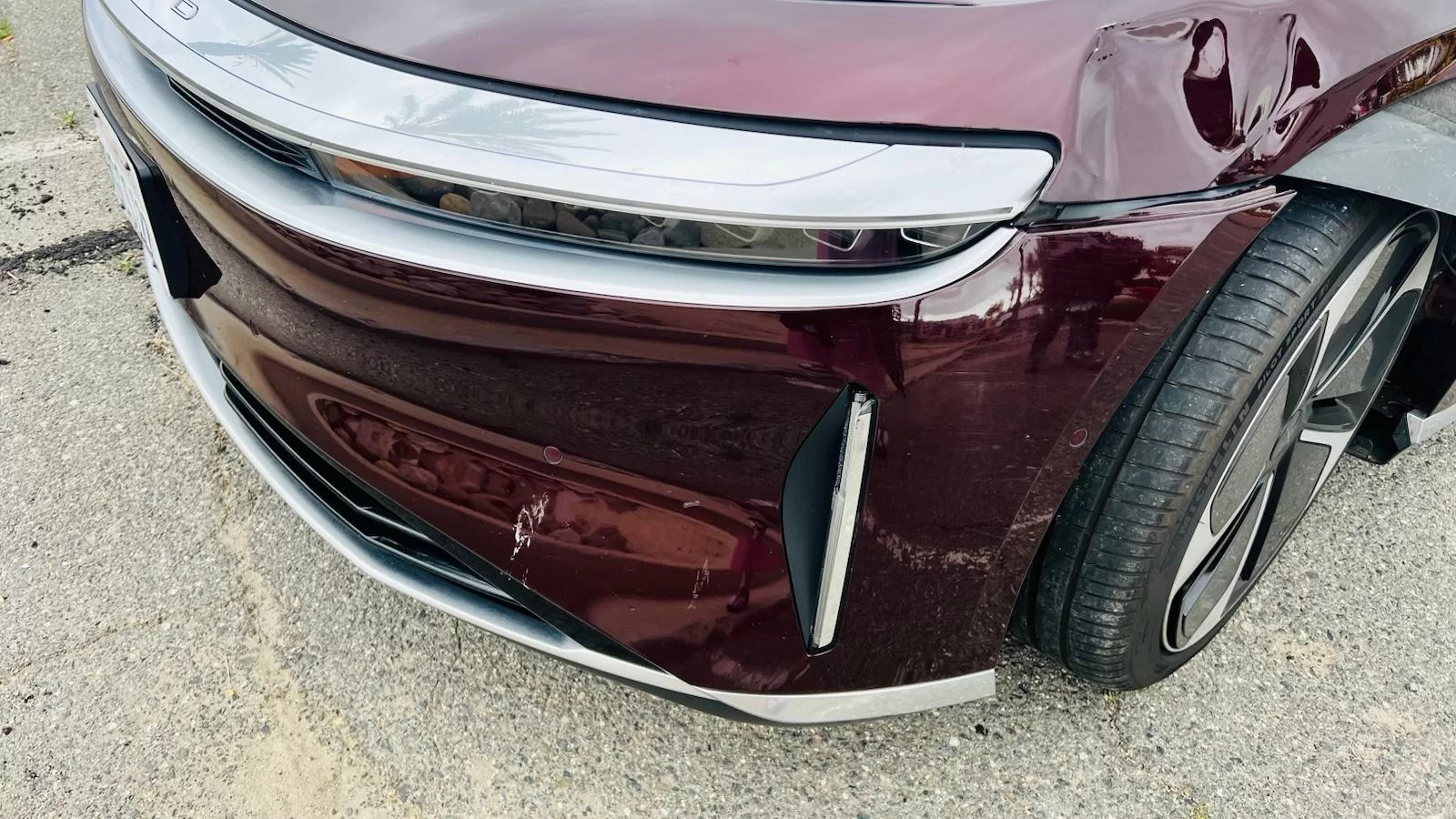

My 2023 Lucid Air Touring with VIN 50EA1TEA7PA004423 had a Sudden Unintended Acceleration event on Saturday, 5/17/2025 at the BAPS Swaminarayan Hindu Temple, 15100 Fairfield Ranch Road, Chino Hills, CA 91709 at 5.30pm. Specifically just after taking off my foot from the accelerator in order to get a parking pass at the temple, I found the car unintentionally accelerate at a very high speed and it crashed into the pavement and a post on the premises. Luckily there was no human or animals on the way and while I suffered minor injuries, no one else was harmed.
This is very similar to the all weather mat recall but Lucid stated my mats were not on the recall list.
My vehicle is currently at European Motor Car works Body shop at 3330 pullman street, costa mesa, CA 92626 and I request a full investigation by Lucid engineers. The Lucid incident case number is 00934201.
Can I request the owner forum to give me advise....how to address this case with Lucid management and with my insurance company. Assuming it gets repaired at the body shop, how to ensure that unintended acceleration will not recur again ? PLEASE HELP!!!!
