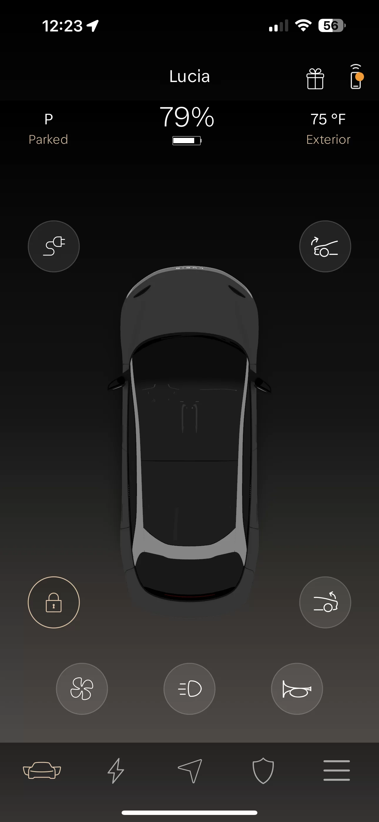

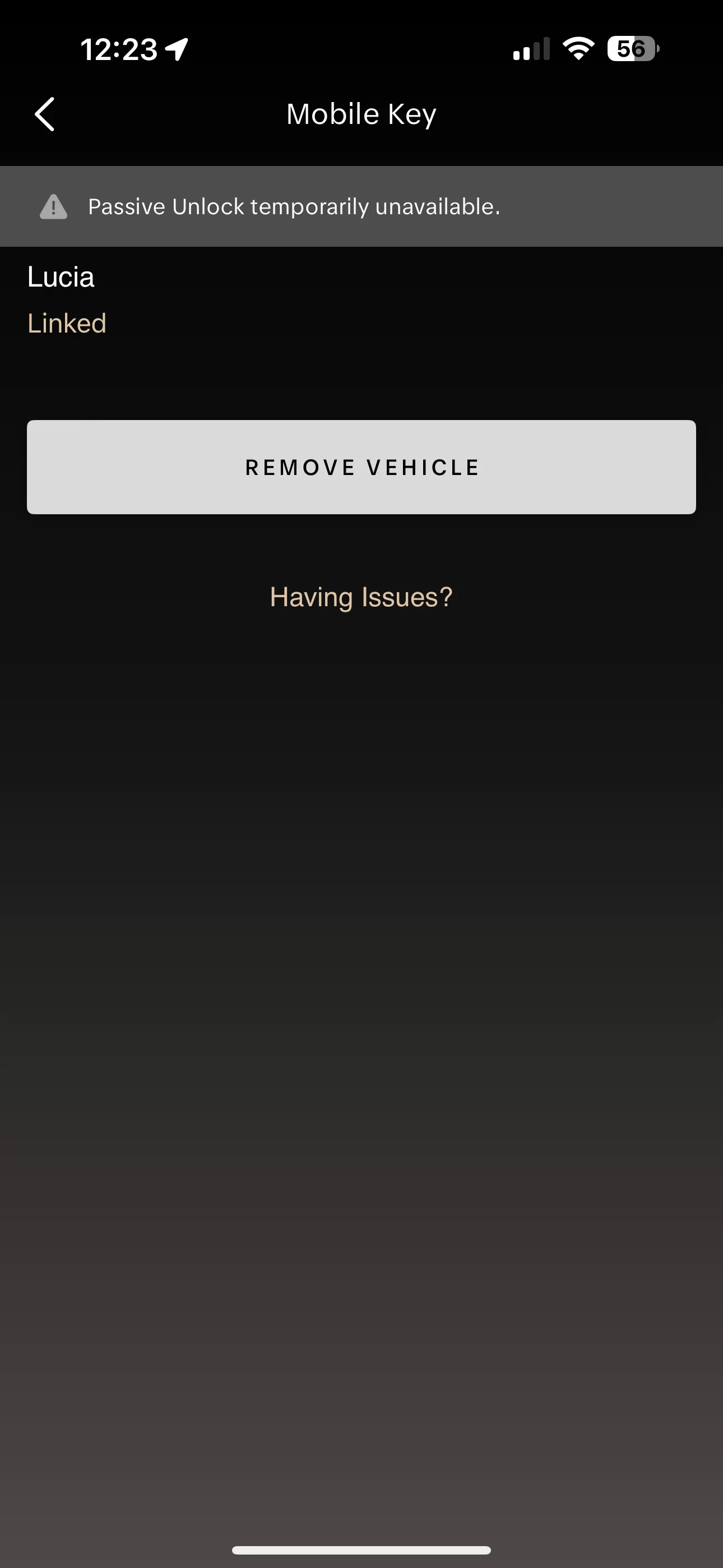

Just curious if any has seen this before? If so, what did you do to resolve it?
On the mobile app I saw a little orange dot in the top right corner over the mobile key icon. I clicked it and the next screen shows “Passive Unlock temporarily unavailable”.
View attachment 20289View attachment 20290
I started getting this (twice) after the new app update. 1st time it resolved itself after about 24 hrs. 2nd time I had to go to the car and "actively" unlock it. Haven't seen the message since (fingers crossed)

Ahhhhhh ok that makes a lot of sense. I was actually sitting close to my garage door and I could hear the car waking up a lot so that’s probably what happened. Thx for the info.
Passive unlock will be temporarily disable for 4 hours if the vehicle is passively unlocked 10 times and no doors are opened. After the 4 hours, if the doors were never opened, and if the vehicle is passively unlocked 1 time (once) and doors were not open, passive unlock will be disabled for another 4 hours.
When this occurs, if you press in on one of the door handles with a key present it will unlock.
