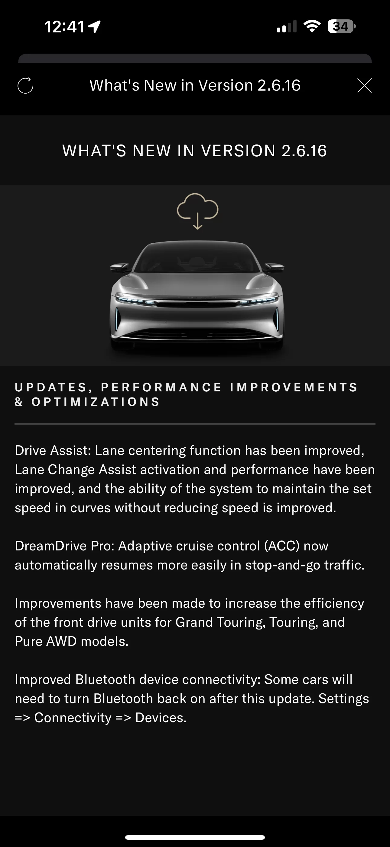

OTA Update 2.6.16
Wanted to pass along some intel I got from the Lucid rep test driving the Gravity today in NY
He said they are, in fact, working on a “massive” software update to bring the Air closer to UX 3.1 capabilities. He said it may include the ability to switch the range estimator from the EPA rating to a “dynamic” estimate based on your actual miles/kwh 🙌
Also: He claimed that the Tesla supercharger adapters should be available within weeks. He said owners will get an email with purchase details (so I guess they aren’t sending them out for free 😔)
2 new issues for me today: 1) on a lunch trip, got crazy good m/kw - like 6+ - but never over 6.21? Ie - I could be going downhill and letting regen feed it while at 6.08, and it would go up to 6.21 and stop? And 2) my change lane doesn’t work? I hit it and the msg comes up then switches to ‘hands on wheel’ but nothing happens!? (Used to execute pretty quickly once in the mode). Have not tried any resets yet. ‘23 touring, 30k miles, love it!
