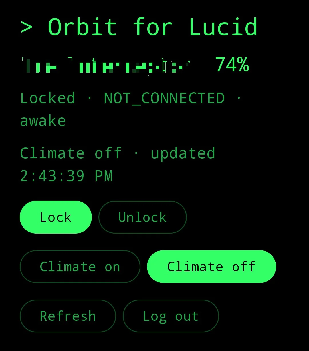

How it works: a Garmin watch can't talk to Lucid by itself, so there's a small Android companion app. The watch talks over Bluetooth (via Garmin Connect) to the phone app, and the phone app talks to Lucid's cloud the same way Lucid's own app does. There's no Orbit server and no account with me. You log in once in the phone app, and only a refresh token is kept, encrypted on the phone. The watch never holds credentials.

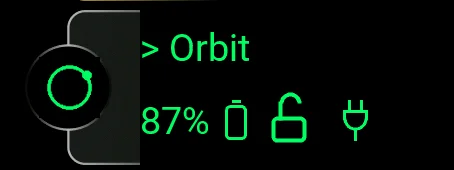

What works today (on my Venu 3):

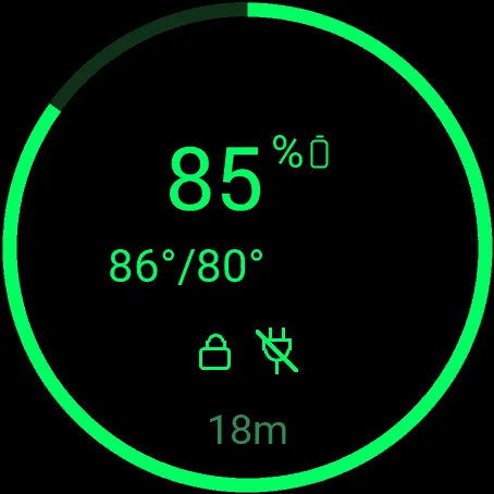

- Main screen: charge as a ring and big number, cabin and outside temperature (85°/87°), padlock, plug or charging bolt, climate-on icon, and how old the car's data is.

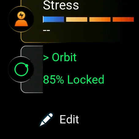

- Glance: charge and lock state in the watch carousel, without opening the app.

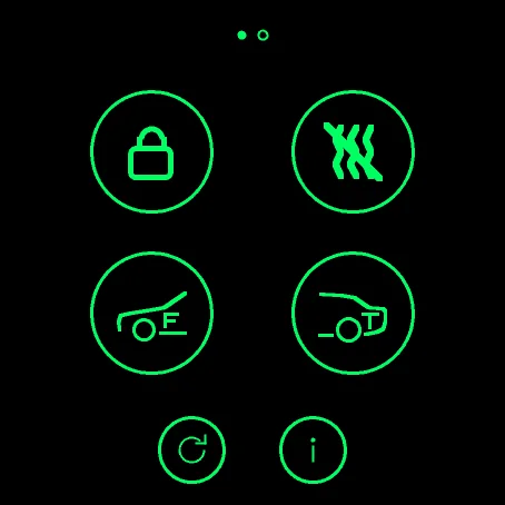

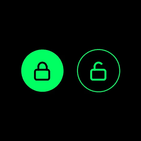

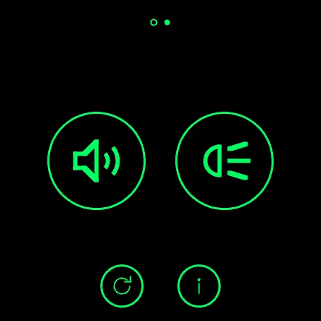

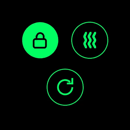

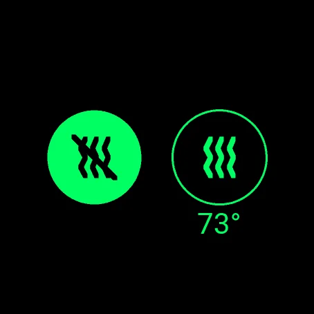

- Lock, unlock, climate on/off at a temperature you pick (in the watch's °F or °C), and refresh. Unlock and climate ask for a confirm tap. Lock doesn't.
- Wakes a sleeping car before sending a command.
- Stays current: every 5 minutes, while the watch is connected, the phone fetches status and sends it to the watch, even with the app closed. It never wakes the car, and a switch in the phone app turns it off.
- A read-only details screen: tire pressure, windows, battery health, min/max cell temperature.

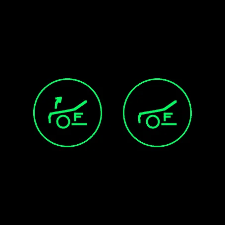

- Frunk and trunk open/close (with a confirm tap), on a second page of actions.
- Battery preconditioning, seat and steering wheel heat, max defrost and max A/C.
