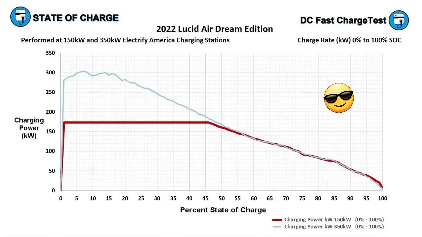

What is the maximum charge rate that you have seen?

You’re done with Lucid because you got 145kw max charging speed? What model do you have? GT or Touring or Pure? What were ambient temperatures? What was the lowest state of charge you’ve had when you plugged in? Do you have a L2 charger at home or only DC fast charge most of the time? It just strikes me as odd to be “I’d done with Lucid because I didn’t get the fastest charging speeds” and then provide zero specifics. I’ve gotten 301kw on my GT and 220kw in freezing temps on a properly pre-conditioned battery. My local EA is crap though and I’ve never gotten above 172kw even on their 350kw chargers. But that’s because EA is erratic, not Lucid.Reviving this thread. I have leased a lucid about 1.5 years ago and have never seen a charge go above 145kW…..ever. I just have 1 month to go in the lease and am dine with Lucid.
