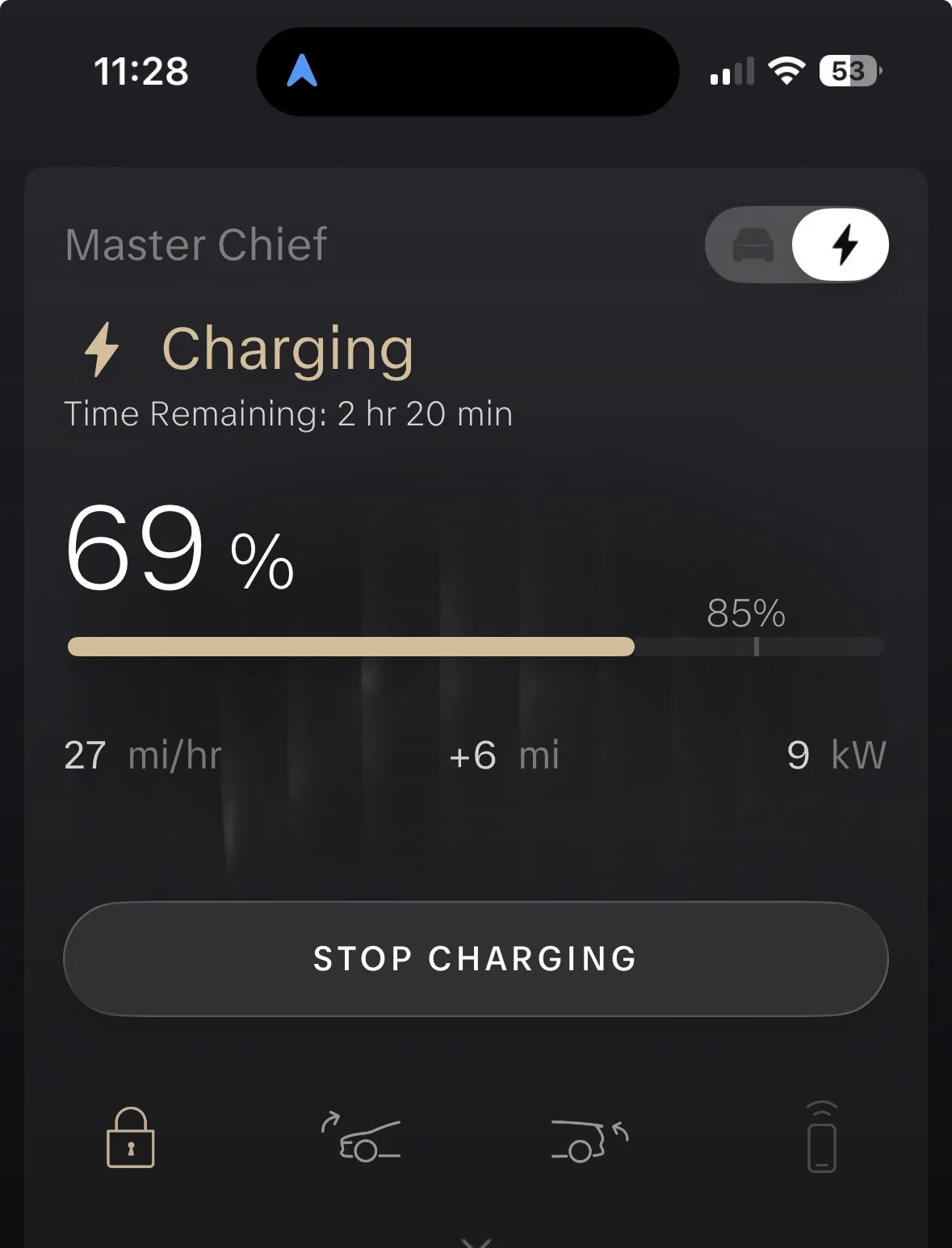

Lucid’s website states that the mobile charger can add up to 40 miles of range per hour on a NEMA 14-50 plug. However I am only getting 27 to 28 miles an hour of range added. The car is set for 40 amps max charge rate, is this normal? I understand the “up to” part, but this seems like I am not getting all the juice I should be getting.
The miles gained are based on dynamic range I believe, so the mi/hr may vary, but the kw should be consistent. I'm not 100% sure on this, but that's been my observation
[…] However I am only getting 27 to 28 miles an hour of range added. The car is set for 40 amps max charge rate, is this normal? […]
Yes, this is perfectly normal. Your charge rate is 9 kW, with 9.6 kW being the maximum at 40 A (40 A x 240 V). The display isn’t show fractions.
The miles per hour is based on your dynamic efficiency and how you drive. If you get 3 miles/kWh vs. 4 miles/kWh, you’ll be gaining 29 miles/hr vs. 38 miles/hr for the same 40 A charge rate.
The ICE equivalent is like pumping gas at 10 gallons per minute. In a 20 MPG car, you’ll be getting 200 miles/minute vs. a 30 MPG car where you’re gaining 300 miles/minute.

To be more clear, because home voltages vary anywhere from 220v-240v (and that’s only on average), the rate can be anywhere from 8800 W - 9600 W, or 8.8-9.6kW
Or even down to 8kW on 40A if you have 208V service and some sag, like I did at my old home and at work
