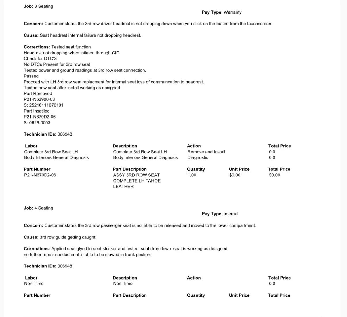

The bigger issue was my third row driver side headrest would not drop when clicking the button on the touch screen. They had to replace the entire seat to get that fixed 😳
The seats have an electrical connection in order for that to work; given the seats likely are manufactured by a 3rd party, I suspect it is simply easier to swap the seat and send them back the broken unit for refurbishment/replacement (or trash it, I guess) than it would be to 'fix' the seat.
