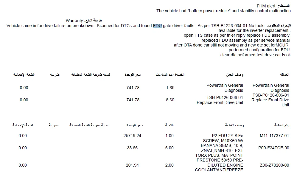

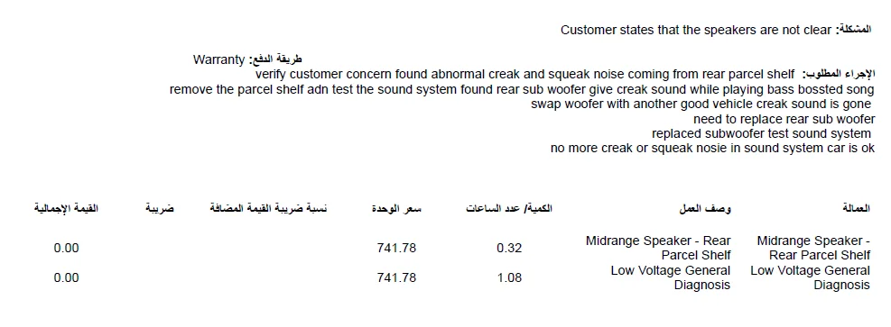

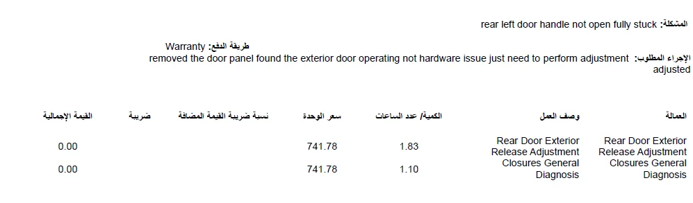

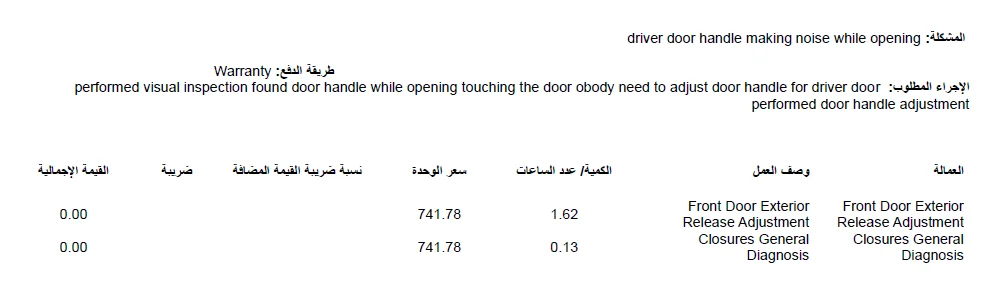

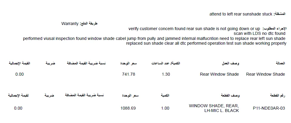

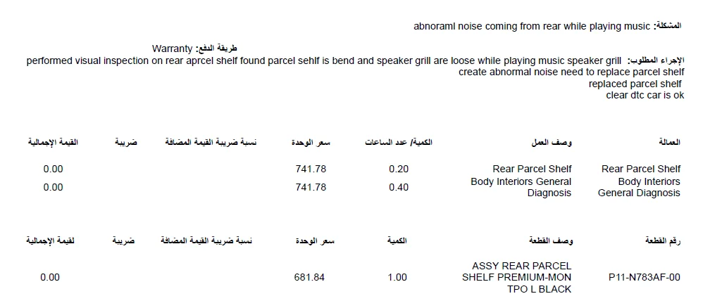

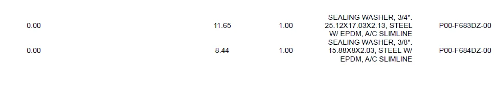

I would like to share the work that was done to my car 2 months back for front motor failure.
Lucid performed a lot of courtesy inspection and work beyond what I asked for. and did a bunch of replacements and fine tuning.
I would rate the service itself as 8.4 out of 10, because of the 1 month delay to get all done and not so great loaner. but the communication was excellent from their part and they were very clear that it will take time.
it would have been a perfect score if they arrange to fix the car within 2 weeks or less + arrange a loaner in 1 week time and provide a good loaner. I got US made air with US plug charger and the car was not suited for a great loaner experience. I still thank them for trying to provide the best experience with the available resources.
these are the most notable services

What were the symptoms of the failure? I had drive fault and loss of power. Saw on the work order it said Rear Drive Unit Overcurrent. Car has been in for one month and, from their weekly text updates, no one has touched it yet. It’s out in the front large lot, not even the service lot.
