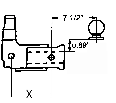

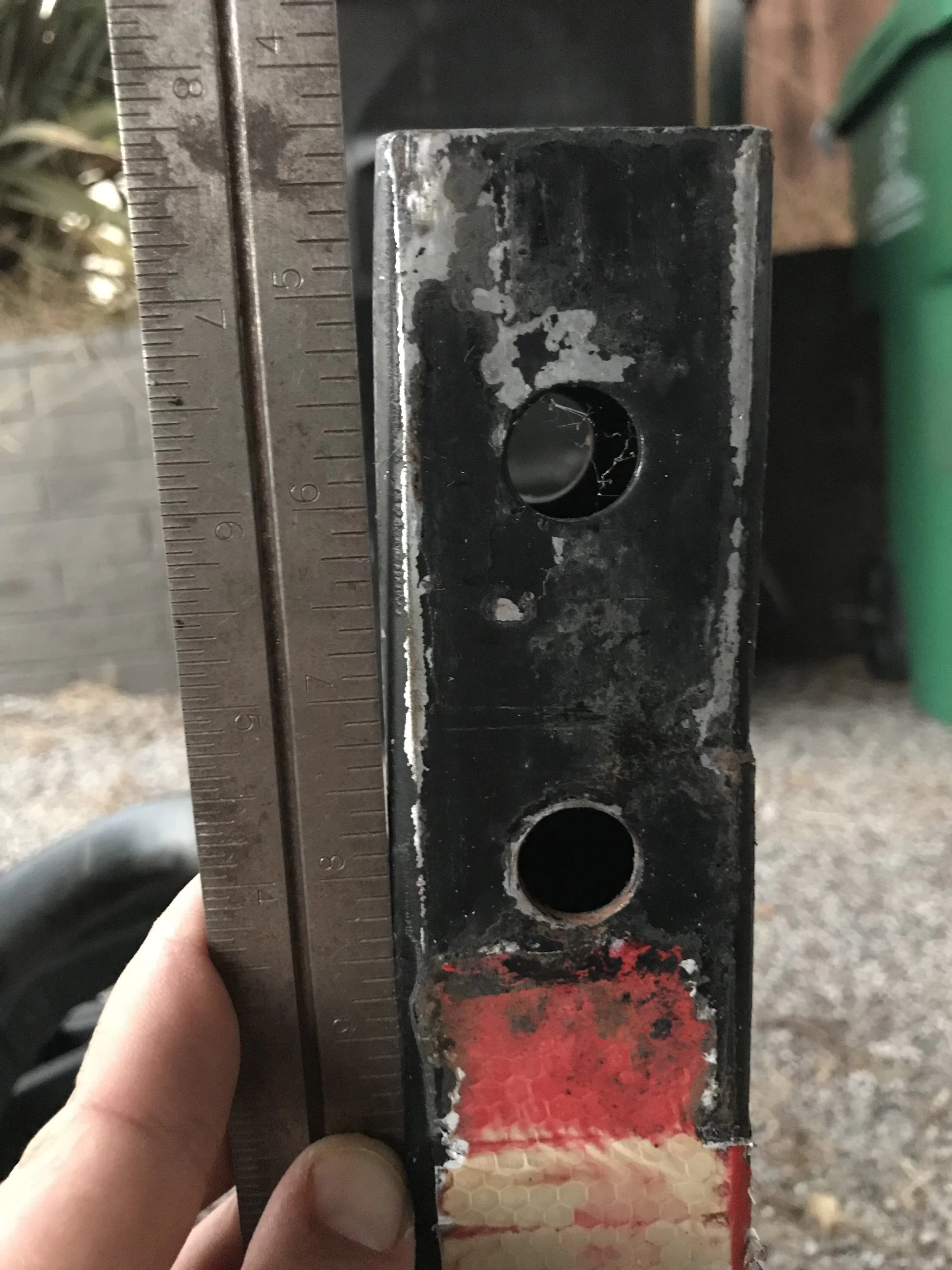

Was wondering if you could measure X below. I'm guessing the left hole is centered below the vertical pin part and the picture is distorting it. If it's not centered then I'd rather have horizontal distance to the center of the pin part. Scaling your picture I'm guessing about 5.5 inches. With this number you can figure the maximum moment the receiver wants to see which will be (X+7.5)*600LB.
With 5.5 in for X its 7800 in-lb. With this number you can get a guess at the equivalent load for any distance.
So the Lucid picture towing the Airstream trailer I measure a pin to ball distance of ~17 inches. 7800 in-lb/117in = 459 lb. That AirStream mini has a max tung weight of around 440.
The 110 pounds Lucid gets from somewhere equates to 7800 in-lb/110 lb = 71 in. ie approx 6 ft. Perhaps rotation loads around that pin make the difference?
