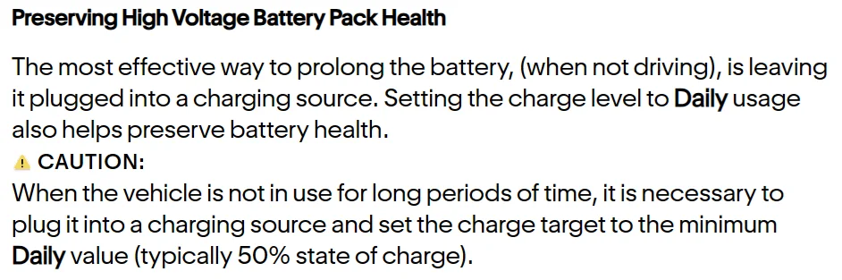

65% makes more sense for daily use, but the manual states 50% for storage:
