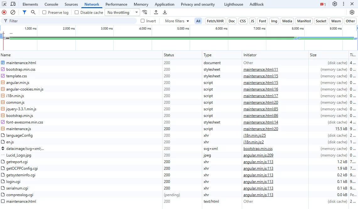

@borski if your LCHCS web interface is working 100%, can you go into browser dev tools and check what is returned by the compresslog.cgi fetch? I suspect it's the filename of the compressed log. I'm trying to determine the format of that path, and to see if it's static or dynamic. If it's static, then I might be able to fetch the compressed file myself, depending on the mechanism which is creating it.
Failing that, can anyone who DOES have a a working web interface go to the maintenance page, press F12 in their browser, go to the Network tab, then refresh the page? You'll see 'compresslog.cgi' as one of the requests. Wait for it to go from "(pending)" to being complete, then click on it and visit the RESPONSE tab to see what came back from that request. If you can post the filename that's returned, I'm trying to determine if the resulting compressed file has the same name everytime, or whether it's entirely dynamic, or static with a timestamp, perhaps.

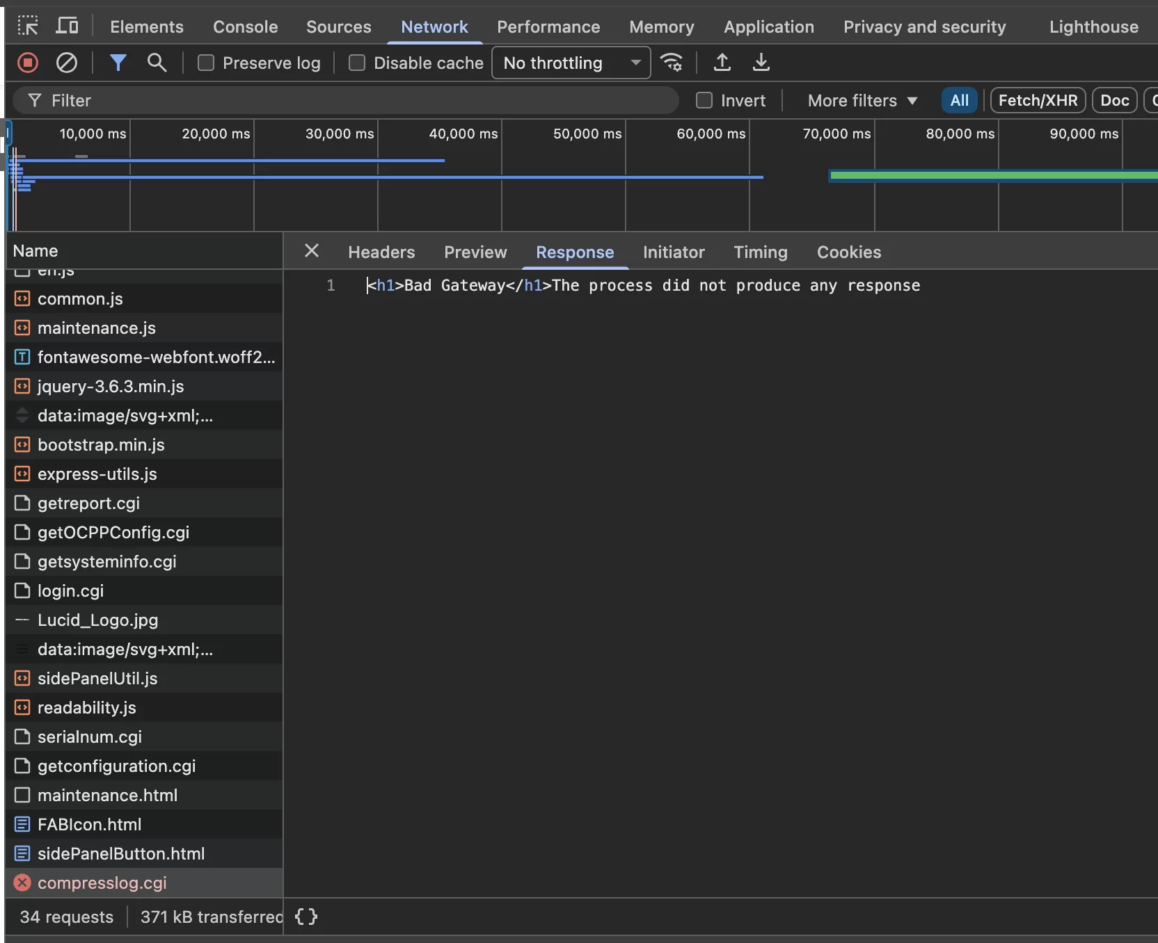

Below is the information I see based on what you requested.
