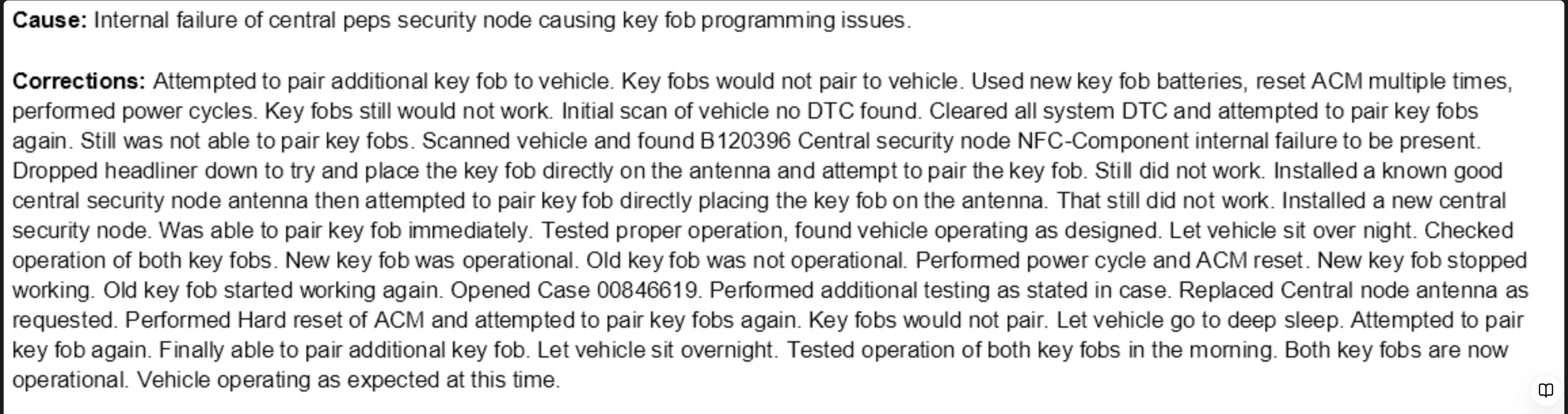

I took ownership of a new Air Touring in December. The car has been flawless and a joy to drive. Lucid gave me an I.O.U. on delivery for my second key fob which was supposed to be done in the Plainview NY service center this week stating Monday. I am sort of puzzled how pairing a key fob can be a multiday process and still may not be possible. I'm not throwing shade on the service center, as they have been honest and are certainly trying to get it done ASAP. Pairing a Tesla key is a 2 minute DIY home process. What is so special about this key that it literally takes hours/days at a service center to get it to talk to the car?
