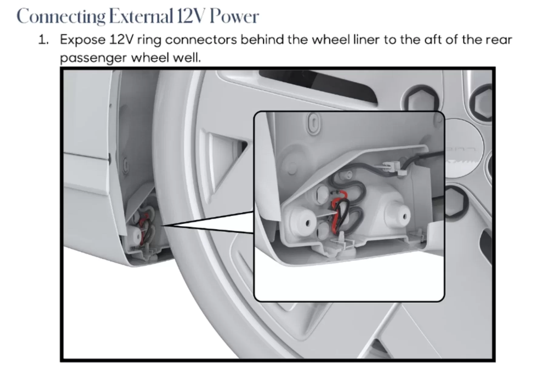

When we were moving items from our old ICE car to the new Gravity I left the jumper cables behind as being "no longer necessary". But I now know there is a completely separate 12V system in the Gravity. This morning my sister-in-law needed a jump start on her ICE car. So... does it make sense to carry a set of jumper cables? How would you jump start someone else? (I'm not even sure where the battery connectors are.} Or would you ever need to get a 12V assist from someone else?

I don't know about the Gravity, but on the Air, you can access the 12v external power terminals behind the wheel liner aft of the rear passenger tire. See the image below...
