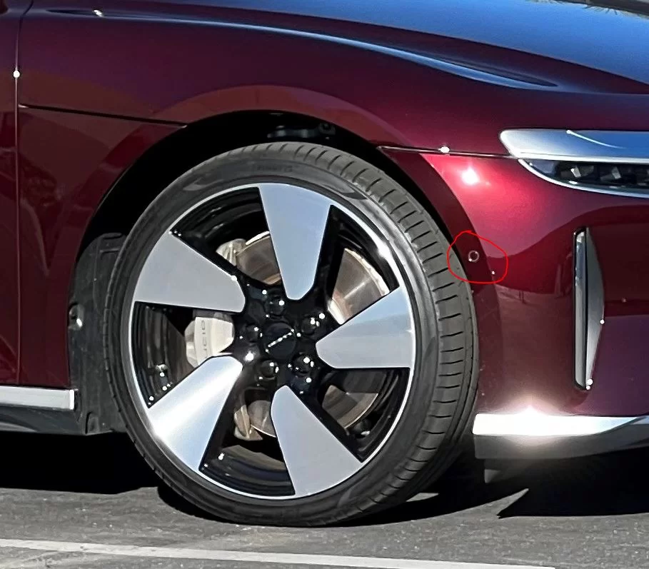

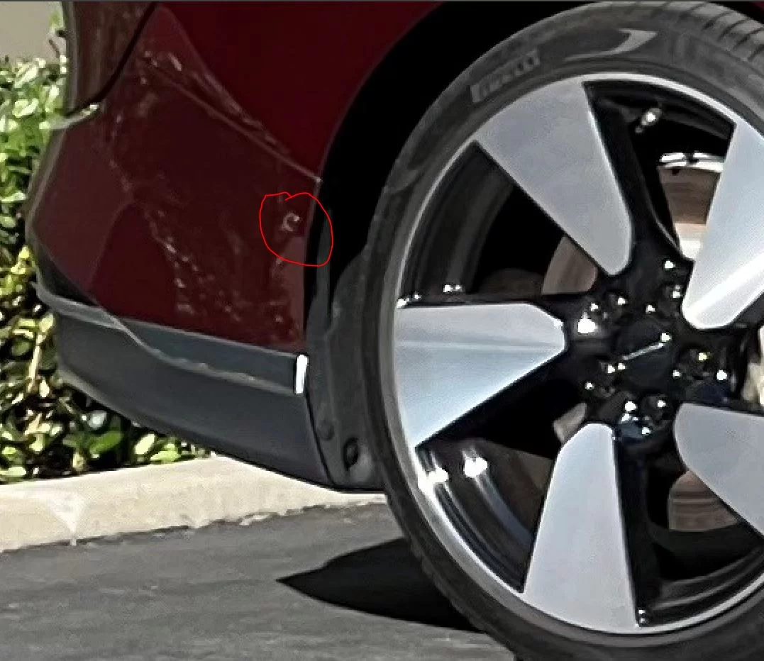

My Air doesn't have any sensors located in the area covered by the Sapphire fender flares . . . at least no sensors that I can see, such as the ones in the bumper.
Very interesting ... I guess those were installed for cars with DDP?
