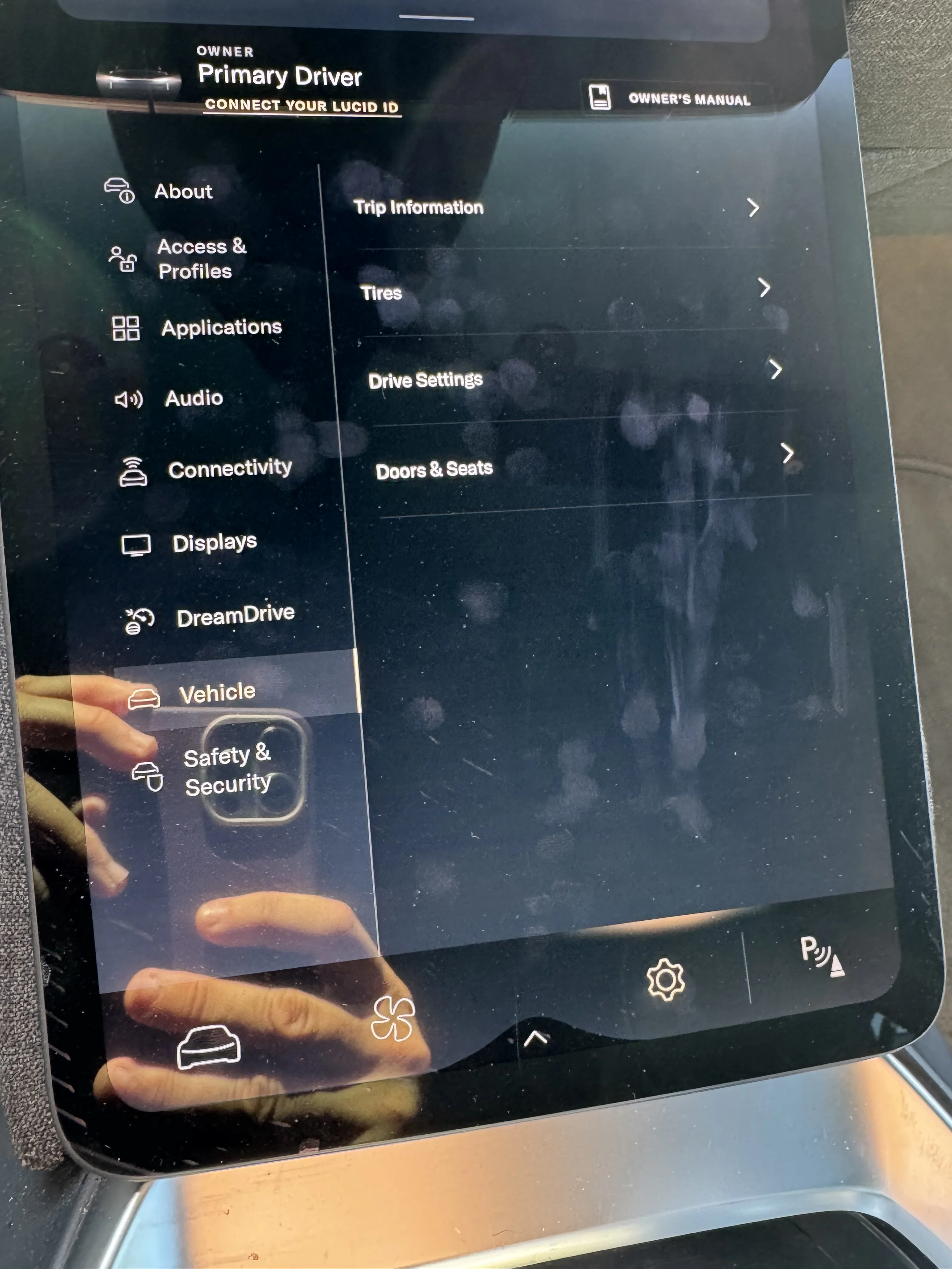

However it’s stuck in Transport Mode, and I’m unable to reach service. The driver didn’t know how to turn it off.
There’s no mode I could find in the settings.
Does anyone here know how to turn that off?
Under Settings > Vehicle?
Settings > Vehicle and toggling Tow Truck Mode.

I saw that but setting doesn’t exist 😭 then it asked for a PIN and said Fob not detected, but it seemed to be driving ok until I hit 30mph and it wigged out

Edit: this is “Transport Mode” not tow mode.

I got ahold of service finally, they don't know why its in transport mode. It has to be remotely turned off, the driver can't do it. I was already an hour late to work so I just left the car.
So if anyone finds this googling, this cannot be enabled or disabled by the driver, only Lucid service.

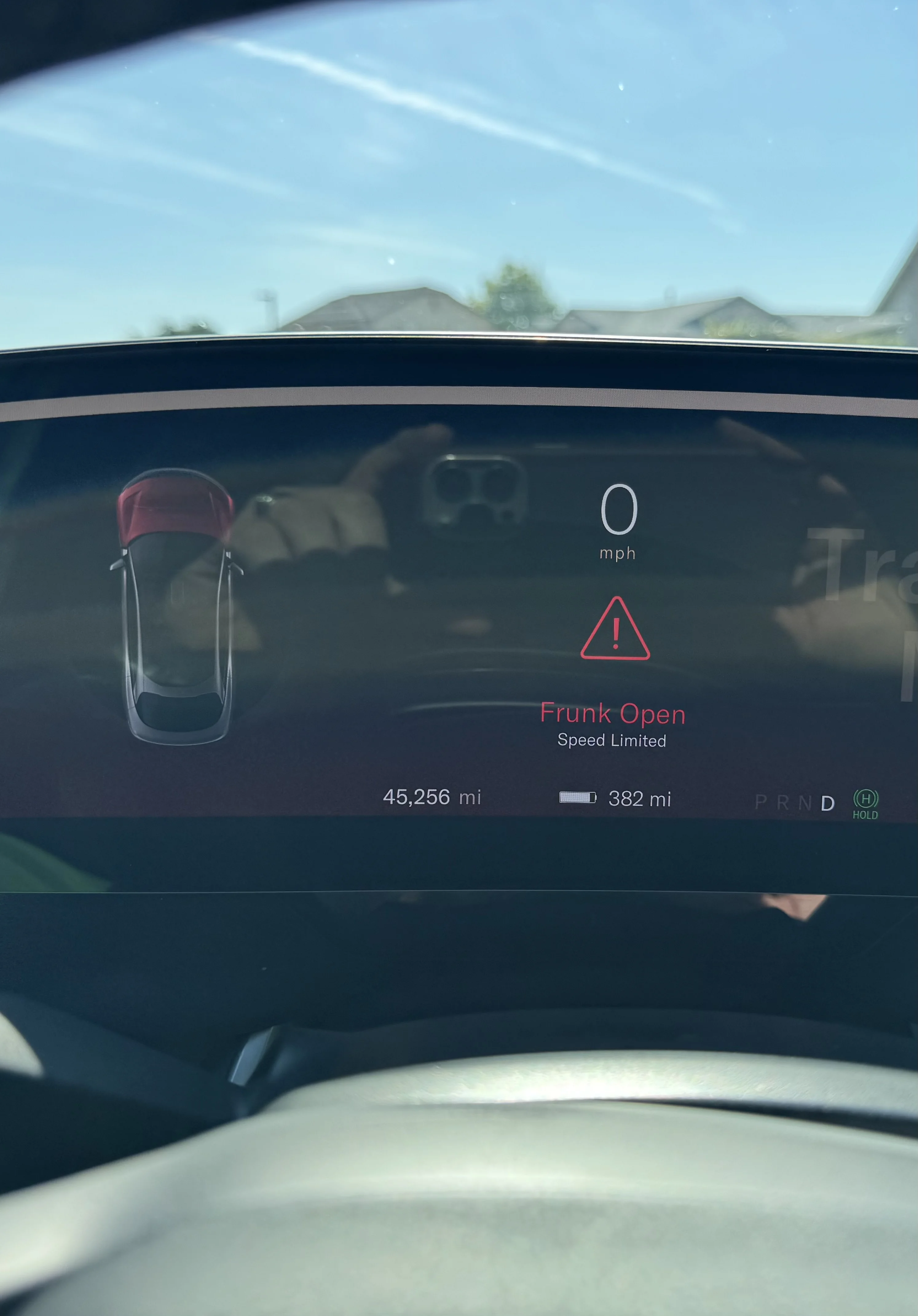

Anyways, grand finale, for future googlers: "Transport Mode" is a special mode that can only be set by the Service Department. It is not required for shipping. It can only be turned off by the Service Department. This is different than Tow Truck mode. In Transport Mode, the vehicle can only go 30 mph, accelerates slow, and does not have any driver assistance. I am working with service to schedule a time to do the prep on the car here so they can remote in and do it there. The frunk issue is unrelated.
The end.
yeah. It still breaks every time its opened, but yes. Why did Lucid send it like this? Who knows!
The latches need adjusting/replacing. All you’re doing is manually latching it when it doesn’t. That’s all.
It doesn’t “break” when it’s opened. It was never fixed. You are simply manually closing the frunk.
