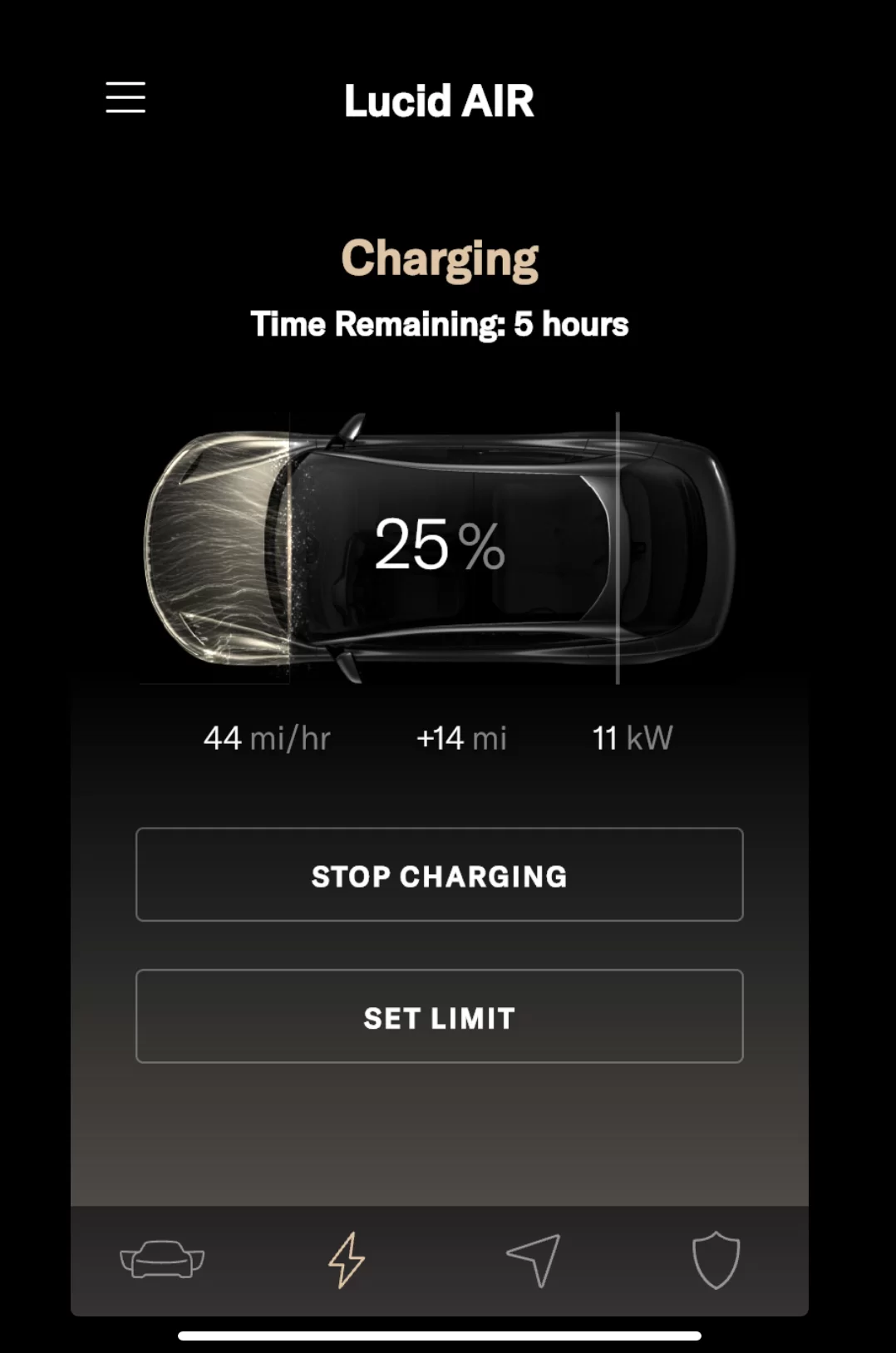

How many miles /hr are you guys getting on your home charger?
nautchilous
Apr 14, 2022
252
206
Richmond TX
Lucid Air Touring
So I charged up my Touring for the first time on my Wallbox 48 amp home charger…..The unit is connected to a 60 amp circuit….I really wanted to get the Lucid unit but the cost to upgrade to the 100 amp circuit was crazy….i am getting about 44 miles an hour…And this is getting powered by my solar panels …Not bad 😊
I am curious to know what the guys who are charging on the 100amp Lucid charger is getting?
They'll be charging at 80/48 of your rate, or 19.2kW instead of 11.5 kW.
