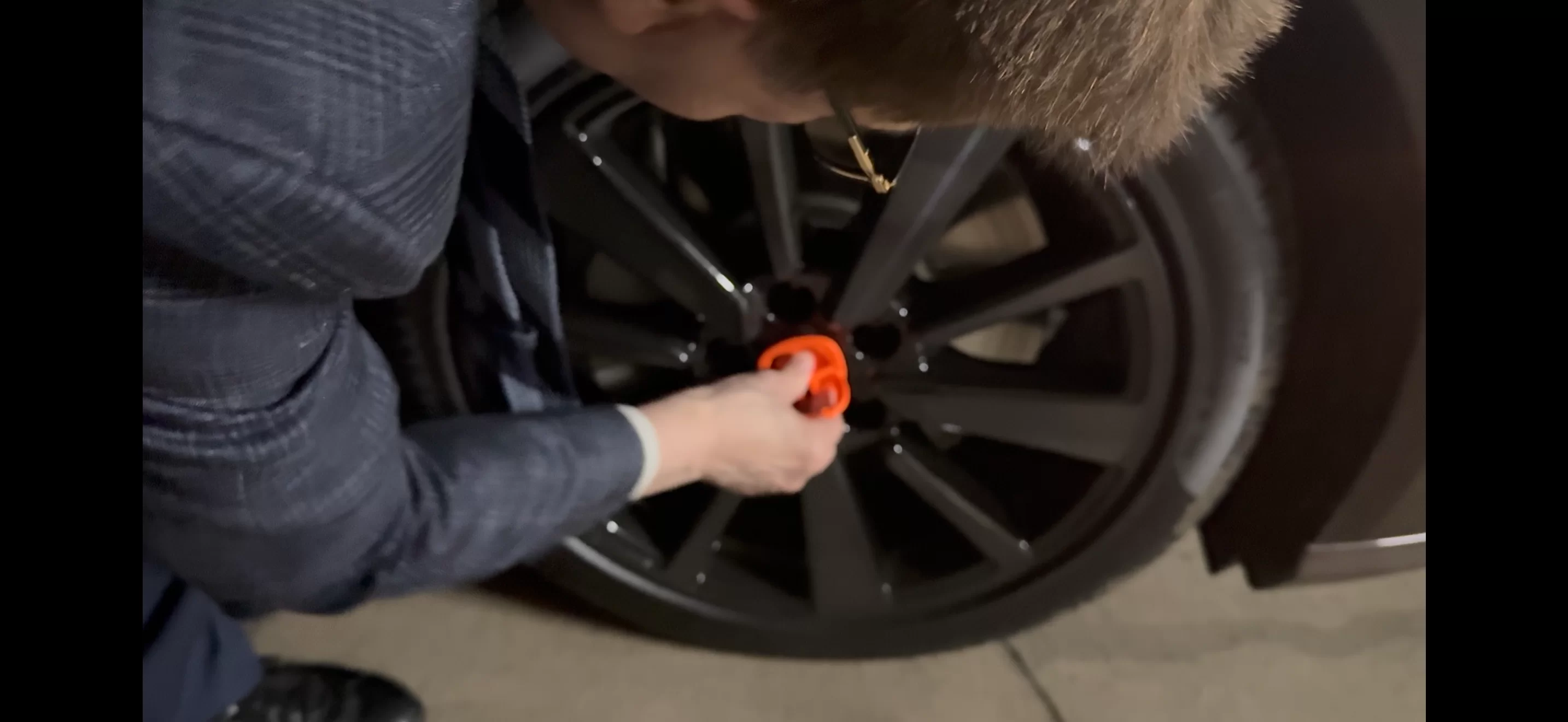

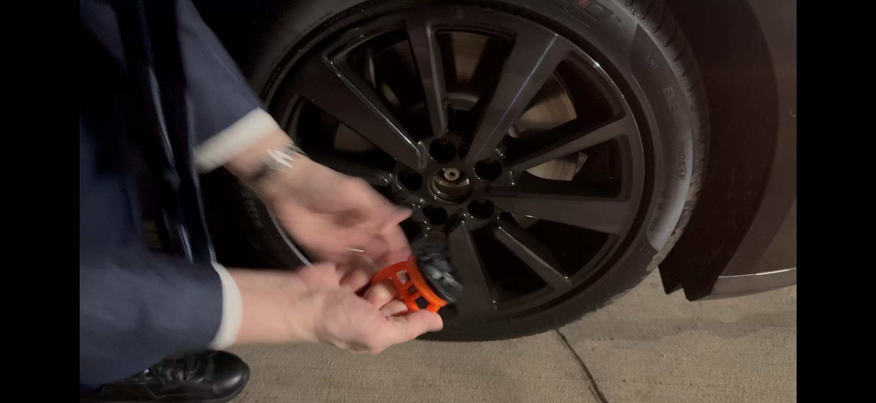

The center caps come right off with a small dent puller. $10 on Amazon. I haven't tried the lug nut covers. Anyone have a good solution for those?
The lug covers pop right off as well, there are basic tools like https://www.amazon.com/dp/B0C61QXJSW or you may already have something that looks like that (I did, in a PC repair toolset).
