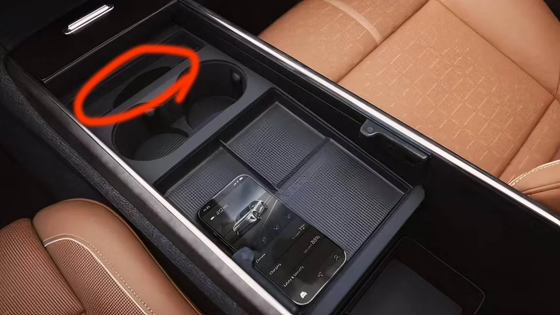

Where is that key fob slot ? Any picture of it please
