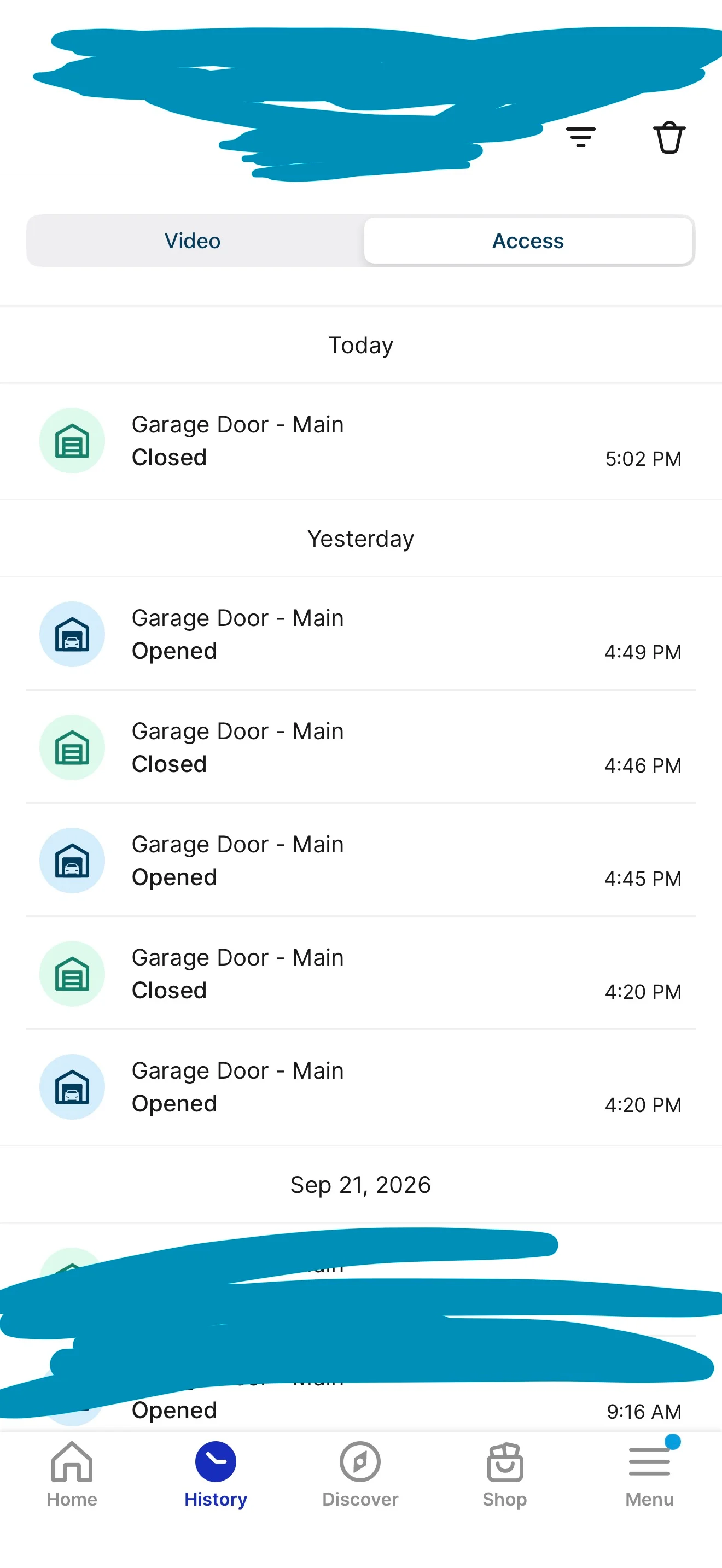

Hi everyone, I wanted to see if anyone else is having this issue. I have homelink configured on my gravity (had it on my air, have it on my taycan, have it on my 4rs) and I have noticed (or not noticed really) that for whatever reason, the gravity stores failed attempts of opening the garage. Or at least thats what I think is happening. Whenever the key comes back into range to unlock the car, it sends the command and it opens the garage door without me noticing. This has happened 3 or 4 times but just happened again last night and many times I don't notice that the garage door is open until the next day as I work from home and so does my girlfriend.
As you can see, I came home yesterday at 4:45 PM, closed the garage at 4:46 PM, and then the car triggered an open at 4:49 PM which I missed. I didn't realize that it was open until today at 5:02 when I finally went out to the garage (yes I know I live a sad life given I didn't go out to the front of my house or garage for over 24 hours).
Is anyone else experiencing this? If someone doesn't walk into the house and kill me overnight then my girlfriend definitely will next time this happens. She is furious about it and I am trying to not let it affect our Gravity ownership but she is starting to feel a little unsafe because of it. Understandably so.
I don't think its a me thing given I have had so many other cars setup with homelink but maybe it is? Just trying to see if this is indeed a bug that others are noticing or if its a layer 8 problem.

A couple of other people on the forum have noted exactly the same issue @marqie
I’m seeing the same problem as well. I have bears around so I’ve cleared all garage door codes from my Gravity and put old fashioned openers back in my car.
Ahhh I thought I saw something on the forum but couldnt find it. Thank you!
Yeah I think I will probably do the same. Simple fix for now until its fixed. Silly we have to do it but oh well. I would love if Lucid would acknowledge it at the very least and give a timeline on a fix.
Yup this is happening to me too
Thank you for the confirmation. Layer 8 problem averted!
Yes, it happened to me on 9/7/26. . I immediately reported all the details including time stamps, etc. to Lucid but have not heard anything back.
I also posted on the forum.
This is a huge safety concern for me.
