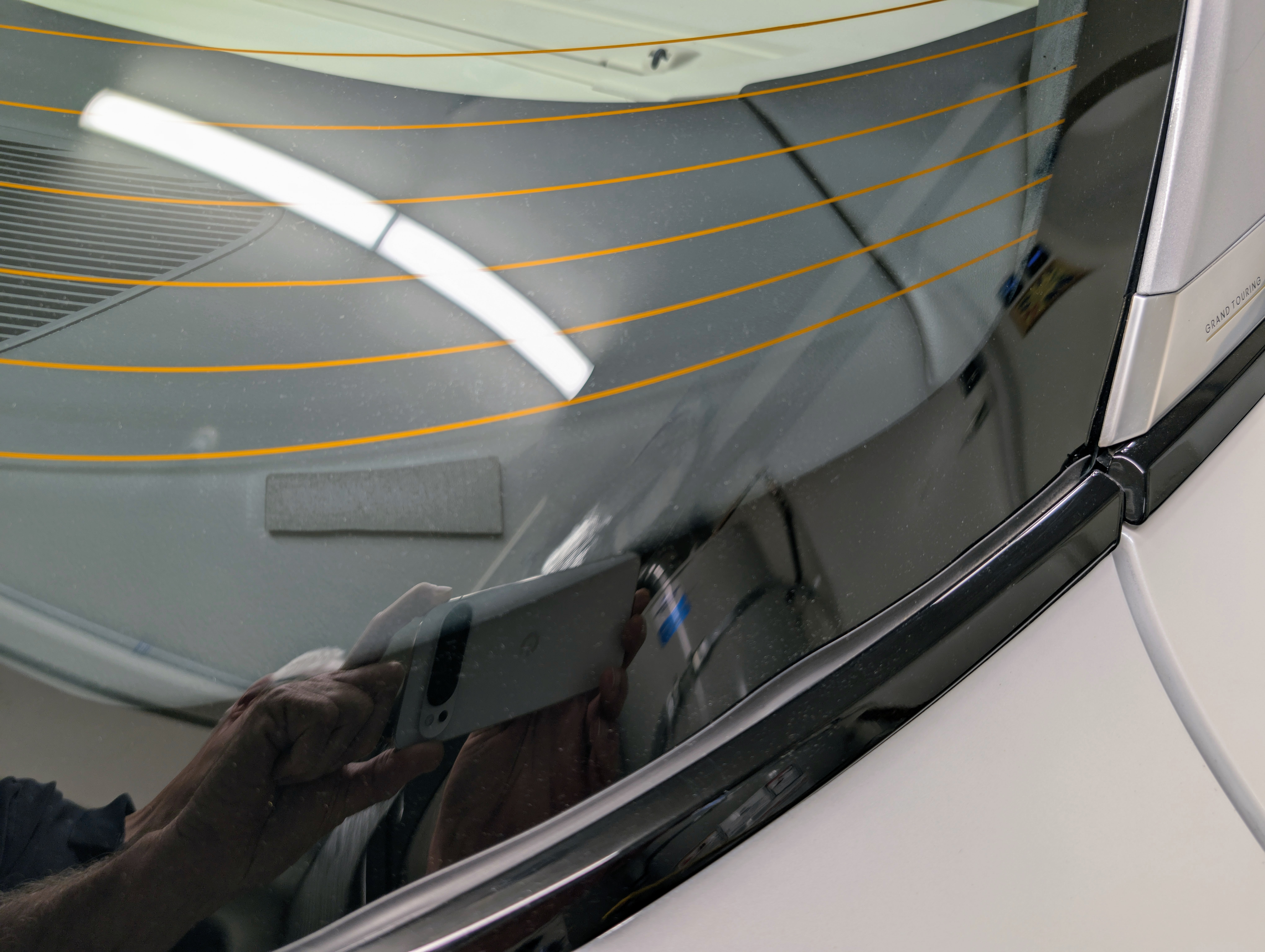

If you want to address it in the meantime, you could buy this neoprene foam tape, cut it into several small pieces, and wedge it between the back edge of the parcel shelf and the glass. Be careful to avoid scratching the rear window heating elements! I bought the 1/8" x 2" tape, but I think the 1/8" x 1" tape would be as good or better.
A piece of the foam tape is visible above the reflection of my phone in this photo:
