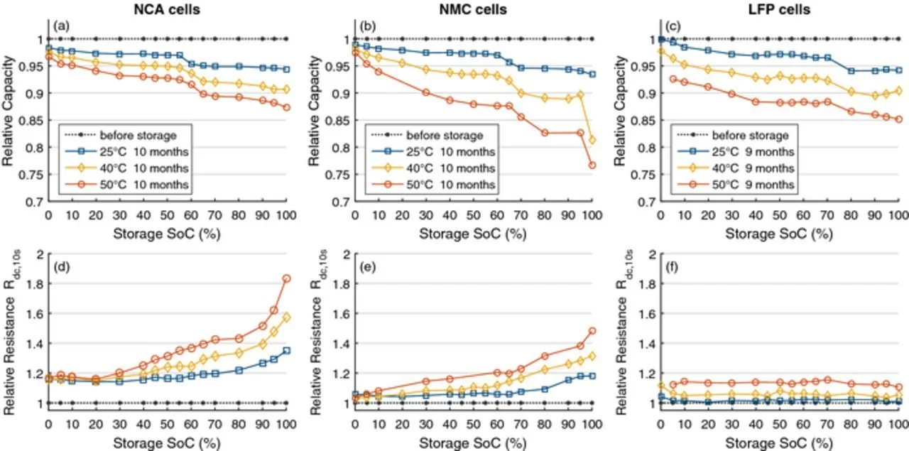

Off topic and perhaps already covered elsewhere, but as 80% and 60% charge limits are mentioned: I suspect 60% is noticeably friendlier for long term battery degradation for those that can swing it. Lucid’s cells are likely similar to the NMC in the middle graph.

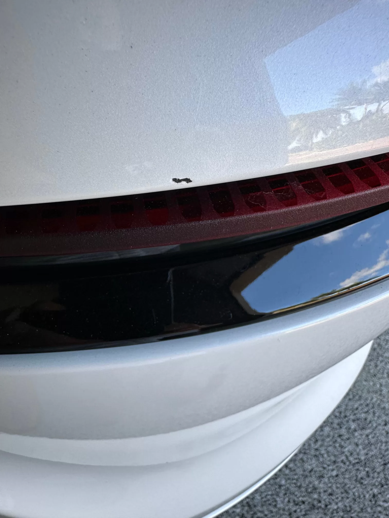

But our third Gravity Dream Edition was delivered around noon today (replacing our second one which was wrecked), and I got tied up with all its programming. So far so good on that one, except that there were two tiny paint nicks just above the left rear taillight. They're pretty tiny, and since we're going to have the car wrapped before putting it on the road, I'll just use an off-the-shelf generic white paint pen first. Not a showstopper as the PPF will mask any mismatch, but it should have been caught at the factory or pre-delivery inspections.
