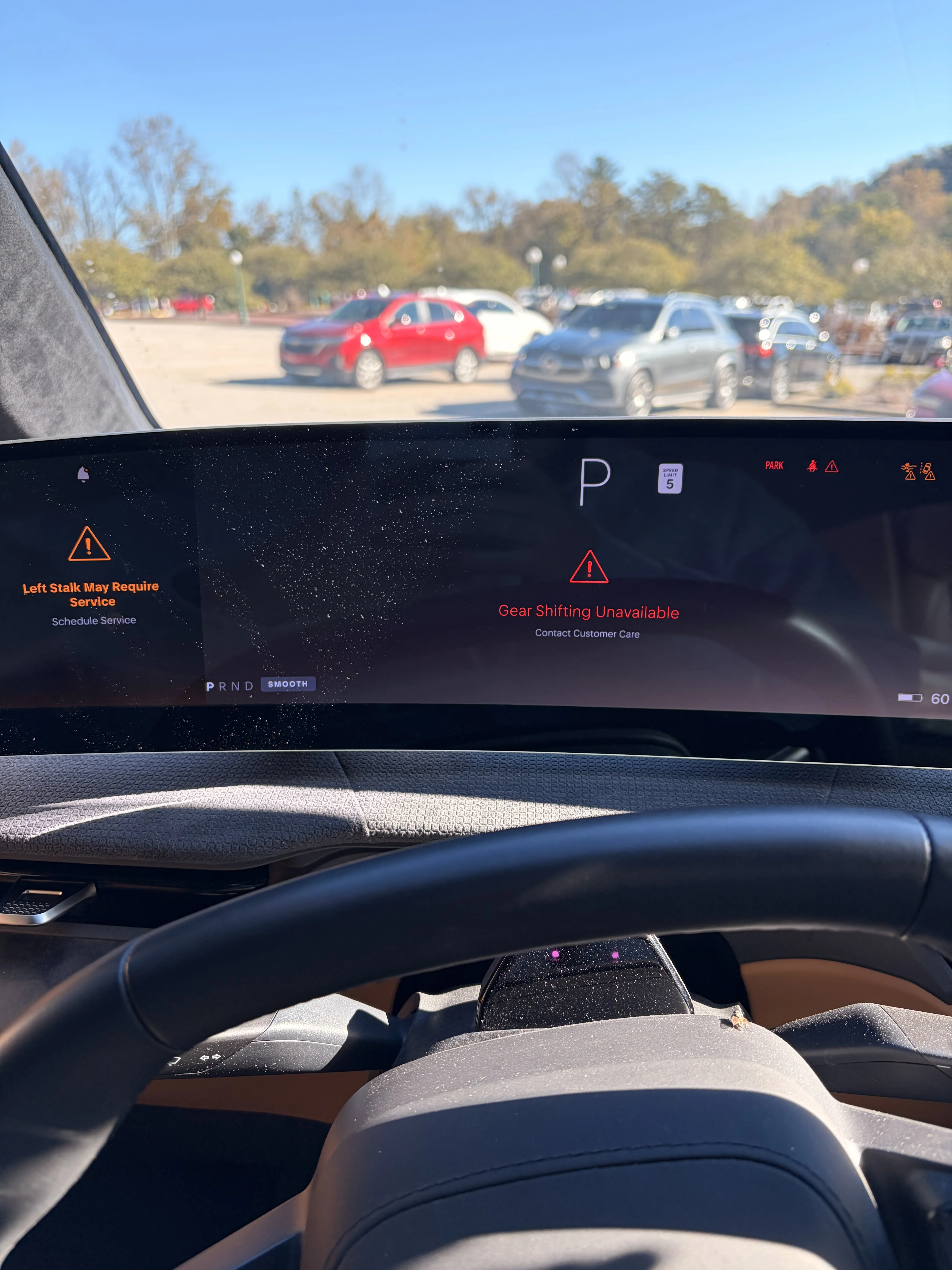

Anybody got these errors before?
Interesting, as gear shifting is on the right stalk.
Maybe a reboot and contact service.
No but can you try a reboot of the car? Press and hold the X and Microphone buttons on the steering wheel and press and hold the brake for about 10 seconds, till you hear a bing. It may clear it IF it’s a temporary thing. But yes unless someone else has a better option this may help for the moment.
The X microphone brake reboot is infotainment. This error is not part of the infotainment. I would reboot by letting the car sleep and reset. Lock it and walk away for 15 to 20 minutes keeping the keyfob away from the car. Then come back and see if the error is still there.
If sleep is the solution didn’t @borski say it should only take a few minutes to get to that point rather than 15-20 minutes.
I was also under the impression that holding for a second bing was a different level of reset.
Still learning new stuff so always up for instruction.
I’ve heard of this, you’ll need to go to service.
Weird error message too. Left stalk is the turn signal…
Right! Super odd message but lucid service has been helpful so far… in BFE Indiana and they are sending a tow to get it to Goose Island service center.

Well now went back an hour later and all errors cleared. Maybe it was just software?
I wil say this is the second time (very far apart occurrences) that we have charges on a slow charger and the charger kicked off THEN we got a bunch of errors. Both times ended up clearing themselves though.
