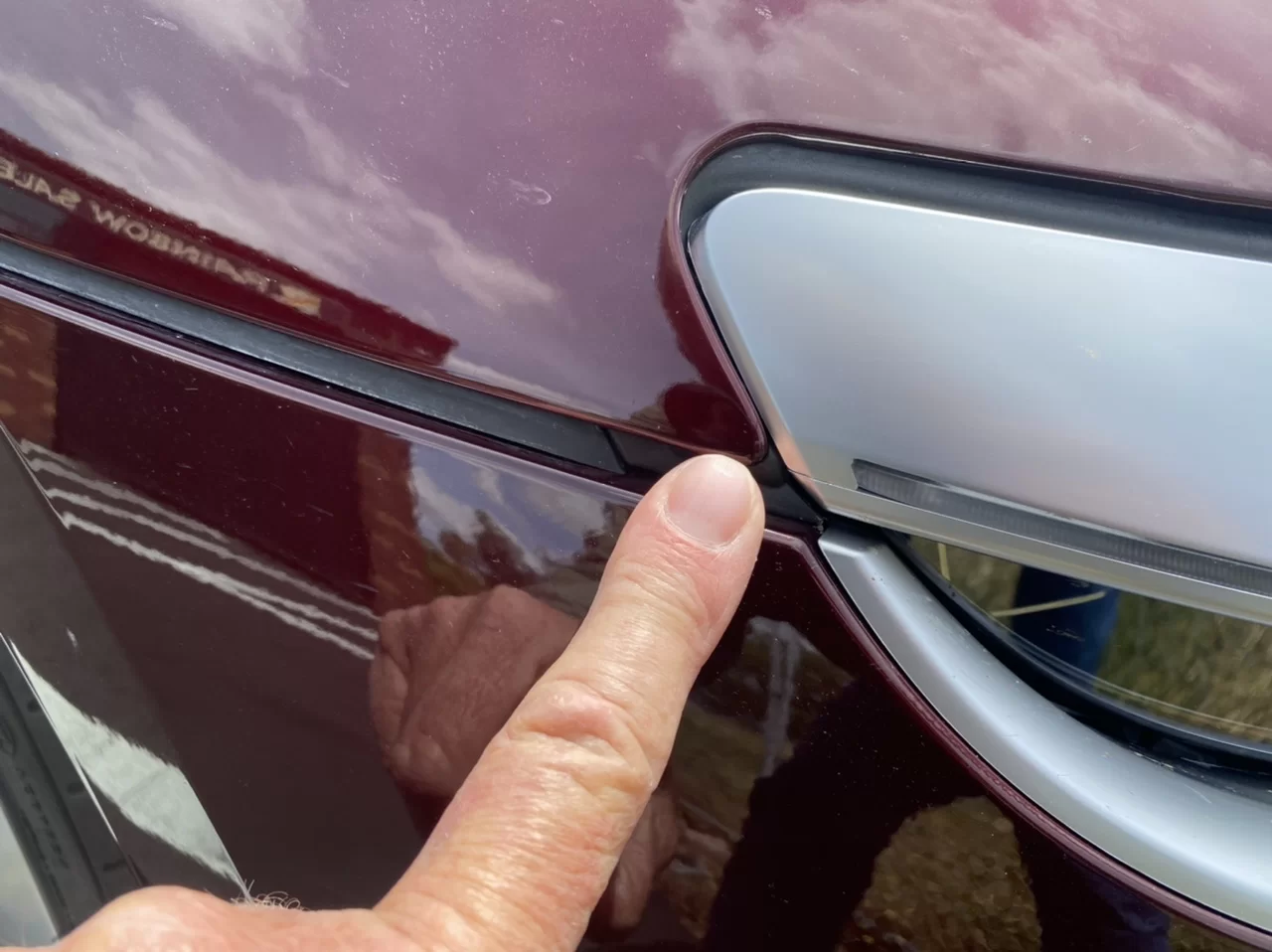

Guy came out to replace trunk weatherstrip and also adjusted the front trim piece that the corners of the hood were catching on. It had put tiny chips in the paint. I said just send me some touch up paint. Still love the car.
