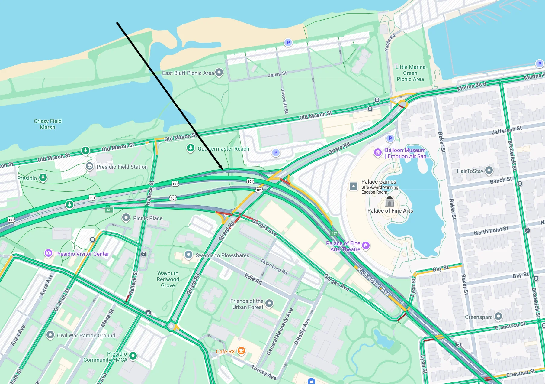

**UPDATE**. chatted w/ SC today in Millbrae, and we're going to 'wait and see' since this happens in only one specific spot on the road (100% reproducible). That being said, if there is anyone in the San Francisco area and would like to try w/ their GT.
this is exactly where it happens when I accelerate on the onramp: 37.803637, -122.452239 (also see attached image).
would love to hear from anyone else, if it happens to you. the SC said that as long as the car feels safe.. i'm good.. and it does, just NOT on that onramp. :)
