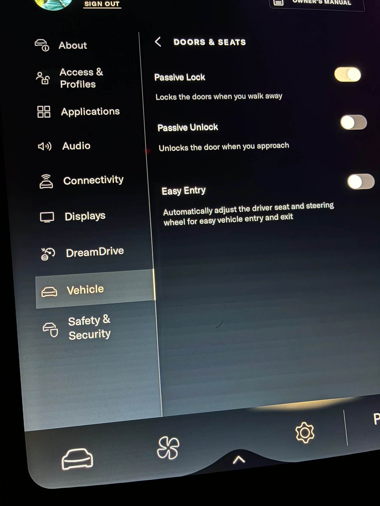

I'd be very surprised if the '23 MY didn't allow you to turn it off. Can you post a pic of the menu where it's missing?
I just checked mine, it's the last option in the Doors & Seats menu:
settings (gear icon) > Doors & Seats > Easy Entry to disable / enaable.
Just to help guide this new owner, note that as the image shows, there’s one missing step in DS9’s menu navigation instructions….
Settings (gear icon) > VEHICLE > Doors & Seats > Easy Entry
The easy entry menu setting is only available on the owners profile.
It globally affects all other profiles, so that everybody gets or everybody doesn’t get it.
