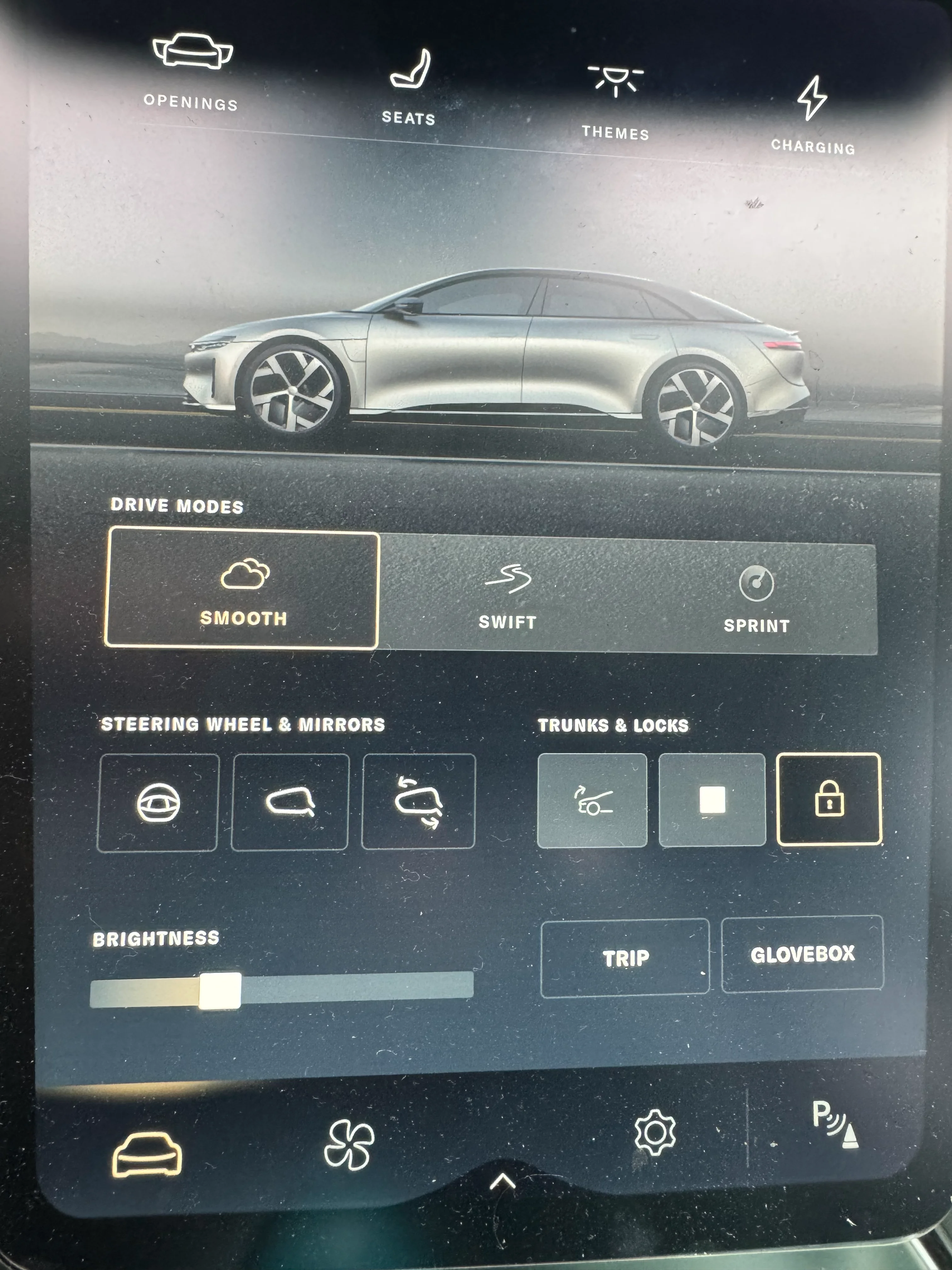

My pilot panel looked different with a square where the trunk opening icon was, and the car would not change drive modes. A hard reset using logo fixed the problem.
Yep, I experienced this too. The logo reset fixed it for me as well.
My pilot panel looked different with a square where the trunk opening icon was, and the car would not change drive modes. A hard reset using logo fixed the problem.View attachment 25111
Glad it’s resolved. FYI, the logo reset is considered a “soft reset.” It simply resets the infotainment system of the car. A hard reset would be the three button reset.
That square icon is a “stop” icon. That means that your car thought your trunk was in the middle of opening. I suspect if you had manually opened or closed it, that may have fixed it too. Glad a reset fixed it either way
