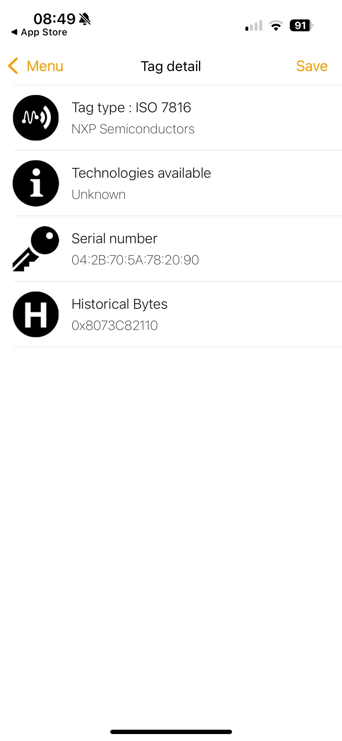

FYI, iPhones are always scanning for NFC tags but don't take action by default. You can create a Shortcut (in the Shortcut app) to specifically take action on any given tag, or install any number of free(mium) apps to scan tags. This is from "NFC Tools".
I just scanned my card and this perhaps explains why the fob doesn't work today -- the fob and card are different device types. As you can see below, the fob has an ISO 7816 tag from NXP. The card is a Mifare DESFire ISO 14443-4 tag (also from NXP).
