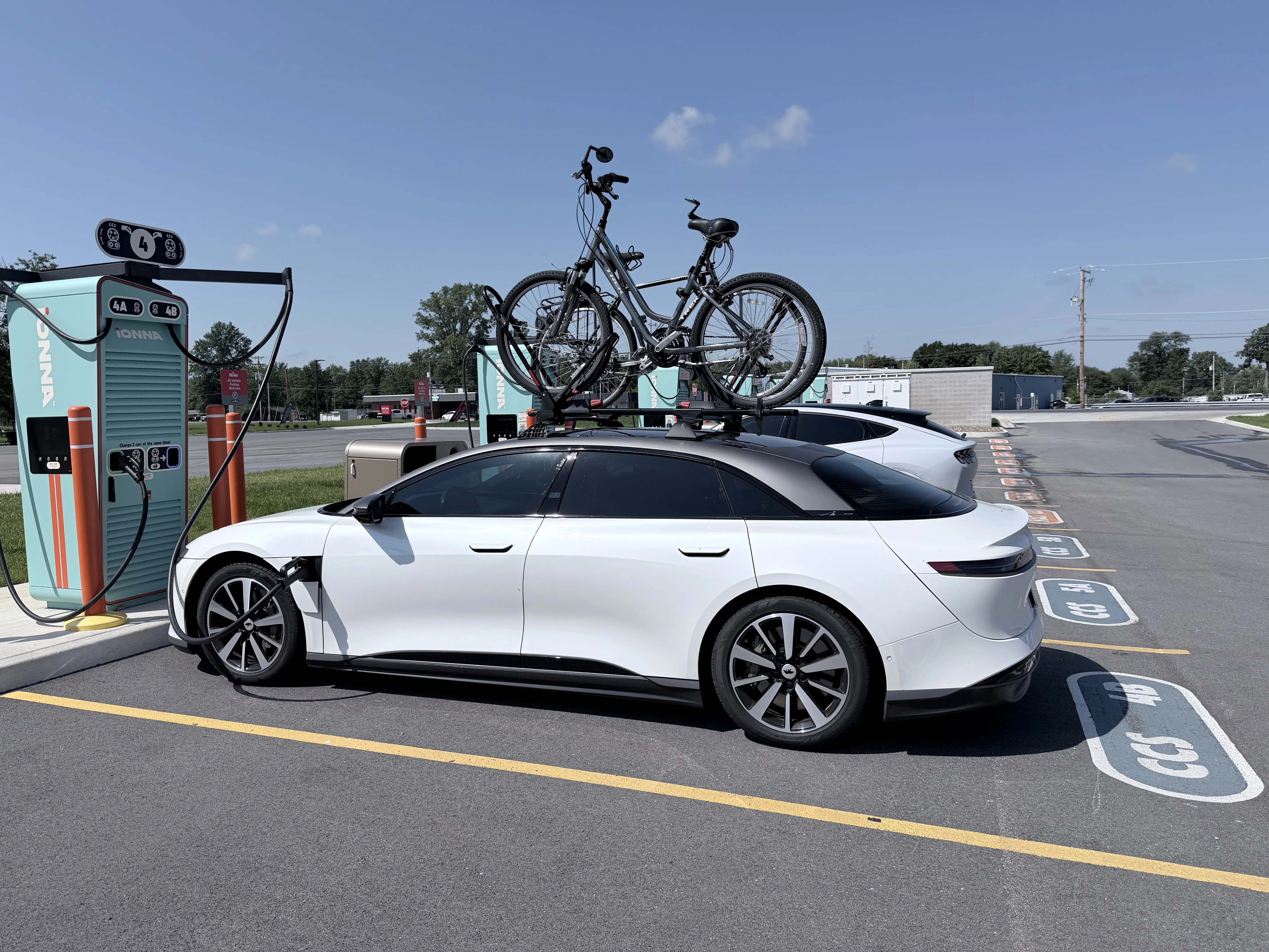

We loaded the car for the drive. We utilized both trunks and subtrunks and had two bikes mounted to the crossbars. More on that later. Just two passengers. We also had a mobile refrigerator on the back seat. It was plugged into the the outlet in the trunk. Beverages, sandwiches, salads, and other goodies for charging stops. I had taken the aero covers off several weeks ago because the 19” wheels look much better with the bear caps and black lugnut covers. I had trouble getting the the center caps off when we were loading the car, so I said “eff it” and just tossed the aero covers in the frunk and said “let’s just get on the road”. MISTAKE!!
I had been driving the car around town for a few days with two bikes mounted on the crossbars just to get a feel for any changes in driving dynamics, gaining confidence in the amount or lack of shake and wobble when going over bumpy surfaces and around curves and such. I noticed what I perceived to be minor and very much expected reduction in energy efficiency. The bikes clearly affected aero, but it didn’t seem to be that much. BIGGER MISTAKE.
When I made a roundtrip Buffalo - NYC with four people and luggage a few months ago, I averaged somewhere around 3.7 miles/kWh. No bikes. No crossbars. Aero covers on. Was thinking with the bikes and crossbars and no aero covers, but only two people, maybe I’d get around 3.3 - 3.5. WRONG!!!
First leg of the trip scored 2.5 mi/kWh. Super disappointing. So I grabbed a screwdriver and popped the bear center caps off while it was charging and put the aero covers on. Got 2.7 mi/kWh for the second leg of the trip. Not great, but better than 2.5.

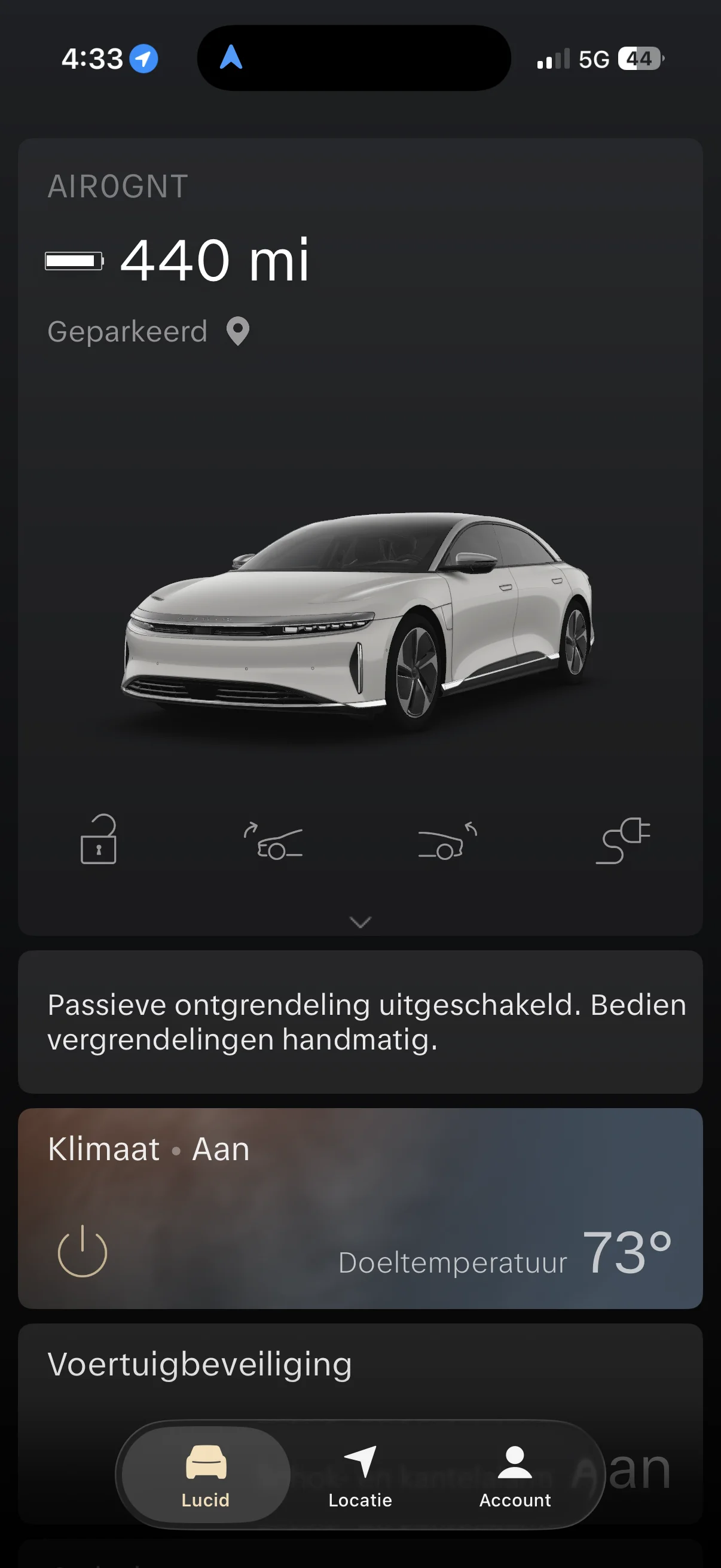

Somewhere along the line, my app decided that it really wanted to learn a new language. So now it displays in what I believe to be Dutch. Maybe even Afrikaner. Don’t know when, why, or how it happened. Don’t know how to change it back to English. Parked the question with Customer Service. Crickets. Anybody want to take a swing at cause / remedy for me? I’m all ears.
For the time being I have to look at the app on my wife’s phone to decipher messages. Hers is still in English.

Those bikes will have a tremendous impact on aero and higher speeds will exacerbate it. You noticed a decrease around town as you got familiar with them on the car, but when you get to highway speeds, forget about it. It's going to be far worse and eat up that range. Just the price to pay for doing that and you accept it and plan for more frequent stops. As others have said, always use your battery percentage and not the mileage estimate for the range. I do that in ALL EVs. That number is an estimate that can drastically change super fast. The percentage will let you know when you need to stop. Plan to stop between 10% - 20% and you'll never have to worry about range (also have a backup location planned in case something goes wrong with the charger you are stopping at). Lastly, download PlugShare if you haven't, to give you more tools to locate chargers. Most major highways now have fairly good coverage every 50 miles or so for a fast charger. Maybe there were more that ABRP wasn't aware of? I don't use it too much.
Language issue has to be your phone - I bet it somehow glitched and changed the language in your settings on the phone.
Yep, sounds like a VPN turned on on his phone perhaps? Not sure that would change the Lucid app...
Everything else in my phone is in English. The same phone is PAAK to our Tesla. English. I also have MyChevrolet app on my phone. English.
No VPN on this phone. Ever. Not since I've owned it. iPhone 17.

I think that would have been helpful had I not had a big airdrag on the top of the car. The bikes really screwed up the aero big time.
