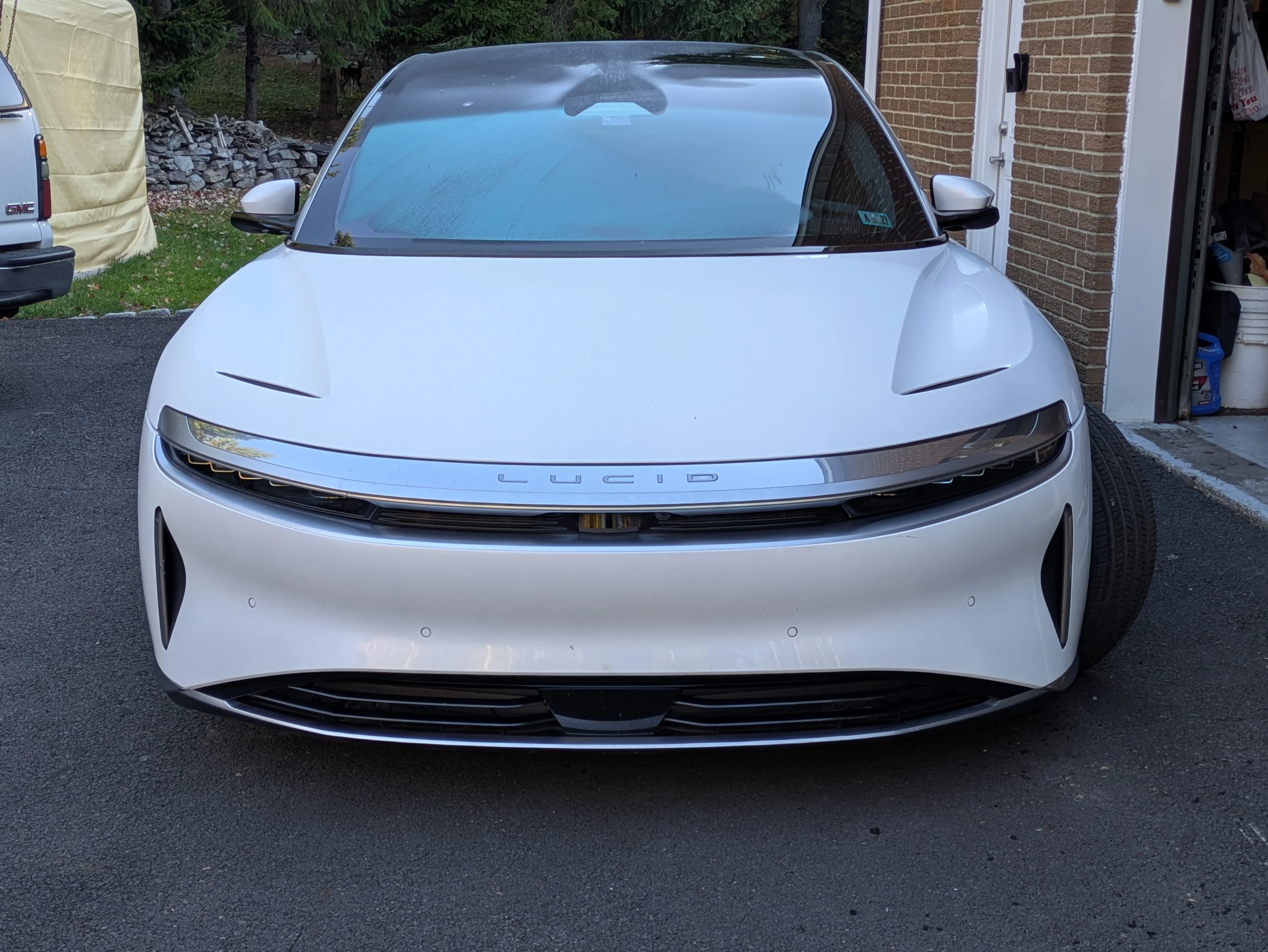

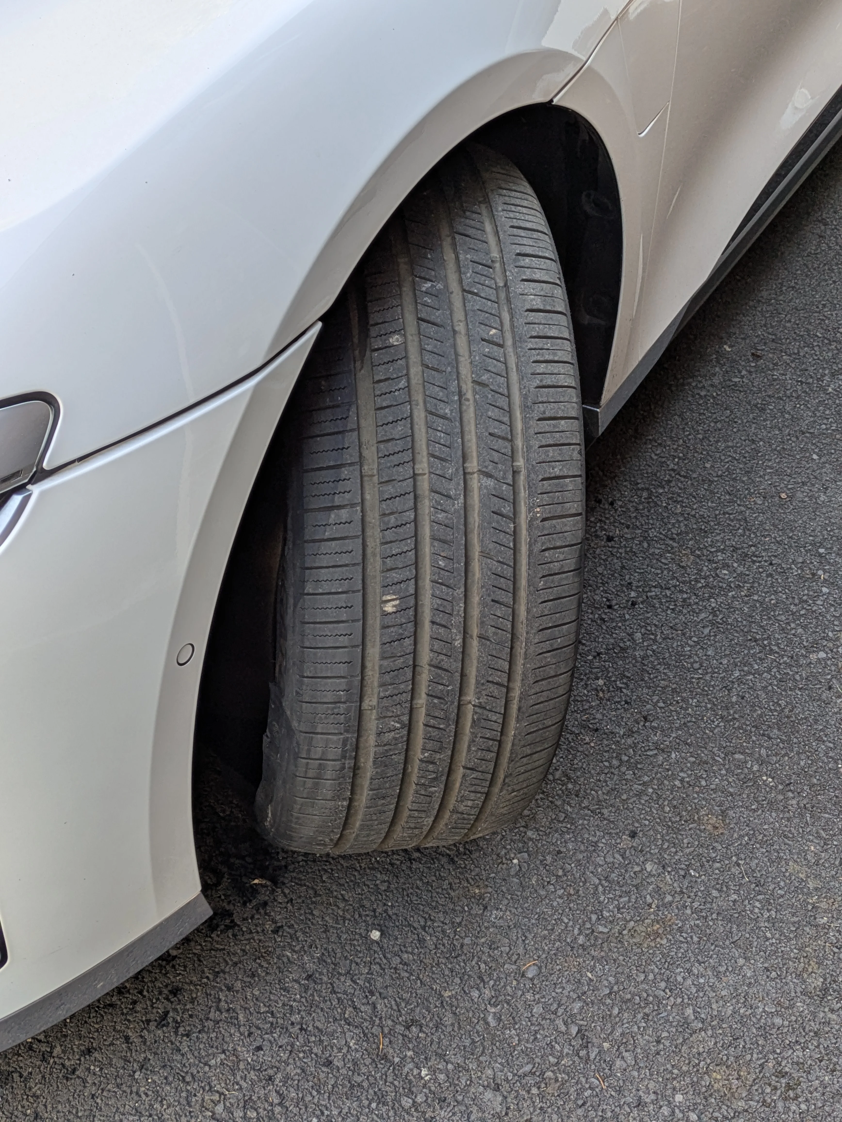

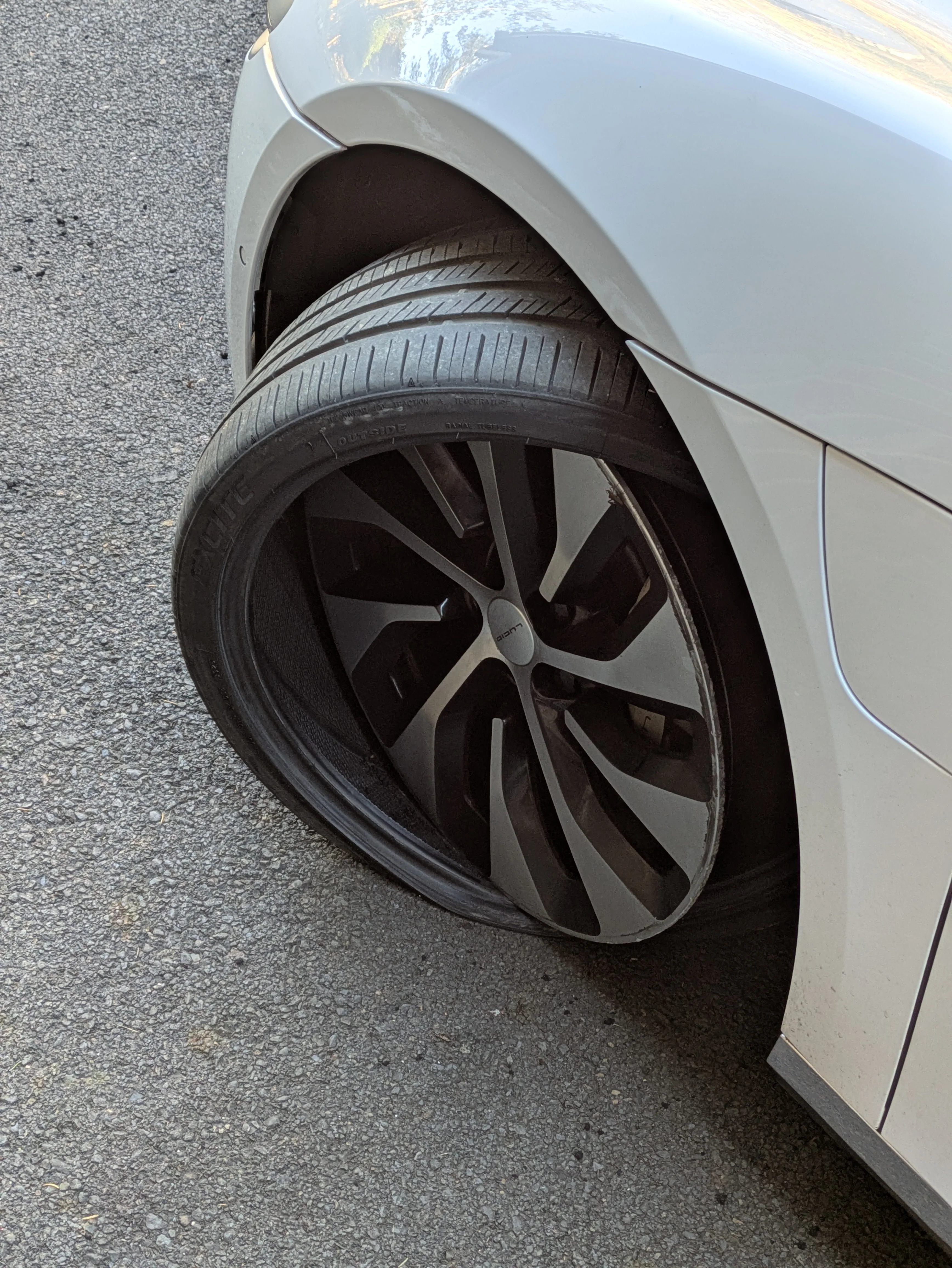

I blew my driver's front tire out on my '23 AT a mile from home and destroyed the rim and rubber getting it the rest of the way. I can own that. I already have a remanufactured rim with a new tire (and the old, still ok TPMS on it) ready to go. I just don't know how to lift this thing to change the tire. I'm deathly afraid of messing up the car in some way, especially the brand new battery that was just replaced. I believe I have a jack heavy duty enough to lift it the few inches I need, but doing it myself is concerning. Any suggestions? Can I call Lucid service to come do it? And if yes, is there a charge? I don't think I should trust just any service guy that my insurance sends. A guy showed up with a flatbed to tow it, but the front is too low to the ground, and he didn't want to take any chances. He mentioned calling a "wrecker with dollies," which my insurance can send, but even if that would work, I don't know if I should go through the whole trouble of towing it when I already have a new tire/rim ready to mount. Help!

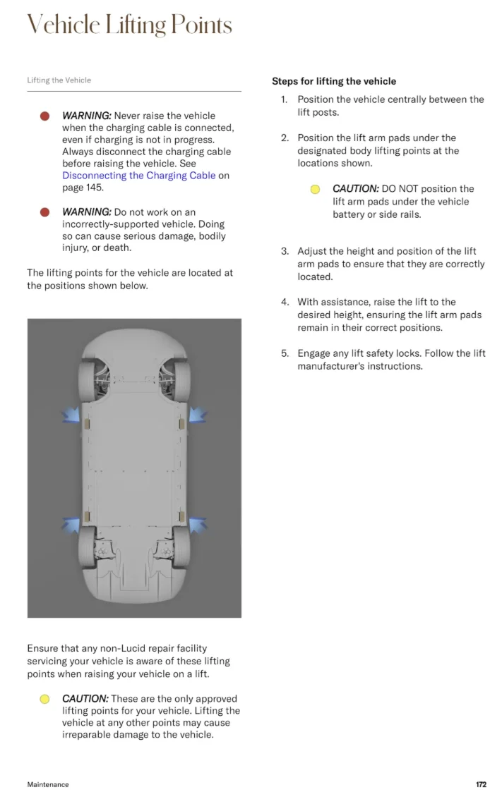

This thread showcased a similar scenario:

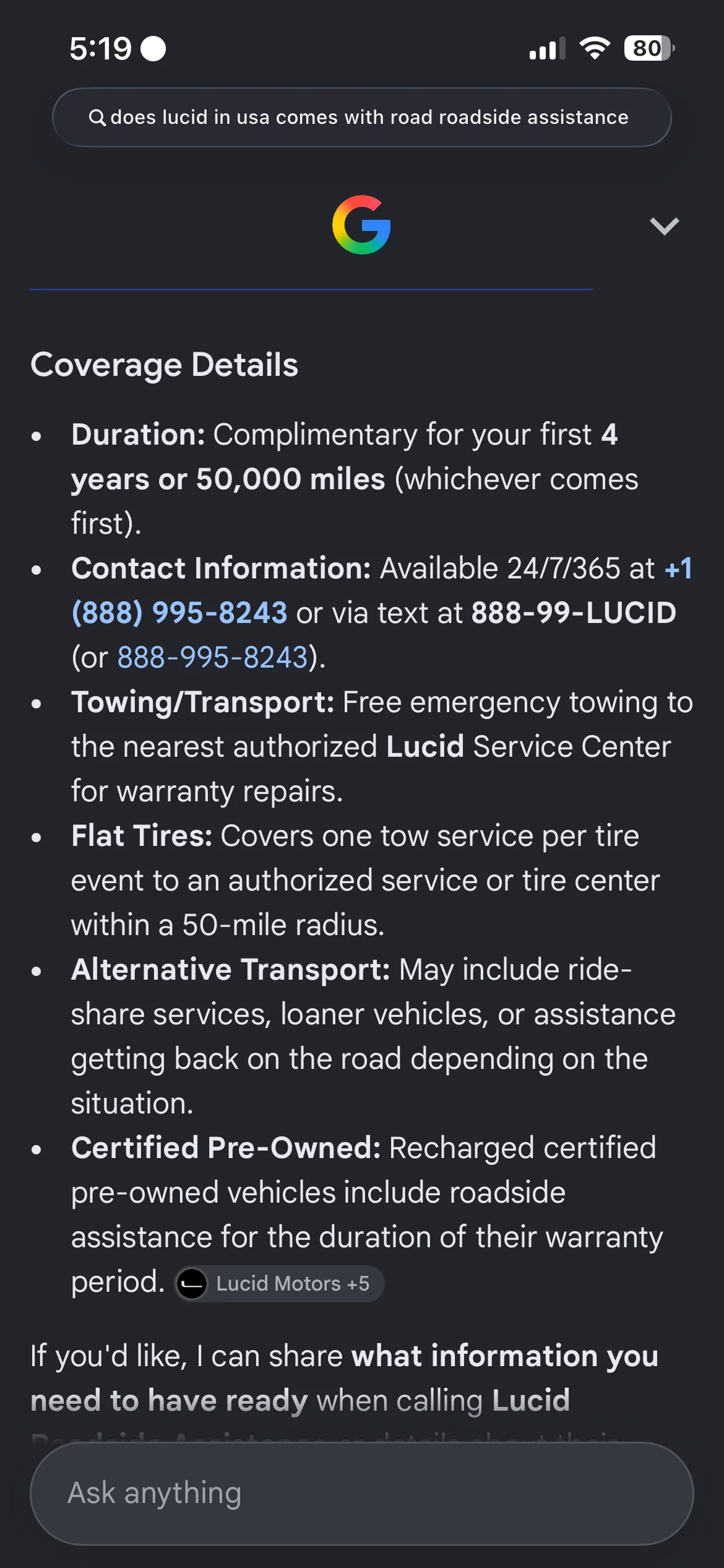

as far as I know any new car comes with road assistance service !
Isn’t it the same case in USA ?
In fact, if you run out of battery in Saudi, they will tow your car for free
I would definitely call Lucid
Thanks so much. I called them, but they won't just take the bad one off and put the new one on for me where the car is. They'll only tow it to a local mechanic. That's too involved for me, and my mechanic isn't open on the weekends (tomorrow's Saturday). Since I'm not on the side of the road, and it's in my driveway, I think I'll just use a floor jack and a puck to switch them myself.

Thanks! I'll get a lifting puck and give it a shot.

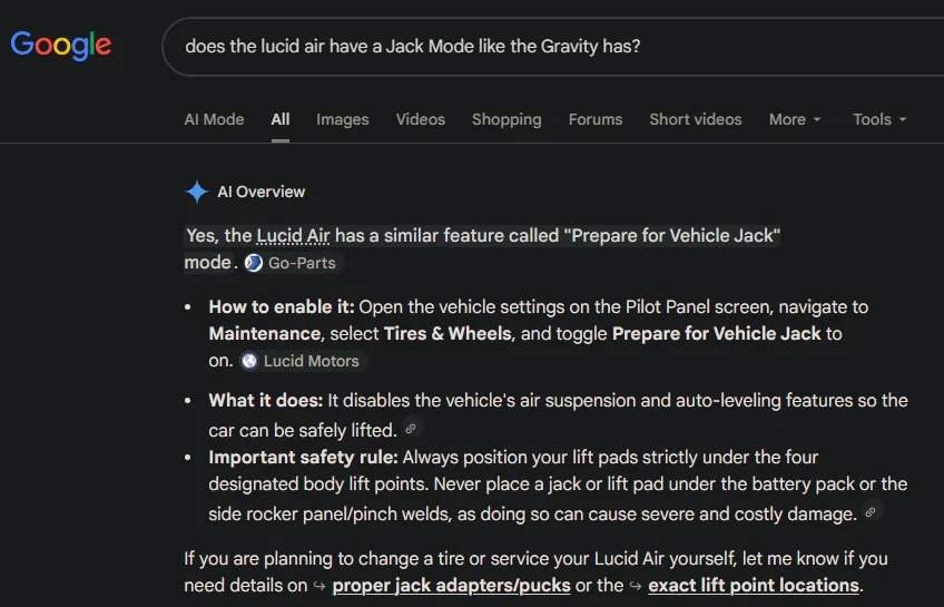

From what I can see and am told, the Air also has the Prepare for Vehicle Jack Mode. And it seems that it's also prudent to disable the Shock & Tilt sensor.
I've never heard of such a thing, and it isn't in the manual. But let us know if you find it. Not sure what the Air would even need to "prepare"; it has a traditional suspension.
